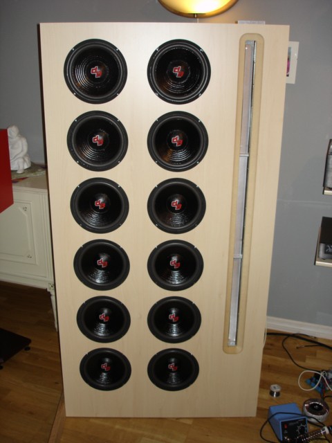

HI guys!
You can can look att the swedish diy forum artikel!
In swedish, but you can look at some butiful pictures.
http://www.hififorum.nu/artiklar/Dahlbergsband/del1/Dahlbergsband.htm
My ribbon is 112cm.
It play down to 400hz.
If i play fullrange with just the ribbon and no crossover i can hear bass but wery low level.
Crossover frekvens is 400hz.

Mx said:
Thanx... a very well documented project.
(Some of the links to big images on Page 2 are broken -- most seem to go off site (ie http://www2.hififorum.nu/artiklar/dahlbergsband/del2/bilder/laminat0013.jpg))
dave
Yes, very well written and very well made speakers.

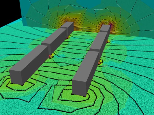

I have just downloaded Femm, and first thing i must ask you guys with more experience, is can we simulate this 3d problem in Femm? I am very interested in claims that this magnet arrangement is better (gives more uniform and stronger magnetic field) so i would like to measure that.
And how can i measure magnetic field in reality, on those Apogee speakers?
Femm will only do 2d simulations. What I have done is to model my ribbon with femm once from the face-on direction and then from the top down direction. This works well to refine your design but I'm not sure either way will give you an exact simulation of a single point in 3d space.
I don't know if there is any way to measure the large field strengths with anything approaching consumer cost equipment. If there is, I've not found it.
Thanks Dhenryp. Then it will be matter of trial and error.
FEMM is, I believe, very accurate if the missing dimension is "repeated". In other words, say we're modelling a line array. If the FEMM slice we use is perpendicular to the long axis, and also there are no variations along the missing dimension, it should be fine. There will only be a small difference at either end of the line. The FEMM examples show a simulation of a conventional speaker: this works because the missing dimension is simply rotated around the center.
In J. Verhagen's excellent book he measured a Raven (or was it a Cantus driver?) using a hall-effect sensor and found that it agreed very closely with the FEMM model.
Unfortunately, dhenryp's ribbon design does not seem to meet these simple criteria, which makes it harder (because he has cross pieces offset along the vertical). So, in this case, I guess, FEMM is producing inaccurate results, perhaps.
fortitudine - I didn't think measurement would be hard because of my design, I just assumed that it would be hard for consumer devices to measure the high field strengths involved. I've not read the book you referenced, but it seams that I was wrong in my assumption. My crosspieces are nothing very unusual, they just provide for a path to complete the magnetic circuit.

Because i will build classic magnet arrangement ribbon speaker (without cross pieces), it really makes it easier to simulate in femm, like Fortitudine said. Only problem are places between magnets (small gaps), i can't simulate that in femm (in 2d), but i assume that it doesn't affect much magnetic field (and distortion of speaker) because ribbon is much longer in places between magnets.

Your picture is neat - what software did you use to build it?
It would be best to eliminate the spaces between adjacent magnets. Aside from the cost of the extra magnets there is no technical reason why you can't do this. I would also suggest reconsider using crossbars. Completing the magnetic circuit with cross bars will increase the field strength in the gap significantly (I can't remember the number now but I thing it's something like a 40% increase).
