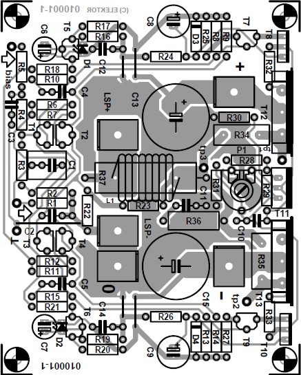

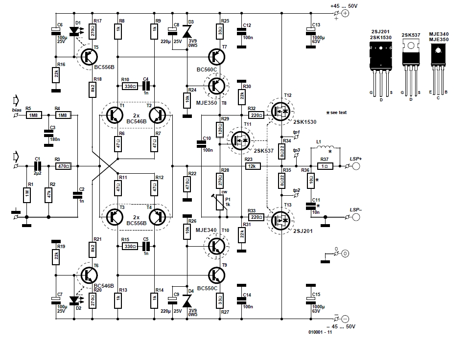

With some advices found on this forum I find a way to solve my problem.
the value of resistor R28 was wrong. I used R28 = 2K instead and I finally managed to have 0.044V between tp1 and tp 3

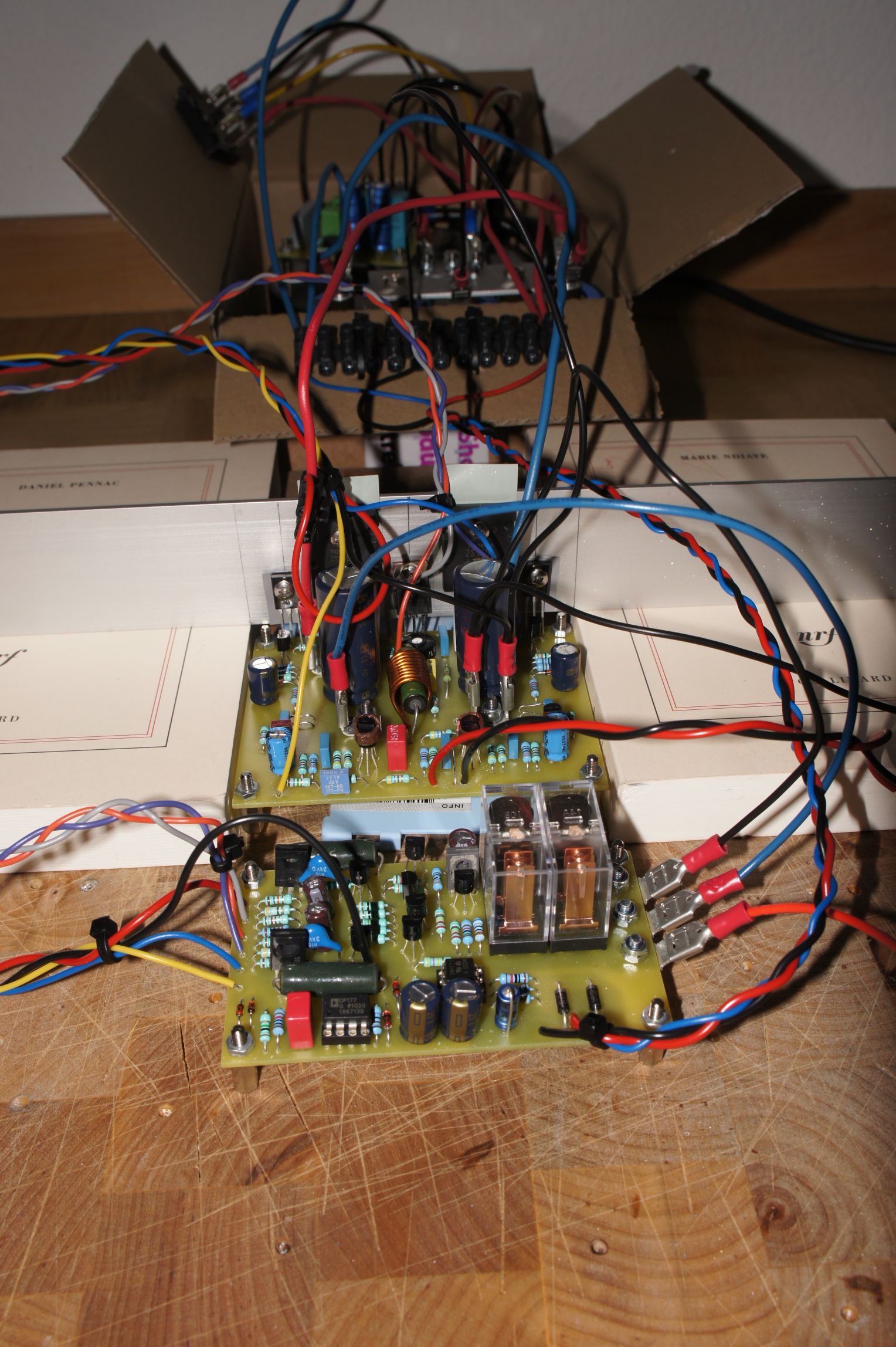

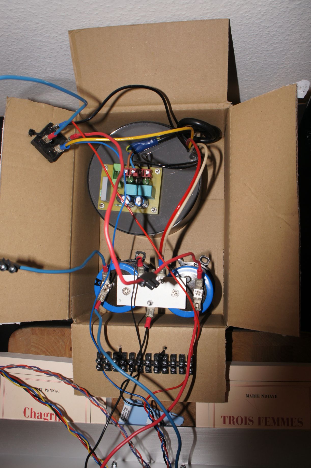

Here are some pictures of my finished amplifier.
