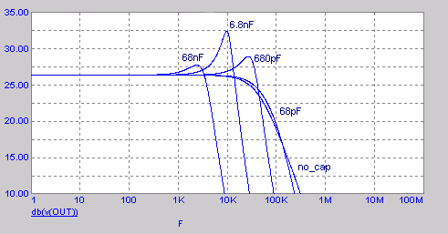

OK, writing the original post I had the intention to put that question by myself, because I am not sure about this. Explained as you have explained, the thing should look the same with different opamps, just having bigger peak with the higher bandwidth opamp. In fact it doesn’t look exactly that way. LM1875 (shown previously) is 5MHz unity gain opamp. OPA2604 (first diagram here; take note that Y scale is 40dB now, was 30dB) is 20MHz (take note also that the frequency of the peak is somewhat lower that in the case of LM1875). AD825 (40MHz, the second diagram) doesn’t have any peak, and LM6172 (third diagram) which is topologically a CFB with buffered negative input is 100MHz and has a nice roll-off, almost as we would like to have and not to use the buffer.

Pedja,
Resonance is the periodic exchange of energy between an inductive and a capacitive part. That is not the case here at all. There is no resonance anywhere here. The peak in the response comes from an increase in gain as the feedback factor diminishes at higher frequencies.
[/B]
Hi, Jan
From somewhere :"Ringing and overshoot are the first signs of instability, and oscillation is the final sign, ..... "
There is no discrete reactive elements around, but something is ringing, like bells...... ;)
This Pedja's picture show some resonance..IMHO
I saw this on my scope today too (network 10k-6n8-680R-220kFB)
Overshoot was on ca 23kHz with only 2dB (LM3875)

moamps said:
Hi, Jan
Regards
A peak in the response? A resonance? A bit of both? I notice the undershoot after the peak, that looks like the start of an oscillation? Horror! Quickly damped though, so still looks stable. Nice screen shots.

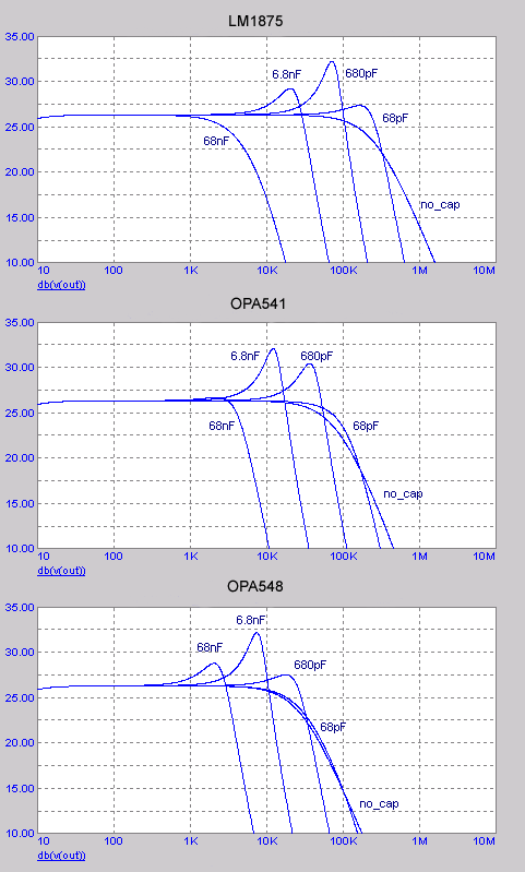

Pedja said:
Did you?
Pedja
Without promoting too much further discussion, these screen shots got me thinking. So I quickly did simulate in CircuitMaker using an ideal IC and transposed 10K and 680R. I measured the RMS voltage @ 1KHz and 20Khz, before and after swapping 10K and 680R. They were identical. So in theory, using an ideal IC, but theory and practice are different things.
Ergo, the LM18xx is not an ideal IC. Surprise, Surprise!
So I would go along with your screen shots.
Joe R.
Hi Joe,
I checked a few chips more using the same circuit and haven’t had success. It is shown behavior of chips without the shunt cap and with 68pF, 680pF, 6.8nF and 68nF caps.
Note that the OPA chips (having shorter bandwidth) set to gain of 20 anyway have roll-off inside the audio band.
Pedja
