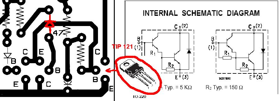

about this:
http://www3.telus.net/chemelec/Projects/Misc-PCB/M-250-DC-Protect.png
i have 2 questions:
1. the diode, is this how you put it, or it was the other way..???
2. TIP121, it's footprint is not CBE, but BCE....,so please change the pcb, to include that...(you could leave it as it is, but it is very dificult to put it in corect position...)
(i thing you will better understand what am i saying in the picture below...)
(i can't write in english , i cand read, ant talk, but i can't write, so,please exscuse my mistakes...)
no, it Shouldn't....
and, yes, now it's corect...
