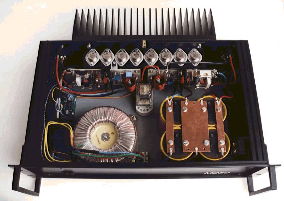

Another amp

hi quasi
without your permission i modified your nmos200 pcb to suit my needs
i will be using this pcb for nmos350 please comment on this pcb
and also please suggest a matchiing pre amplifier based on opamps
i have already made nmos200
thanks for the lovely amp
with best regards
  • nmos too 247 mod.lay].pdf
