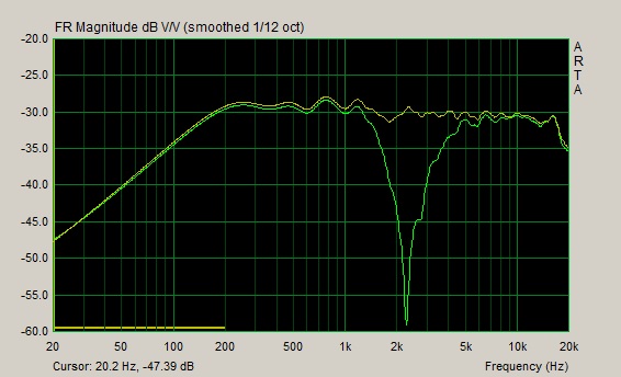

Looking forward to your crossover schematics and posts. If using SpeakerWorkshop, and ARTA for measurements... does ARTA measure actual phase? or generate from the FR using an HBT (extract minimum phase)? If the latter - remember to include driver offset in the crossover in speakerworkshop. If actual measured phase is used - all speakers are at zero offset. I find using both is a good way to cross check measurements and crossover modeling.

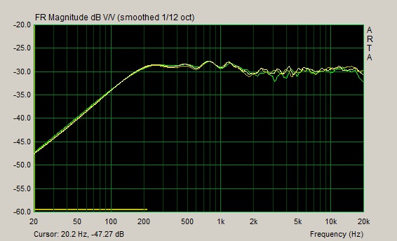

Your woodworking skills are very impressive and the finished look is fabulous. I especially like the way you profiled the rear of the baffle to give maximum breathing for the woofer.
I wouldn't worry about the 2KHz bump my guess would be that this is a slight diffraction from the woofer surround as 2KHz is a wavelength of around 170mm and this is about the size of your woofer.

I had time today to perform some measurement, showing them in the next post.

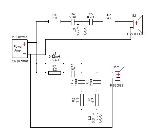

Crossover and final measurements

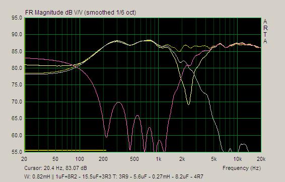

After a lot of simulations, measurements and listening time this is the crossover I’m using:
It is basically a LR4 design with asymmetrical slopes in order to compensate for the different acoustic centers. Electrically this is accomplished with a 2nd order network on the woofer and a 3rd one on the tweeter. On the woofer side there is also a notch for the breakup that helps also to reach the target slope (C1+R1), and a notch to flatten the midrange bump between 500 and 1000 Hz (L2+R3+C3, DCR of L2 is 1R7, if different change accordingly R3). On the tweeter side the two resistors R4 and R5 provide the attenuation needed.
In the end I went for a crossover point at around 2400 Hz, a bit higher than I wanted, but couldn’t lower it without having a worse FR. I finalized the crossover with Speaker Workshop, but I now switched to XSim as it is much faster. I used the measurement done with Arta, calculated minimum phase and inserted the appropriate delay between the drivers. I found a measurement of the speaker I did when I finalized the crossover, showing the on-axis FR (drivers alone, combined response and reverse null):

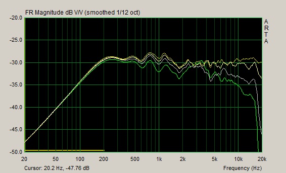

Today I performed some additional off-axis measurements, something that I only partly did in the past, just to understand if I were on the right track. First there is an image of the vertical off-axis FR, mic pointed at horizontal middle of the speaker, 0, 5 and 10 degree under the tweeter height. Green is 10 degree, the other 2 measurement are too close each other. At home the tweeter height is not below the listening height.
Next there is an image showing the horizontal off-axis FR, 0, 15, 30 and 45 degree (note, different scale as the previous image). It was the first time I did the 45 degree measurement, and this clearly shows that a lower crossover point could have probably helped in obtaining a better power response.
I’m showing also the 15 degree horizontal off-axis FR alone, with its reverse null. This shows that the sweet spot is fairly large horizontally, and the speakers can be positioned flat or only slightly toed-in.

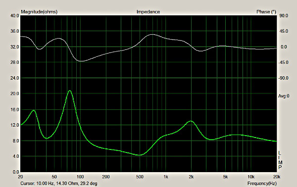

Last the measured impedance, a relatively easy load. The tuning shown here is a bit lower than what I’m using now, 40 vs 42Hz.

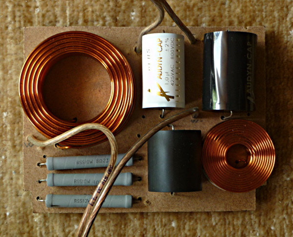

I built and tweaked the test crossover using cheap components. This should not be a problem with resistors and coils, but with caps cheap means electrolytic, but an electrolytic cap has definitely a higher ESR in respect to a film one (at least for small capacitance values, until some uF). So when I built the then final crossover simply changing component types (MOX for ceramic resistors, film for electrolytic caps, air core for cored coils), my crossover was slightly off, so I had to re-tune it. Moral of the story: if you want to test a crossover with cheap components before buying the final ones buy a set of cheap film caps instead of electrolytics up to 10uF. Over 10uF the difference in ESR between the two cap types should be negligible.
This is how I built the crossover. The components are glued to a 5/6mm thick MDF panel, and are soldered on the rear. The panel has small 1.5cm square feet made again with 5/6mm MDF that provide the needed clearance for the wires under the panel. The crossover board is secured into place using small pieces of blue tack under the feet so it can be easily removed and restored. A photo of the woofer board:
