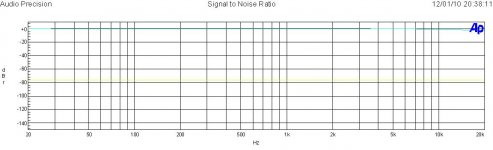

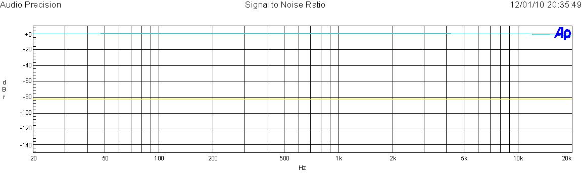

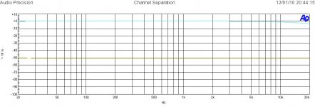

I ran some AP tests the other night and will post the results.

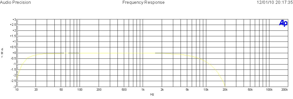

In the meantime, the frequency response is flat from 7Hz~22.5kHz (-3dB points)

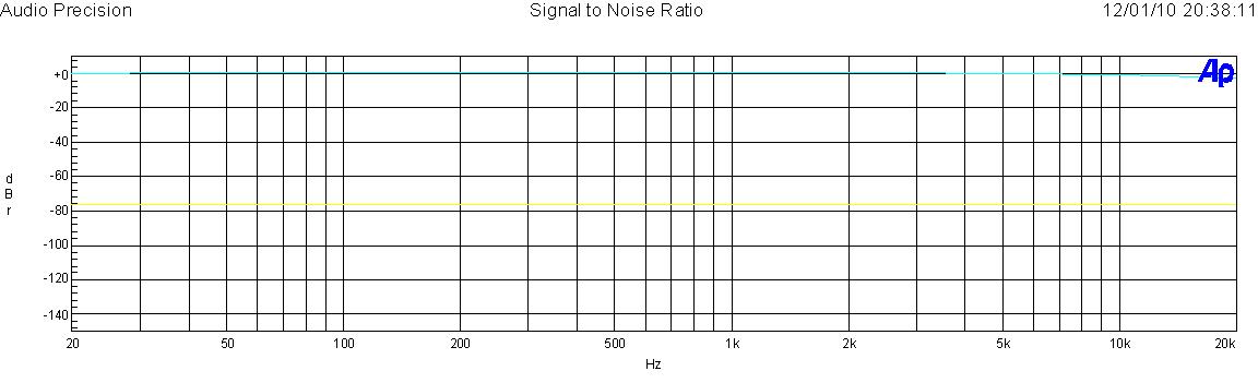

Signal to Noise @ 1kHz - 93dB (A-weighted)

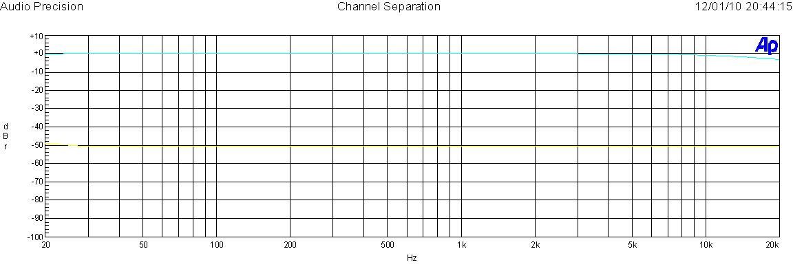

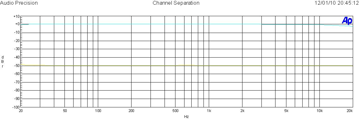

Channel Separation @ 1kHz - 65dB
No particular reason for using 2.5k for the 2A3 load impedance. I wanted to try some of the Edcor SE transformers and this is what I selected as an experiment. Of course anything from 2.5k~5k can be easily used for the 2A3 with good results.
I have not measured the OPT primary or secondary resistances yet. Will have to do just so I know.

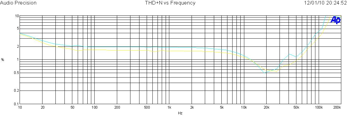

Here are a few AP graphs.
The Signal to Noise and Channel Separation are lower than previously quoted... I had quoted test figures from another 2A3 amp I was measuring last night.
Even though the SNR and Channel Separation are not great, the amp still sounds good. The Chinese 2A3B tubes I have are still somewhat new. Hopefully, in time, the distortion will improve at low levels.
My best Chinese 2A3 tubes are on loan to a friend right now. They measure about 0.3% THD+N at 1 Watt.
I apologize for the "hard to see" graph colors. When converted from .bmp to .jpg there is a loss of resolution.

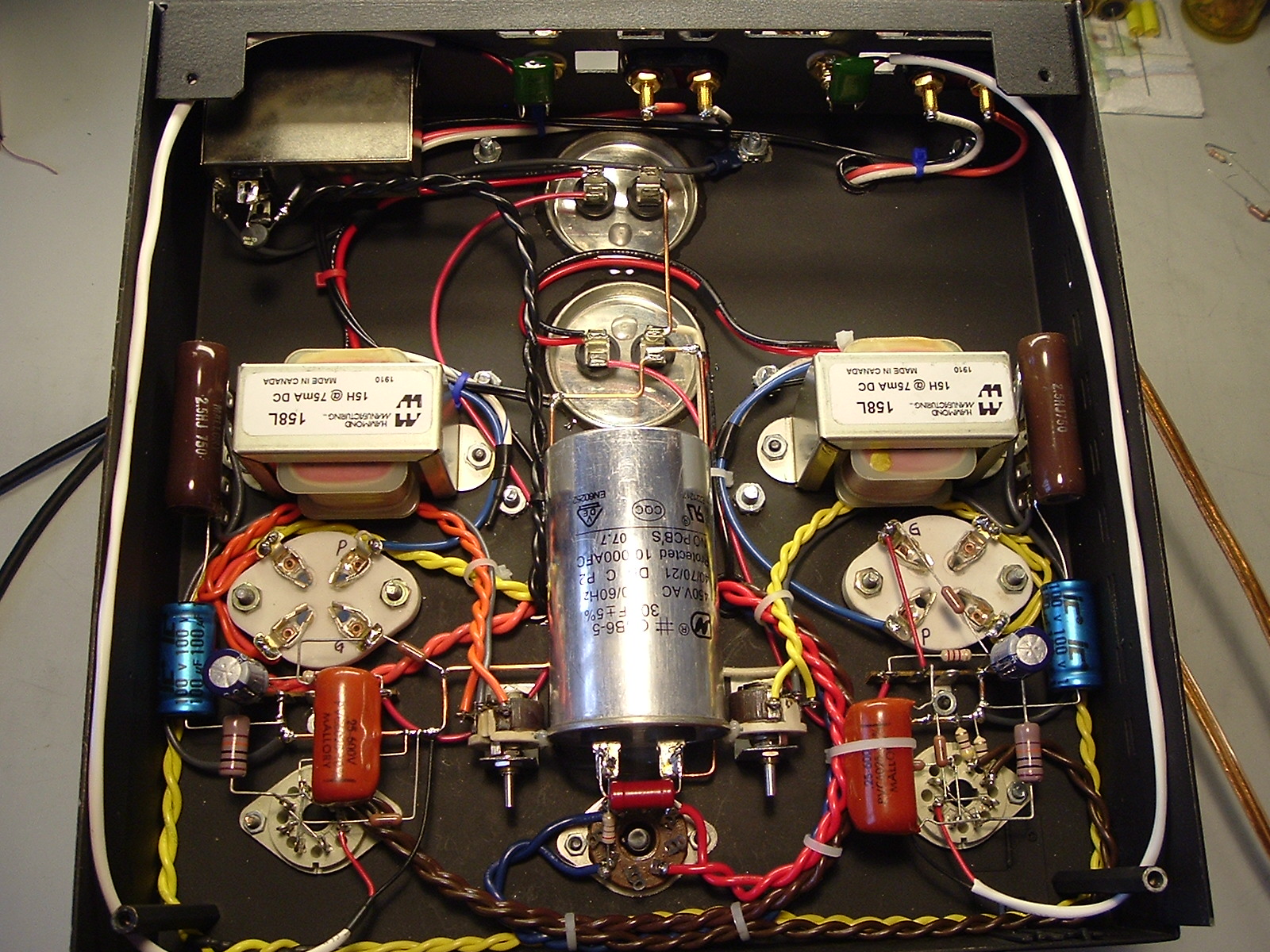

hey, I have had tube amps in the past, but Im new to tube building
even if very little, is small amounts of hum something you just have to accept :confused:
when looking at layout, is it optimal to have signal wire running on both sides ?
wouldnt it be better to have them close together, on one side of amp ?
or maybe it doesnt matter ?
When using AC on 2A3 filaments, you have to accept a small amount of hum.
The input signal wiring can be run down the same side or separate as in my picture. If run side by side, use a good shielded cable to minimize channel interaction.
