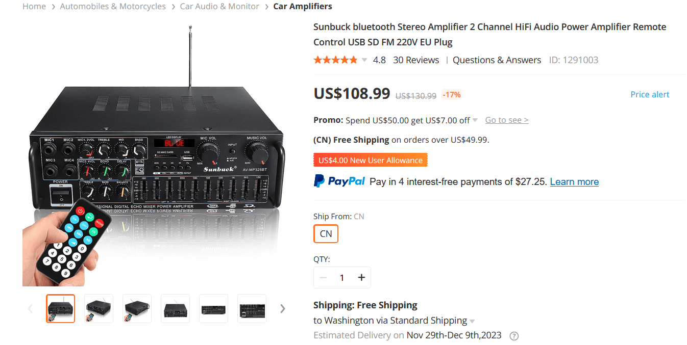

I bought one of these at our local "Value Village" on 30% off Tuesday, it was marked $13.99
220 only, but what intrigued me was the 12V input on the back. It ran on 110, but was louder at the same settings using the 12V input - even with a weak, not quite 12V battery. I opened it up and removed the 220 / 18-0-18 torroidal power transformer to save weight. Figuring it would be some class D job with all surface mount, I was surprised to find 4 discrete output transistors each with a big leaded emitter resistor. I also believe it actually has a switching converter to convert 12 to +/- 18. They even bothered to protect it with a diode, should someone mix up red and black.
No statement of power output in the manual, but in the ad I photocropped above, it says 1200W / ch. ;') Another one of these "Magic" devices like George's floodlight, it outputs 2400W with only a 5A rating on the 12V input.
As much work as the fellas in China put into this (they provided a discrete cement filled plastic foundation for the power tranny, I assume to reduce hum) I wish they'd spec things better. There's a whole table of 'em, but nothing useful like the actual power output - and, the voltage range on that 12V input. I'd like to know if it could tolerate 4 18650 batteries at full charge, ~17V. I suppose I could open it up again and see if any electrolytic cap across the 12V is 16V...

It is common here, FM module with SD Card / USB inputs, and the most common chip used is the 4440, about 15W/channel from Chinese chips, and a 0-12 supply, 7805 to drive the module.
A connection to the rectifier for outside 12V, the only thing that would worry me is the 17V may be too much for the 7805, so the $1.50 module would be damaged.
It is used by many vehicles, like trucks and buses, even tractors (!) for music...
And a new use is to stream the sound from cell phone, and watch the show on phone, people do that with kids on long trips...use phone as internet device for music as well.
A series of these are available, progressing with 2030 chips, then STK 4141, 5200/1943, 'Mosfet' (80N80) and upwards, most amps have the module now, you can also use Bluetooth...
Starts about US$10 here for the lowest powered one, and my car has a 12V only version, $5.00...and it has a big diode in series to prevent wrong polarity inside.
