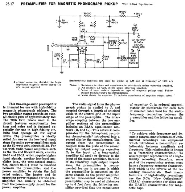

Well, I think the marantz 7 and similar products fom MacIntosh, are ambitios and overly complex. Tone controls? How 1970's! But hey, with your Ham background, (I used to be WN7TTS), wecome to the club, enjoy the quest! As Eli may point out, a great place to start with a phono stage is the vererable RCA stage from the back of the tube manual. Best of luck!!
If modified, the RCA setup gets the job done. I've uploaded both the original and the tweaked version. The tweaks dispose of 2 weaknesses in the original: wretched drive capability and mediocre bass extension. A few MM carts. and step up trafos (SUTs) interact badly with 'X7 Miller capacitance, but most are just fine.
Contact member Jeff Yourison for his build experience and a nice schematic of a low cost/good performing PSU.
That 1st $200 might get the phono section done. ;)
BTW, Mr. Brown's lack of regard for tone controls is not misplaced. Very few recordings benefit from their presence. "Correct" implementation of tone controls is NOT simple. For starters, they need to be completely removable from the signal path.
