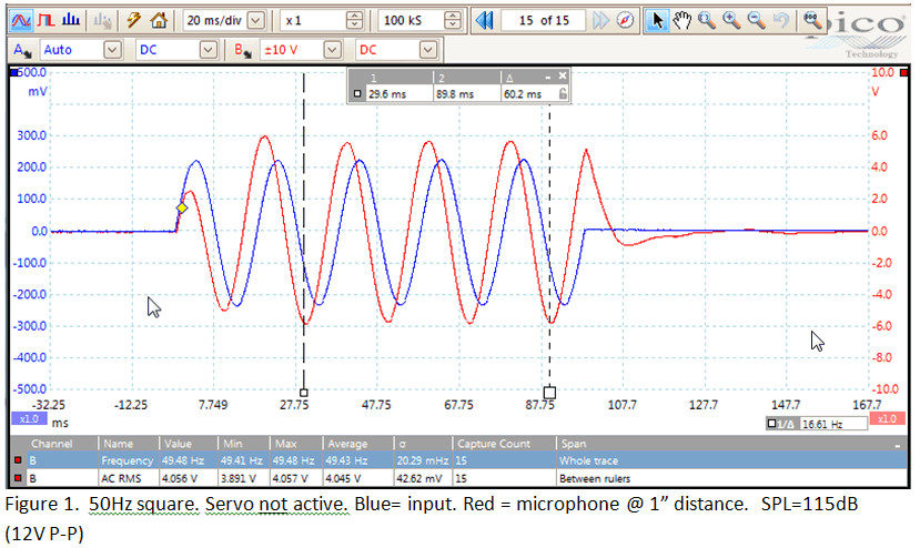

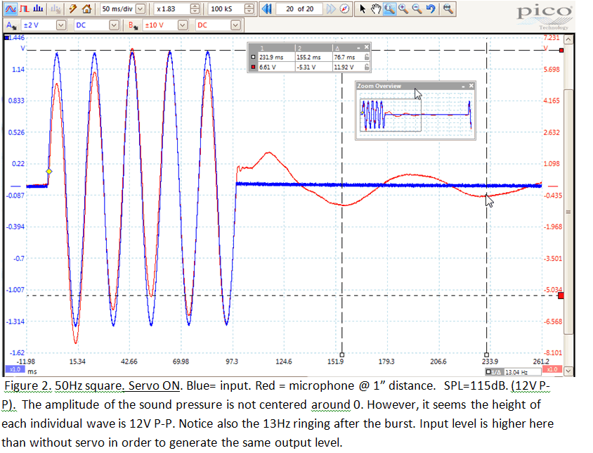

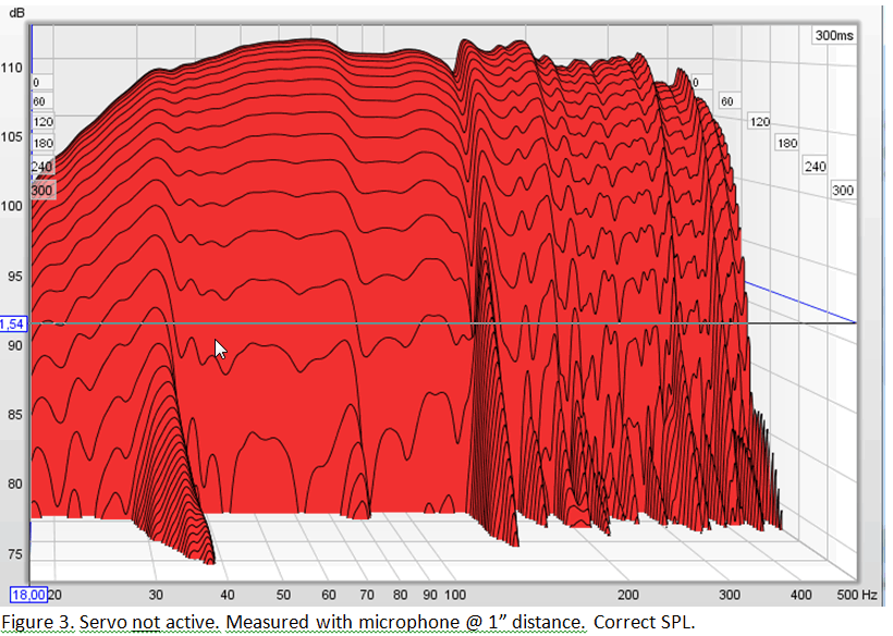

Square tone bursts as ordered:
Figure 1.
Figure 2.

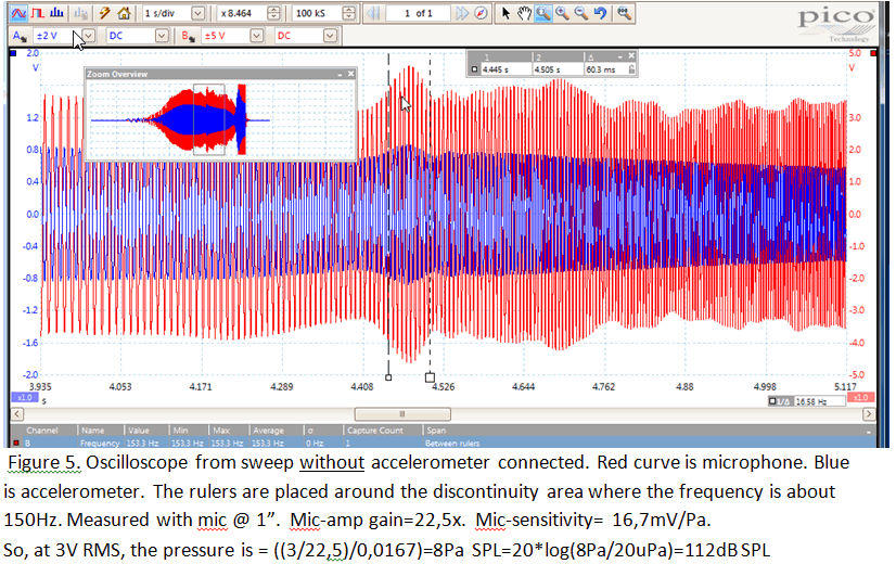

Just eyeballing the mic results for a square wave whose freq is chosen to sit inside a "times 10" and "divided by 10" woofing band can be very informative, with and without MF. Guess that's what I'd think is the best picture you could give us, even better than a tone burst*.
I don’t understand what this means. Please explain and I'll do the test.
*Waterfall

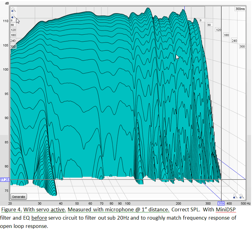

Figure 3.
Figure 4.

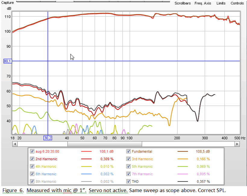

454Casull:
To lower distortion further, more loop gain will help. I can see better and better THD figures all the way up to where oscillation starts.
CharlieLaub:
I am not sure why 2nd and 3rd are the way they are. I suspect it is just the microphone itself adding the 2nd. The DC offset of the LM3886 is my last worry now. It is very small compared to what I have in my servo circuit. I am considering wrapping a DC servo around the whole circuit.

* Regarding the 2nd harmonic discrepancy between the accelerometer and the microphone I did a test today. Both mics 1-2” from cone. SPL 112dB. With “brand X” mic the 2nd harmonic was 10dB higher than 3rd harmonic. With my mic the 2nd harmonic was only 1.5dB higher than 3rd harmonic. (like in post #3). I therefore suspect that the 2nd harmonic is microphone related. The woofer sits sideways.

* Yes, the discontinuity at 145Hz is there also with open loop microphone measurement.

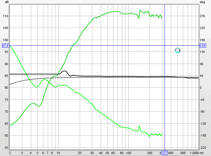

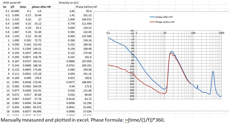

Phase from 0.1Hz to 1000Hz
I had to get to the bottom of bolserst phase question and have made manual measurements of the woofer/box phase with a scope from 0.1Hz(!) to 1kHz.
The input signal was fed directly into the DC coupled LM3886 from the soundcard.
The feedback was measured at two different places.
The red trace was measured directly at the accelerometer output and will therefore give the phase response of only the woofer/box.
The blue trace was measured after going through the accelerometer input filter (C2-R7) and op-amp (U2). It therefore also includes the phase shift from there.
Using the the scope, I manually used the scopes rulers to measure the phase difference between input and output.
Here is the result:
We can see that this is exactly like the measurement i did with REW in post #1 (Figure6)
I have also attached to this post a word document that has all the scope outputs in case you want to review my findings. The excel file with all the numbers is also attached

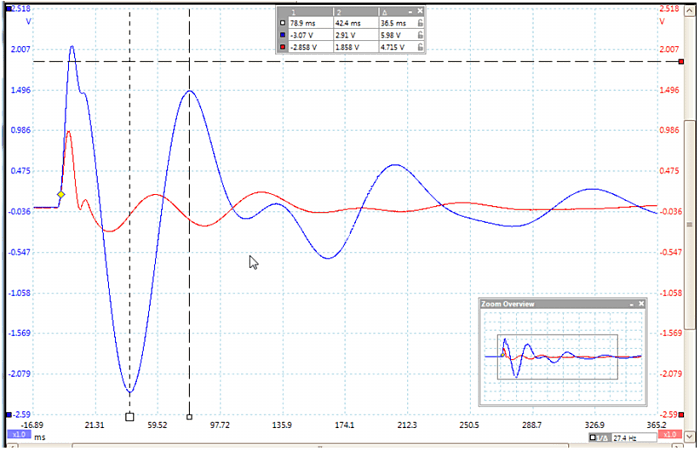

Much impressive data to digest. Great work.
As usual, I find the toneburst revealing. Clearly your MFB is giving the VC a big KICK at the start to get it moving further and a tremendous braking at the end to stop it at the zero crossing like the signal. I find that kind of MFB control more impressive than reduction in distortion (which is barely audible anyway).
But the toneburst with feedback has some troublesome features such that oscillation at the end - and there is something odd about the envelope too.
The "times 10" comment: if your amp can pass a truly good looking 200 Hz square wave, it is very well behaved between 20 and 2000 Hz - a very revealing quick test because the shape of the square reveals all kinds of things to the practiced eye.
For a woofer, there's no such wide band to work with. But a square wave at maybe 120 Hz would be interesting. Maybe.
Thanks for all the great work. Feedback around the speakers: the historic next frontier of HiFi.

Tone bursts
I have made a couple of recordings with and without servo active.
One is 50Hz square bursts ( 5 periods )
The other one is continous 120Hz square pulse.
A single 122Hz square pulse can be seen in post #2
Also, about the odd envelope of the 50Hz square burst, I have made a new test of a continous 50Hz with a square start. There we can see that the odd envelope is in fact the same 13Hz ringing we see after a burst. The amplitude of each individual period seems pretty good. I think that a 13Hz ringing will not do much harm other than limit the maximum output.

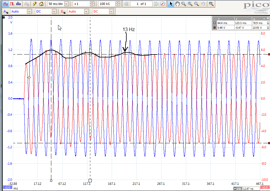

Odd Amplitude and Phase Behavior
It just dawned on me that the amplitude and phase behavior you are showing is not unlike that for a woofer when loaded by a helmoltz resonance as in a vented box, only in this case it is tuned well below the pass band. Any chance you have some small air leaks in the box, around the woofer, or perhaps you haven't glued the dust cap back on?
BTW if this is the case, make sure you turn down your open loop gain before testing with air leaks fixed in case the air leak was actually helping out your phase margin.

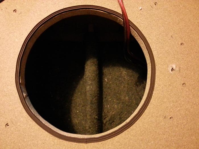

I usually pride myself of being thorough when building speaker boxes, but even the best can make mistakes ;)
I will open the box and put new silicone in all joints and check the woofer gasket. The dust cap is glued but I will examen it as well.

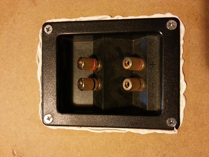

Look what you made me do bolserst ;) !!!
After sealing all joints and adding new gaskets I deliberately drilled a 10mm (0.4") hole in the box just beside the woofer and had a helper seal the hole with a finger. I made new measurements with and without finger.
Red: with finger. Green: without finger
As you can see the responses are very similar. Also remember this is a large box, so small leaks will have less effect.
I also think we can rule out errors in the soundcard. When doing manual measurements the soundcard was only generating signals and I was using a scope to make measurememts.

I didn't mean for you to attempt resealing everything, only check for leaks.

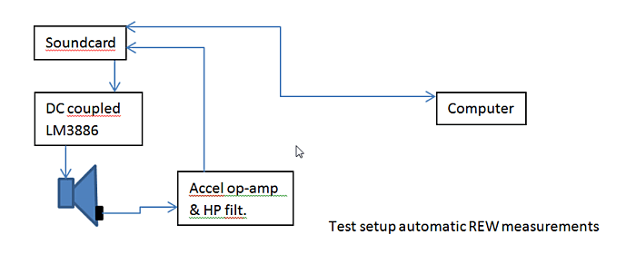

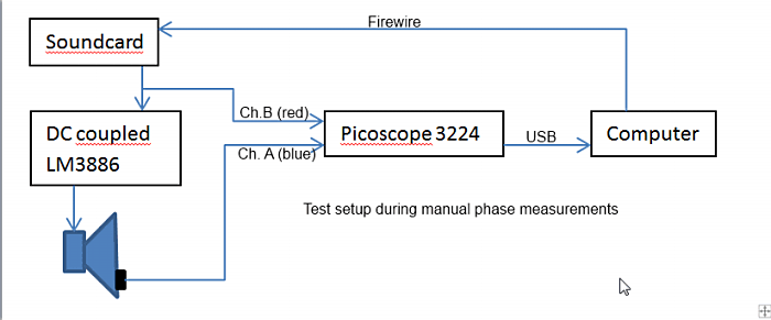

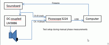

Test setup
Checking for leaks was no problem. Makes me sleep better too. :D
The picoscope 3224 is a "real" 750$ scope with real probes. Only difference is that it uses the computer as display.
This is the setup when doing manual phase measurements:
When doing automatic measurements with REW the setup is like this:
As you can see the two methods are different but they give the same result. In the manual method I could might as well used a separate audio generator but the one I have only goes down to 10Hz.

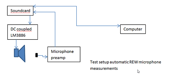

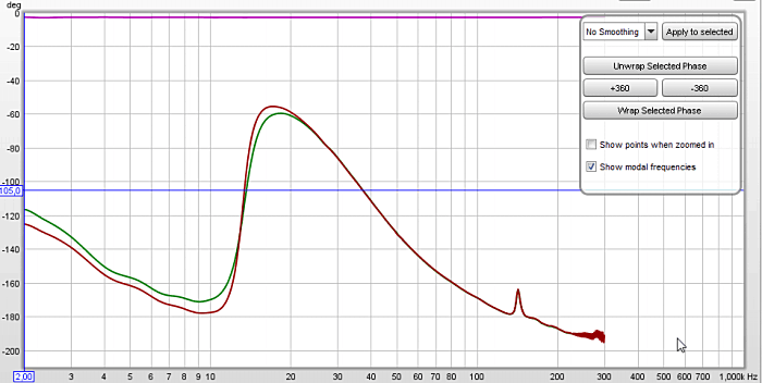

I have not attempted to do phase measurements with the mic as feedback before, so I made one today. Note that the microphone phase below 10Hz is not calibrated. Also, there is a 5Hz low pass filter in the microphone preamp
This is the result from the microphone test
It is interesting to see that the 13Hz behaviour is now gone. There is a 180 degree phase shift from 10Hz to 200Hz plus another phase shift of 180 degrees from 10Hz to DC. There is a expected phase shift from the mic preamp @ 5Hz but where does the rest of the phase come from?
Is it a phase shift in the microphone capsule?

This is the result from the microphone test. It is interesting to see that the 13Hz behaviour is now gone. There is a 180 degree phase shift from 10Hz to 200Hz plus another phase shift of 180 degrees from 10Hz to DC. There is a expected phase shift from the mic preamp @ 5Hz but where does the rest of the phase come from?
Now we are getting somewhere! :up:
The 180 degree phase shift from 200Hz to 10Hz is coming from the 2nd order high pass response of the woofer.
This is exactly what I was looking for back in post #10.

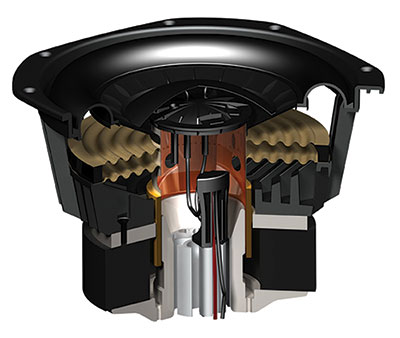

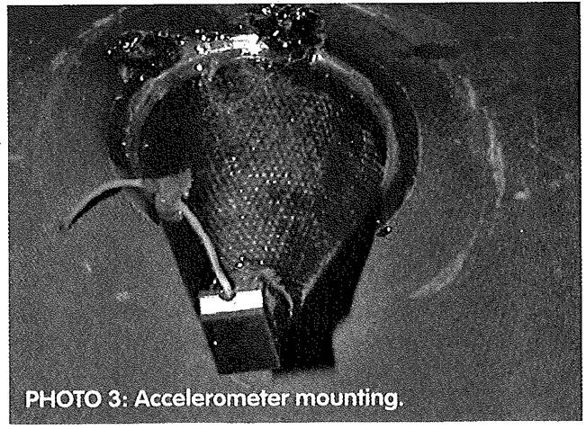

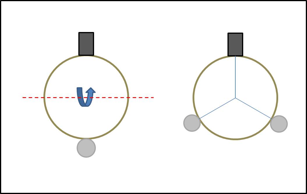

Your mounting method on the edge of the voice coil is not unusual, although as you pointed out the air volume of your box is much larger than typical. This might be related to why the rocking mode is seen.
You might try replacing the single counter-weight positioned opposite the ACH-01 with two positioned at +/-120 degrees to hopefully discourage any cone rocking. (Attachment #1).
Alternatively, you could build a small platform for mounting the accelerometer that attaches to the perimeter of the voice coil and centers the accelerometer mass over the line of action of the voice coil force. You can see an example of this in the Art and Jac Brown article(Attachment #2) and in the Paradigm servo subwoofers(Attachment #3)

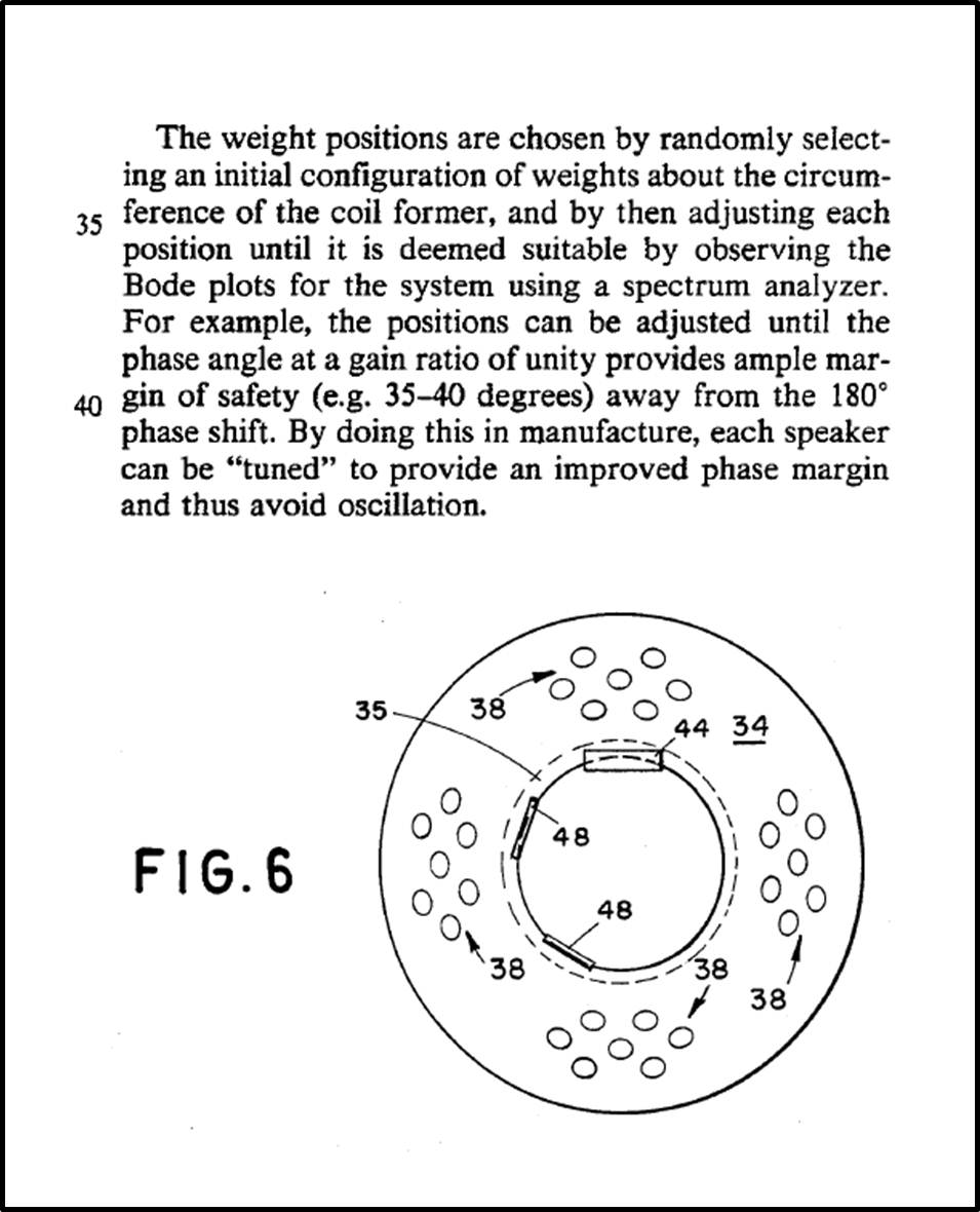

I just remembered that Velodyne mentions "tuning" phase response with weights attached to the voice coil in the patent US4727584.
Relevant excerpt can be seen in Attachment #4.

Thank you, thank you, thank you!
I have played around with the system today and learned that it is indeed some cone rocking going on. While this a good thing when it comes to phase margin it does create problems when my servo circuit is sending my amp to clipping with its huge 13Hz signals.
I am tempted to insert a 13Hz twin-T notch filter in the accelerometer feedback loop, I'll try and let you know.
If that also fails I think my best option is to build a new accelerometer platform.

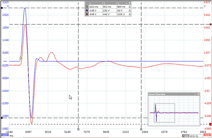

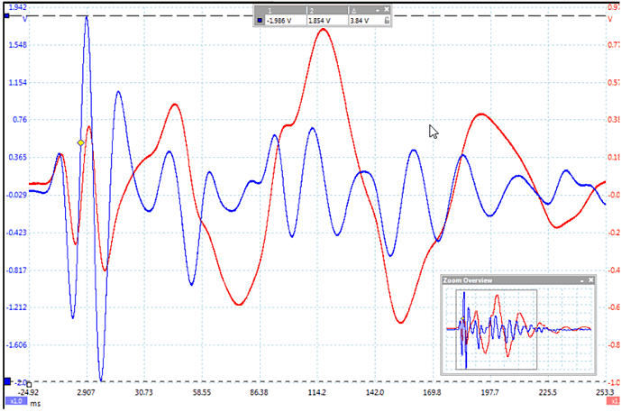

So I made a twin.T notch filter. First at 13Hz, and then at 11Hz which gave better results. Adding it in the accelerometer feedback chain did not help nearly as much as adding it on the output before fed to the LM3886. I don't know why.
The huge signal (still present) is now reduced pretty much before sent to the amplifier. But solving one thing creates others :(

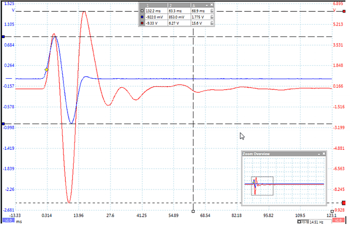

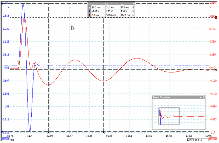

While the system now does impressive things with single 70Hz bursts I still have have 17Hz ringing and sometimes rather large cone movements at 3-4Hz when playing music. Still no oscillations however.
Plot 1. MF OFF. 70Hz pulse. Red = mic @ 5”. Blue= from soundcard. We can see that the recorded signal from the microphone is quite different from the input signal. SPL=117dB
Plot 2. MF ON. 70Hz pulse. RED= mic @ 5”. Blue= from soundcard. We can see that the sound recorded from the microphone tracks the input signal quite well. This is the really good part along with the lower distortion. :) SPL 114dB. The SPL is lower here since the cone is not allowed the overshoot.
Plot 3. MF ON. Blue= from soundcard (same signal level as in plot 2). RED = signal sent to woofer from servo circuit.
The peak voltage sent to the LM3886 is 1V and equals 22V peak on the speaker terminal. It is interesting to see that in fact zero negative signal is sent to the woofer and still the sound pressure tracks the input signal as can be seen in Plot 2 above. The speed of the cone alone is enough to produce the sound while the servo circuit is just breaking it by holding the voltage around zero.
I still have problems with ringing after the pulse at a frequency of 17,3Hz as can be seen on the two vertical markers. But this is much less now with the twin-T 11Hz filter.
For those interesten in seeing how the signal looks before and after the notch filter:
Plot 4. Signal before and after notch filter with a 70Hz pulse to start the show.
I am going to play around a little with the system as it is and see if I can make it good enough for permanent use and give you a report. But eventually I think I will try to mount the accelerometer on a cone like Jac did.
