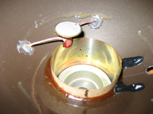

…they developed a better method to afix the accelerometer to the driver which further lowers distortion. So I sent them the driver. When I plugged the driver, with the accelerometer better attached to the cone, into the subwoofer box, I discovered that the bass was indeed much better, and is to this day one of the best subwoofers I have heard.
Was the woofer new as well? or did they send back your same woofer but with the improved accelerometer mounting.
I ask because the Genesis upgrade page mentions a woofer upgrade as well.
Genesis Advanced Technologies › News
Any clue as to what changes were made to the accelerometer mounting?
I am not that familiar with their products…wondering if it was anything like this pic of an older Genesis 12B woofer.
Audio Asylum Thread Printer
The mounting looks a little precarious to me perched on a stick mounted to the VC.
But then again, I guess it would deter vibration from cone break modes finding their way to the accelerometer.

(The Genesis woofer does not look very elegant, as Retsel mentions. Of course as Retsel mentions, MF corrects for many manufacturing shortcomings and lets the manufacturer cut corners. Or you could work with VC MF using the kind of high-class driver loved around here. A lot of the patented work was done by manufacturers who wanted to put a "quart of milk into a pint pot" rather than the DIYaudio crowd who want the last bit of quality using quality parts.)
