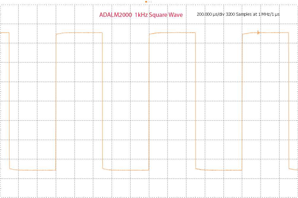

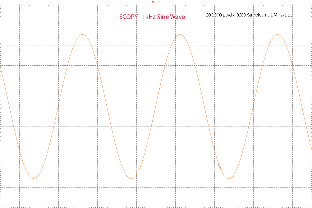

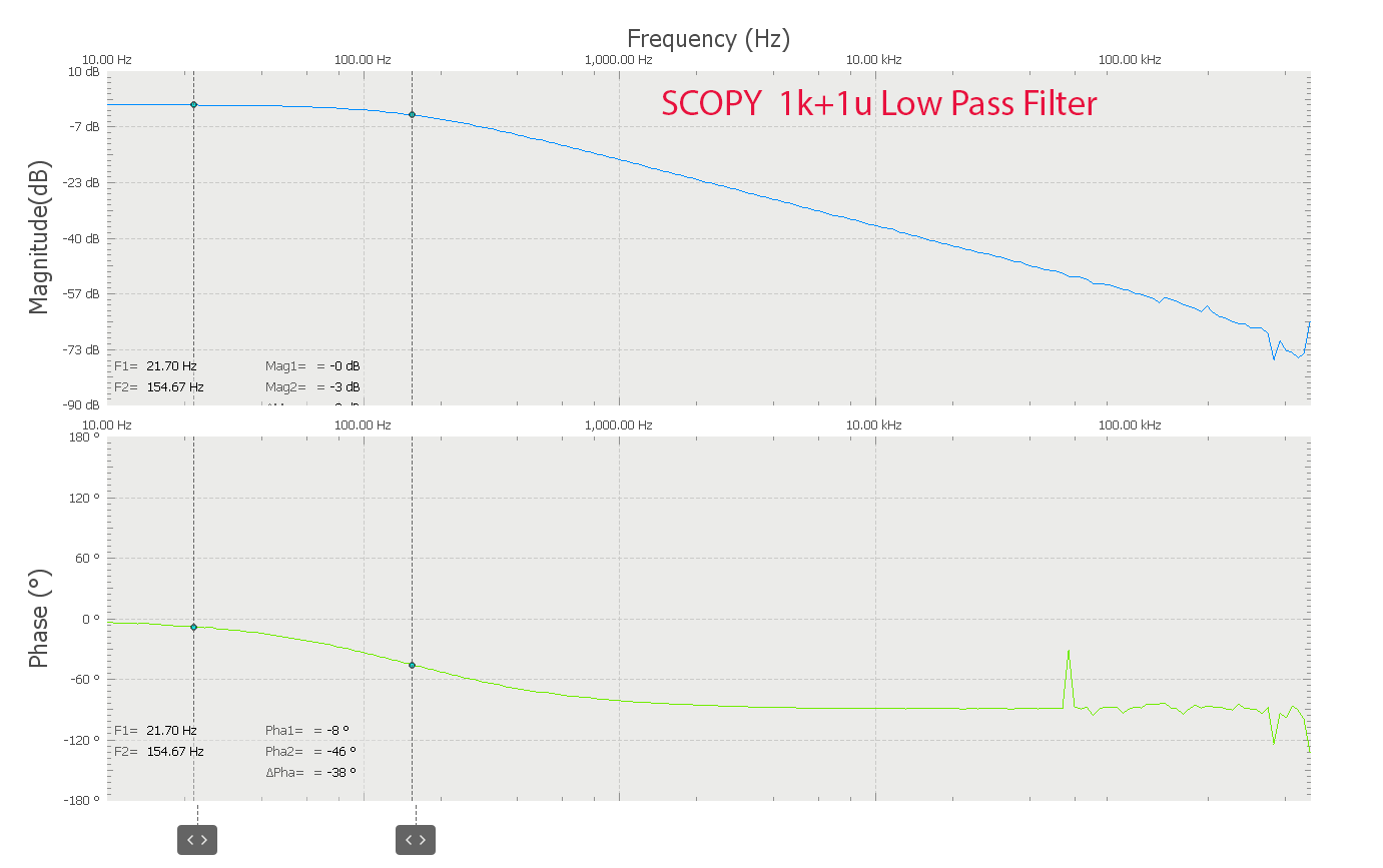

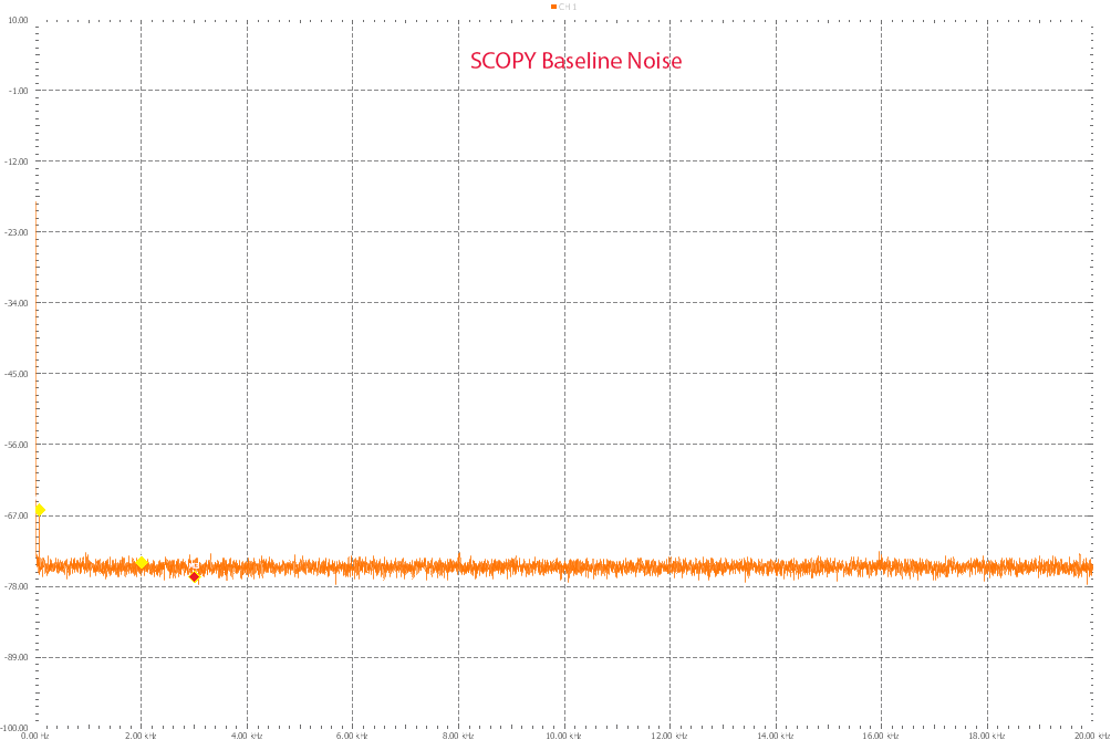

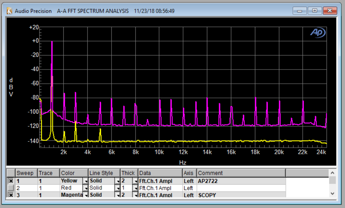

Got the ADALM2000 situated on the bench. Sine and square waves generated by Tektronix SG5010

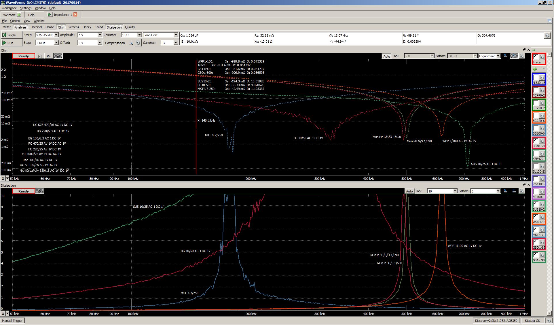

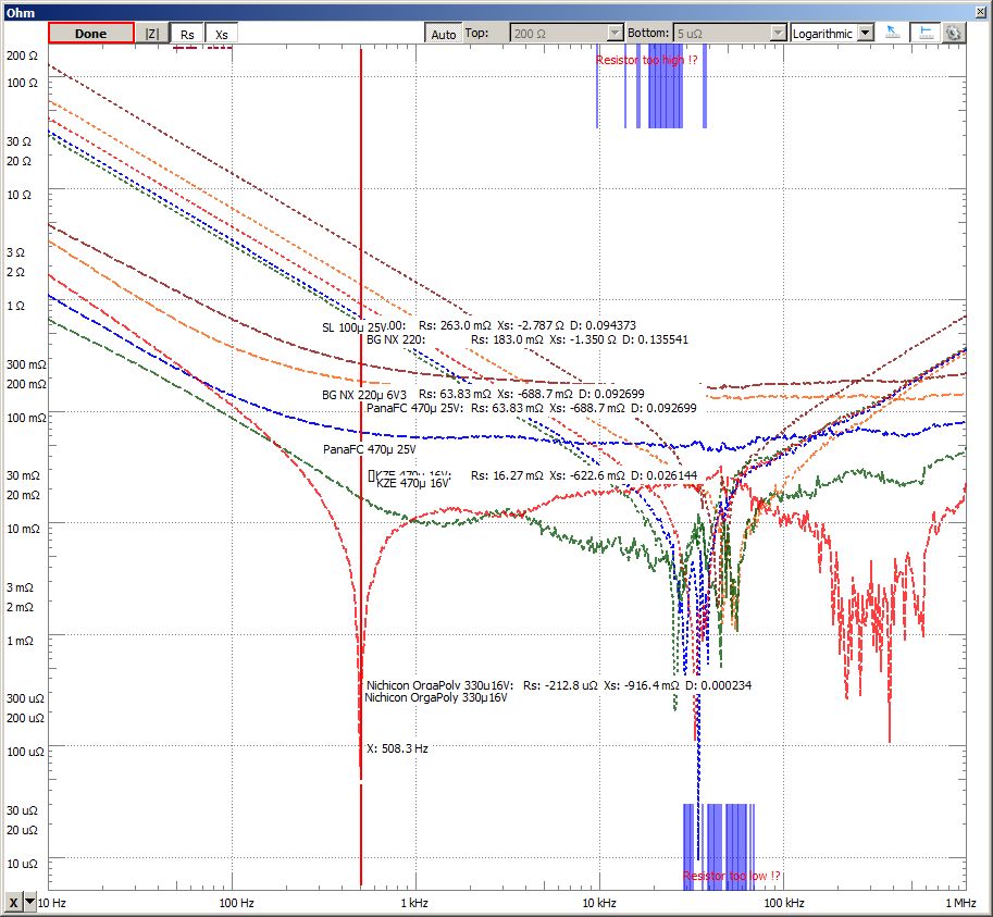

Did some impedance sweeps of various capacitors (see attached Analog Discovery Impedance Analyzer C-Typen 20180109.jpg). Goal was to find out why a Black Gate does give so good sound results Quite impressive curves... At the 2nd attached picture Analog Discovery Impedance Analyzer Elkos - Rs Xs.jpg some kind of over / under load warnings (resistor too ...) indicate that the voltage delta is too extreme to give good results - more bits might be usefull Using one of my soundcards (L22, RTX6001) did fail, so far - for reason unknown (error70?) UlliI like the possibility of doing Spectrum, Network and Impeance analysis. Are the ADALM and AD2 really useable or just too restricted for these tasks?

for normal audio use I have DAAS32 and Quant401 audio analyzers. True Spectrum-, or Network-, or Impedance analyzers are well beyond the 1k€ mark, typically cover a freq-range from several kHz to a few GHz and they are restricted to mostly one function (the Siglent SVA1015X beeing different, at least Spec_A + VNA). For power supply and decoupling testing the range well above audio up to a few MHz is interesting .... just what the AD2 and ADALM2000 offer. The response curves modmix posted for sure look ok ..... seems the AD2 is more than just a toy 8thanks alot btw. for that linto that chinese website ... think I´ll give google translate a bit of work ) The Q remains how the ADALM2000 compares.

The self resonant frequencies in the cap plots all look low to me. That could be the test setup. Its also useful to check some reference parts (low value resistors) to make sure the numbers are right.

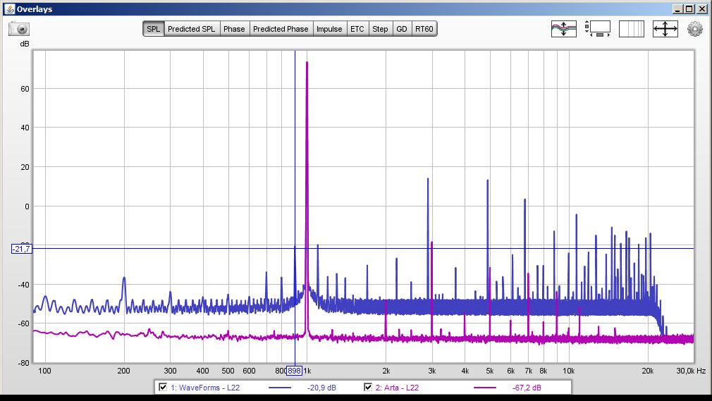

WaveForms vs. Arta driving L22
Setup: software (WaveForms, Arta) used to generate a 1kHz sine at L22 output. L22 output looked at with RTX6001/REW.
WaveForms generates more noise and more spurs (about 100 Hz from carrier).
Looks like WaveForms has some limitations...
Ulli

Didn't use soundcard calibration with Arta.Could be an issue of Arta using a soundcard calibration file, WF not.
BTW: output soundcard calibration just tells Arta which voltage level is produced by a given signal setting.
In my case, the output (seen as input level in REW) was set to be more or less the same in either case.
Does a generate have sampling settings?Also maybe check the sampling settings in WF, averaging or not makes a big difference.
Note that in both cases measurement is done by REW/RTX6001 usind the same setting.
I see two issues:Otherwise, IDK.
- noise
- spurs
Ulli

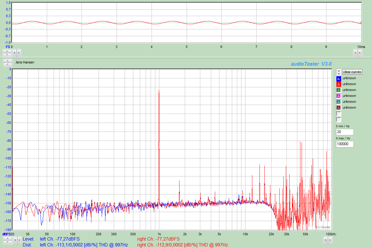

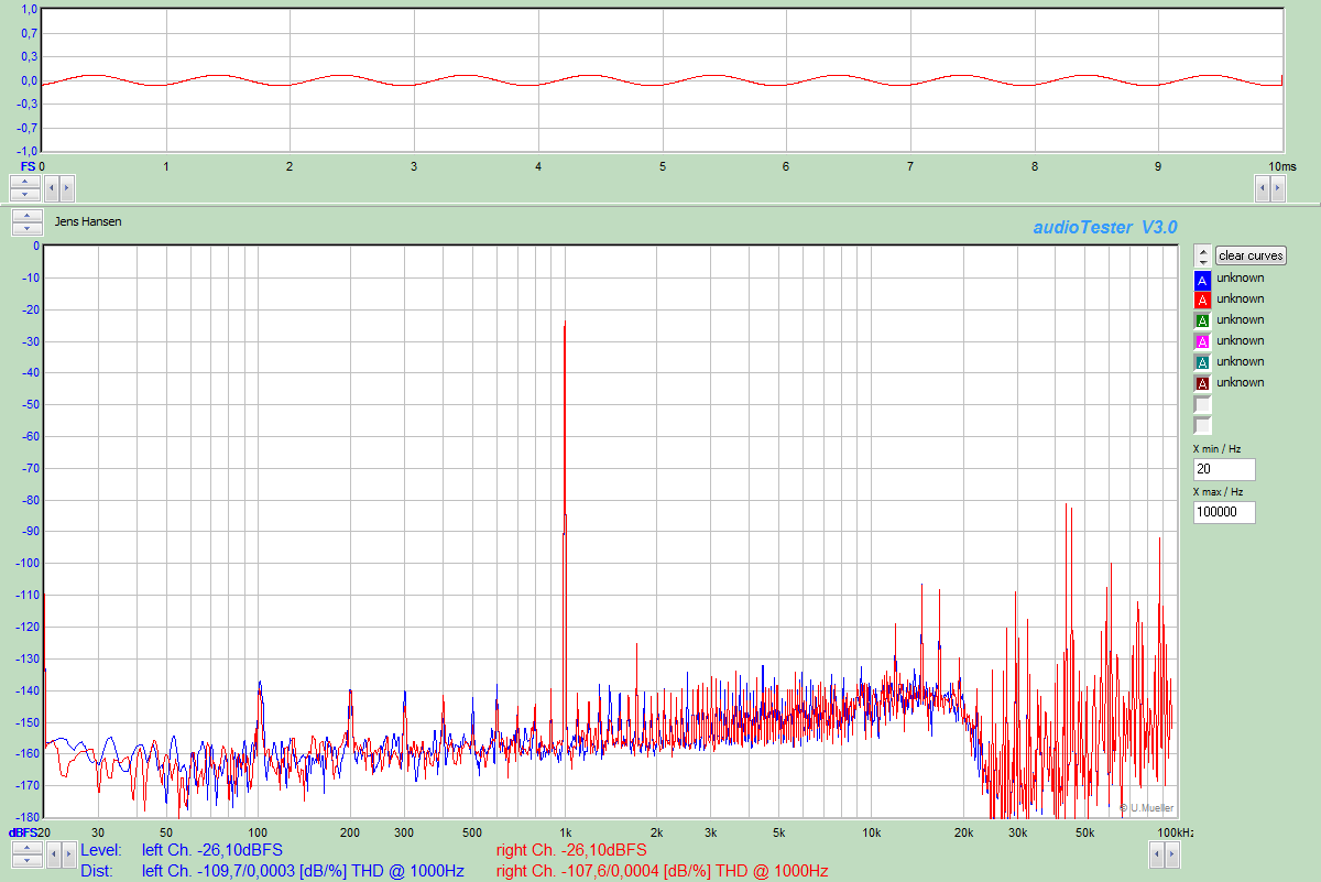

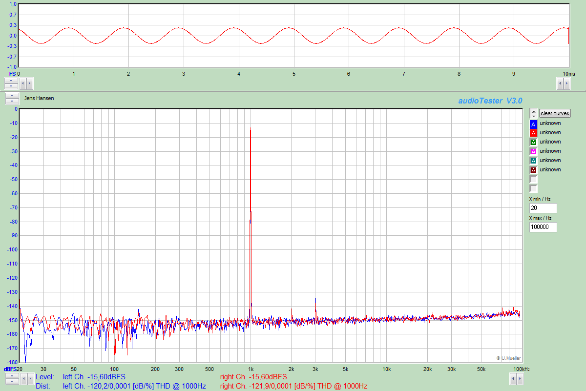

It looks like issues with Windows to me. Perhaps a combination of 16 bit and sample rate conversion?
I just made some loopback measurements with an RTX6001. One using ASIO (which I prefer) and two using Windows Direct Sound (which I don't like).
The first one is with ASIO, the other two use Windows Direct Sound. AudioTester was set to 192 kHz sample rate in all three cases.
The result when using "Direct Sound" (which is everything but direct!) differs quite a lot between a 1 kHz case and test tones slighty offset. In this case I used 997 Hz, but 1002 Hz gave a similar result. The 1000 Hz case gives a lot of spurs at multiples of 100 Hz from the carrier. In the 997 Hz case those spurs are not visible.
With ASIO the carrier frequency doesn't matter.
So if you can use ASIO (or WASAPI),you really should do that.

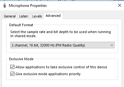

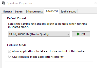

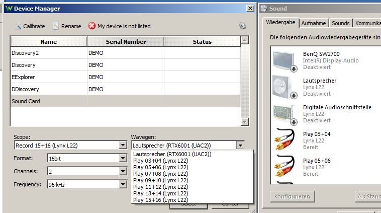

In Win 10 you need to check that the application, the driver and windows are all running at the same sample rate. Win 10 will insert sample rate converters anywhere it can. You need to go back to XP to get a version of Windows that won't mess this up. ASIO is a good work around if supported.
Even driving the same device Windows will let you use mismatched settings. You need to go to the control panel (pics below) pretty much every time you use the testing software.
