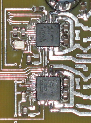

The ADAU1592 isn't that hard to solder. Most of the pins are doubled or tripled, and the single pins really aren't that hard to solder. Just use lots of solder and then wick off the excess.
It's a very nice little amp. Dead quiet and low distortion.

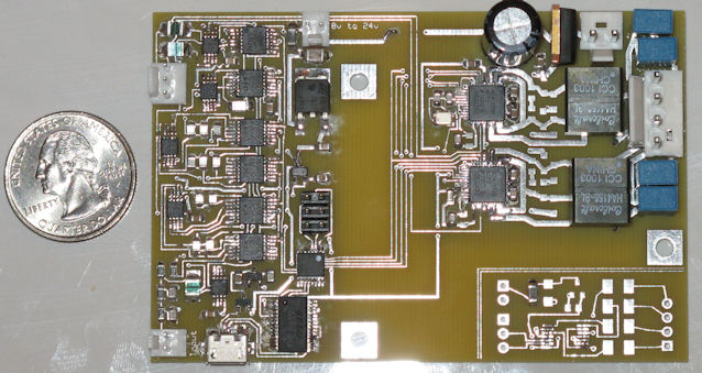

Yeah, not too bad if you have TQFP old stock as used on the board above. If you don't, you're stuck with an LCSFP as the TQFP's discontinued. That's rather harder.
The two ADAU1592 chips are LFCSP_VQ--they are on the right side of the board. I repeat: not that hard! All I have is a 30-year old Weller iron with a fine tip.
The stuff on the left side is an active crossover with TSSOP packages.
Look ma, no legs...

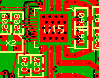

I'd correctly located the chips, just got confused between traces and pins amid the lack of pixels. How'd you handle the bottom pad? Hot plate?
Vias. It's just one of those ExpressPCB prototype boards, and there is a limit on drill size and hole closeness, but even so you can pack a lot of vias under the chip. I solder from the back side with a 700 degree tip to fill the vias. Not sure how much solder bonds to the chip thermal pad, but the board gets somewhat warm, so the heat transfer seems good enough.

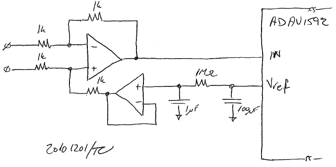

Any of the audio grade films or 'lytics would be fine---I just happen to default to Elna RFS. In most cases the f_low increase from tweaking Analog's suggested input network to use 1uF 16V 1210 PPS parts should be viable---page 19 of the 1592 datasheet suggests the input impedance is fairly well controlled.
An alternative option I like better is to avoid DC blocking by referencing the differential to single ended conversion fronting the 1592 to the 1592's Vref pin (same approach works for reference shifting with unbalanced inputs). Datasheet doesn't seem to mention anything one way or the other about doing this but, since the 1592's input and output end up sharing a quiet reference, noise rejection might well turn out better than a more traditional ground star arrangement. In this arrangement I'd be tempted to take Cref to zero if it weren't for the datasheet mentioning the modulator uses Vref and Cref acts as an AVdd filter; instead 10uF 25V X7R 1210 is probably the sweet spot for a compact Cref. (I'd be surprised if the noise from something like a 49710 or 49990 is significant compared to what the 1592 puts into Cref.)
I like that. And I happen to know just the circuit that'll do that. A transformer... Like the Jensen JT-11P1. But at $65 and umpteen times the volume of the entire class D amp it does seem like putting 10 lbs of sh*t in a 5 lb bag...
One could also use a differential amp. Connect Rg to Vref rather than GND and you get Vout = Vin(Rf/R1)+Vref (for Rg = Rf; R1 = R2). I'd be tempted to filter and buffer Vref as its output impedance isn't spec'ed anywhere. Aside from 20 kOhm, typ neither is the input impedance by the way. With process variation and such, it's probably +/-10 % - so "tight enough".
Yeah, with that happy house of switching and 5th order MASH (or whatever spread spectrum modulator they use), I'd want that Vref to be quiet. 100 uF tantalum plus 1 uF MLCC, maybe with an additional 10 nF C0G or X5R in parallel would seem reasonable. Or MLCC instead of the tantalum. It's only sitting at AVdd/2 = 1.65 V (typ). One could get away with 6 V caps, though with the voltage coefficient of MLCC's using a higher voltage type is probably not a bad idea.
Me too. One could also filter it... Stare at attached.
