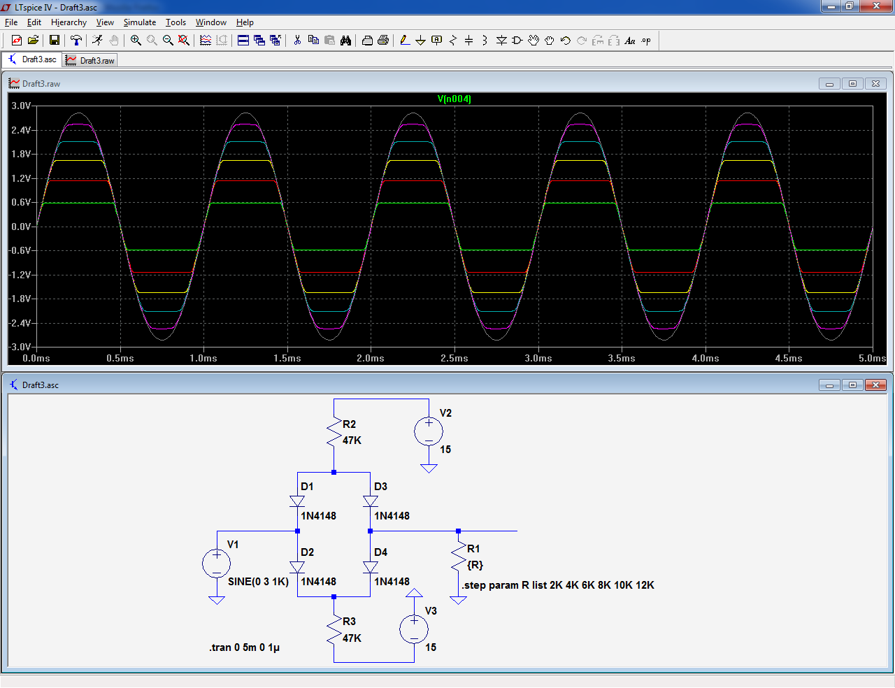

The clipping circuit i provided, by example, i do not know if this one (From Elvee) would be better ? ...
http://www.diyaudio.com/forums/atta...10964-my-little-posh-tringlophone-clipper.png
This is your circuit.

Hp line input need to go both in the front opamp comparators and across the relays, of course. Not separated.
Input lines have to go in and out to the amp. It would be good to add a clipping circuit. Let me little time to make simulation between the two possible to see each one will be better for no distortion. Input switch is necessary to protect the output relay in case of short circuit. It will cut the input signal before the relay has to cut huge amps.
