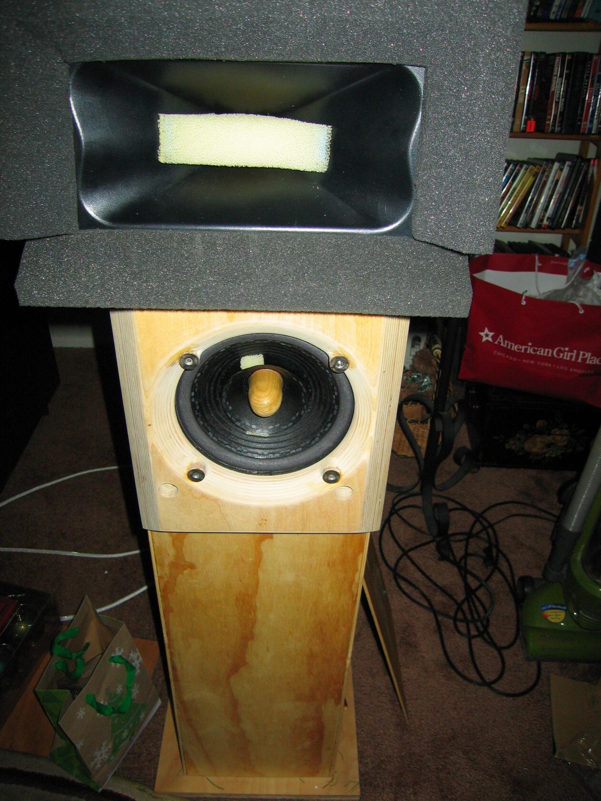

An inexpensive Gedlee/Bouska waveguide/tweeter midbass idea.
I rolled up the reticulated foam and stuffed it into the throat as far back as it goes without hitting the diaphragm.
Then I taped on another half inch layer. (This whole experiment is held together with tape!) More might be better but I have no more.
I have no idea if this foam is the 30ppi that Gedlee uses or not. Lots of aquarium supplies and other places sell this foam.
I've used the foam in 2 other horn/waveguides and this is the first time it made a big difference in the sound quality.
The foam around the edges of your waveguides being entirely covered with tape, I do not think it has any effect on the diffracted waves (in absorbing them).
The purpose of the foam was not to absorb sound. It is a cheap, easy to work with material that would be a roundover to reduce diffraction.

Fill the throat gap with Mortite to smooth the transition.
Put some swim foam around it to reduce diffraction, tossed in the reticulated foam I have for backwave and echo reduction.
Left the same xover as the RCF WG/horn. Sounds a lot better even unEQed. A lot more potential right off.
The B&C 10" driver tube or box is next. Need about a 30-35 Liters enclosure for about 100hz.

If you're in a hurry, plain ol' polyester fiberfill will work in a similar fashion as the foam. The advantage of the foam is that it's consistent, and you can cut it into a shape that extends beyond the edge of the waveguide, to soak up HOMs near the mouth. (A lot of HOMs are generated at the mouth and the throat.)

Sakrete tube is 3 layers, no air space. About 27 liters.
The 10" B&C driver is a lot better in this app than the 12" Volt driver.
Not even close to having the Xovers dialed in. Rough with warts sounds goods.

I put in 2 notch filters.
One knocked down a peak pretty good for a guess using spare parts.
The other kinda hit and kinda missed.
Played with the xover point up and down, sounds better closer to 1,100hz.
Subjectively it sounds much better. Better than I expected at this point.
I wish the 10" was waveguide loaded in some way so it could be as dynamic as the tweeter. It's not a deal breaker just a minor thing.

It's very similar to what I do with foam on horn terminations. It smooths the region below the horn cutoff, which can be the source of a fairly large peak in some instances. I got as much as 2dB of ripple smoothing, as well as extending the directivity of the horn downward, albeit without the sensitivity boost of a horn proper.

As the project is now.
B&C 10" is in a PE 1 cu ft sub MDF box that was on sale for $87. 14x14x14 approx. Dayton SWC-1 1.0 ft³ Subwoofer Cabinet | Parts-Express.com
The WG is rebated flush with the baffle. The 10" is mounted on the baffle. This time alignment sounded the best in my listening tests, totally subjective.
The front baffle has 1/2" roundover I routed on it.
Yellow foam works well.
The white ring around the 10" is a 1/2"x1/2" quarter round made of vinyl from Home Depot. Put it in the oven for 10 min at 250 degrees to make it soft and pliable to bend around the speaker frame. The vinyl shrinks.
Supposed to be a roundover, but it only works a little. So I am looking for another solution.
Xover is now at around 1400hz 2nd order LR with one notch filter in the tweeter that works well.
This fall I'll get a mic and cables to test this contraption.
Now it sounds better than it did in the sonotube, cleaner, clearer.
