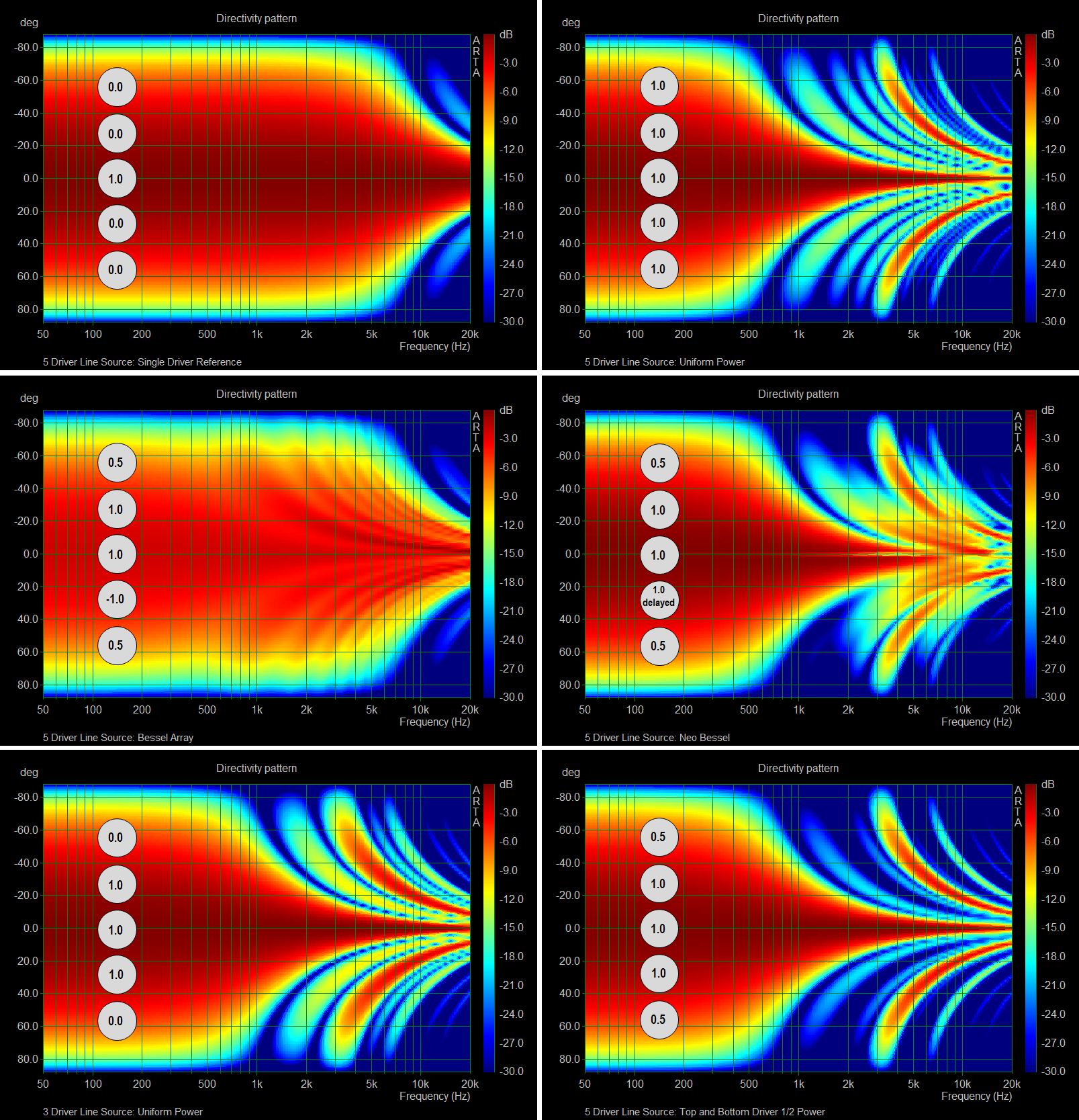

ARPE gives a better picture of what's going on, because it can sim the entire bandwidth and can include crossovers. Here's how a straight array looks on the vertical axis. This is a five element array of 2" drivers with a CTC spacing of 2"
This looks horrendous, but keep in mind that straight arrays aren't really designed to be listened to off the vertical axis.
Bessel shading makes a world of difference to the vertical polars, but *poof*, there goes 75% of your output.
Since the recessed driver in the "NEO Bessel" is 'tuned' for a single frequency, it occurred to me, what if I just stuck a tweeter there? The idea here is that you would have five drivers total. Four of the drivers are driven full range. One of the drivers is high passed - the tweeter.
Here's how that looks. Not as efficient as a straight array, but close. Nowhere near as inefficient as a Bessel array. To illustrate the effect of recessing the tweeter, I've simulated the array using fifteen different depths, from zero to 0.75" in steps of 0.05". It's kind of amazing that recessing a driver by 0.05" changes the polars that much :O
The flattest polars are when the tweeter is about 0.6" deep. But to see the whole picture, you really need to know the inductance of the other five drivers, because that inductance will introduce a delay. Or, better yet, just give that tweeter it's own channel and delay it with DSP :)
With ARPE you could definitely come up with an optimum depth for that tweeter too, and also factor in the inductance of the other four drivers. For instance, a lot of 2" drivers are rolling off by 10khz, so with ARPE you could factor that in.
Thank's for those. It's not easy getting great polars.
They would be even better if I hadn’t failed to un-check the box to mirror the positive angles to negative.
The middle 2 plots should have been slightly asymmetric. Correction attached.
Sims or measurements? ARTA doesn't simulate from what I remember.
These are simulations. I do number crunching with FORTRAN or VBA code and then export ARTA binary format impulse files for plotting. I started doing this because I found it convenient to have overlays of theoretical targets available when measuring. Then I realized I could easily use all of ARTA’s plotting tools to visualize simulation results. ARTA can also import impulse responses as *.wav files if you have other simulation programs like Hornresp that you like to use.

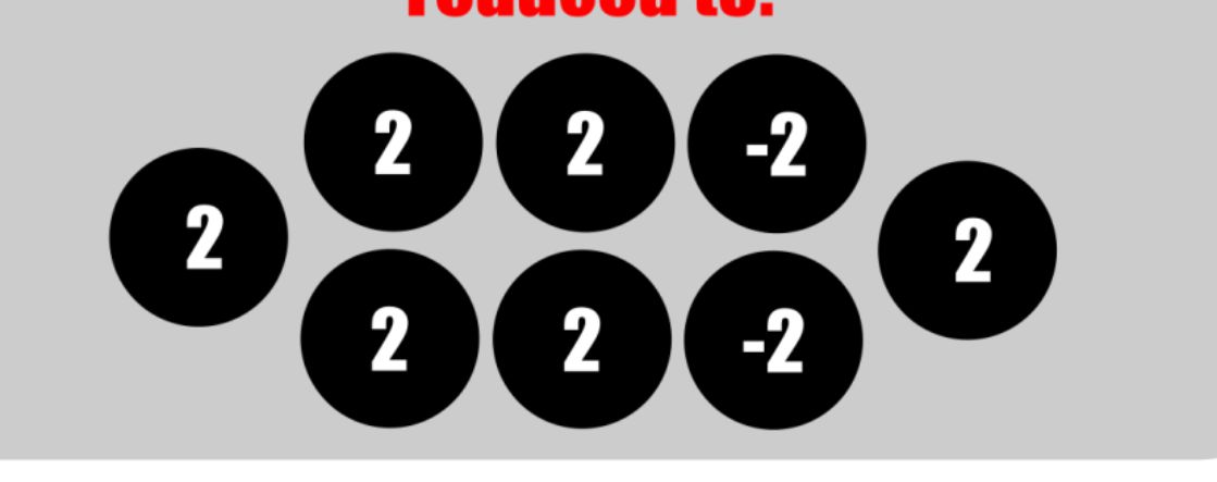

There was a forum member who was trying to figure out how to make a Bessel with fewer drivers than prescribed.
Here is how to do that. This can be done with ANY type of array, not just Bessel. The way that this works is that you're replacing a pair of drivers that are getting a FRACTION of the voltage with a SINGLE driver that's getting FULL voltage.
You can sim the results yourself in Hornresp. It doesn't work *exactly* the same as power tapering, but it's pretty darn close. And it really really simplifies things a lot. Besides saving the cost of additional drivers, it also maximizes your power handling. The reason for this is because a conventional Bessel array has a number of drivers that's only receiving half the power of the others.
What do the 0's 1's 2's -1's -2's represent?
You can have unlimited sources, and they can be shaded and delayed.
