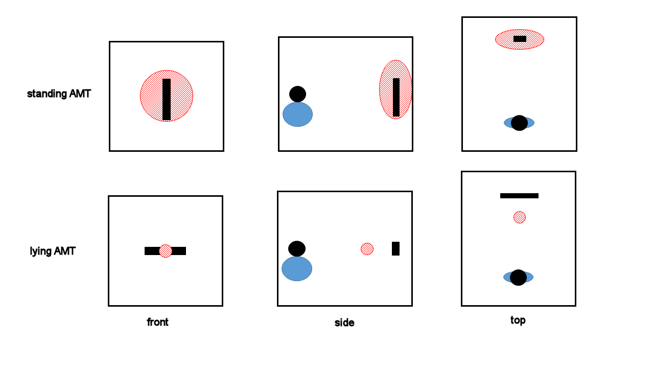

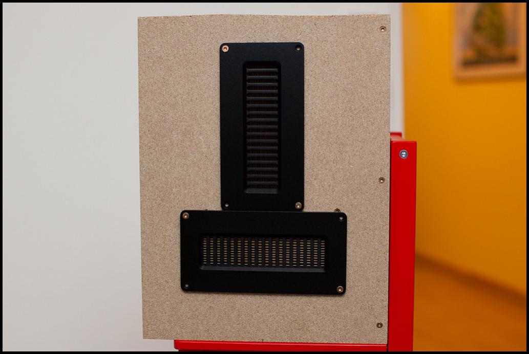

I made the same experience with a simple monaural experiment. I listened to music (and pink noise) over two long AMT drivers. These drivers are so long that their vertical directivity is extremely narrow. I used a switcher to switch between the drivers without delay.
The advantage of this arrangement is that it elminiates all other differences when comparing speakers. It is the same driver. The only difference between them is the orientation. One has a narrow vertical directivity and the other a narrrow horizontal one. Additionally I could rotate the whole arrangement to check if factory spreads between the two drivers exist. In short: they were not relevant.
attachment.php
I listened in different rooms and even in my large garden (practically reflection-free). The conclusion is pretty clear. These were the diference I heard in different rooms:
Horizontal narrow directivity and vertical wide:
- strong narrowing of image (point like)
- near head localization
- sound is a more "dull"
Vertical narrow directivity and horizontal wide:
- widening of image (in width and heights)
- more distant localization
- sound is brighter
I tried to visualize the imaging:
attachment.php
The better treated the room was (my home cinema) the less the differences were audible. But they only disappeared when I put the arrangement in the garden. Then the differences were completely gone.
Of course the conclusions may not be completely transferrable to stereo, because there were no phantom sources. I don't have 4 of the AMTs so I can not do this.
And btw. an equalized dome tweeter with wide dircetivity in both dimensions continued the trend in terms of wide image, more distant localization and brighter sound.
I think the explanation of the brighter sound is that lateral reflections arrive to the ear from a steeper angle. And if you take a look at the HRTF then it is cleae why they sound brighter. :)
In my opinion a few lateral reflections are good and help to create a more "natural" sound field. Even if they doesn't belong to the source they help to create a pleasing experience. But too many lateral reflections create a diffuse sound that many people like, but I don't. I don't know what compromise is best for my room. It is a long way to evaluate this. ;)

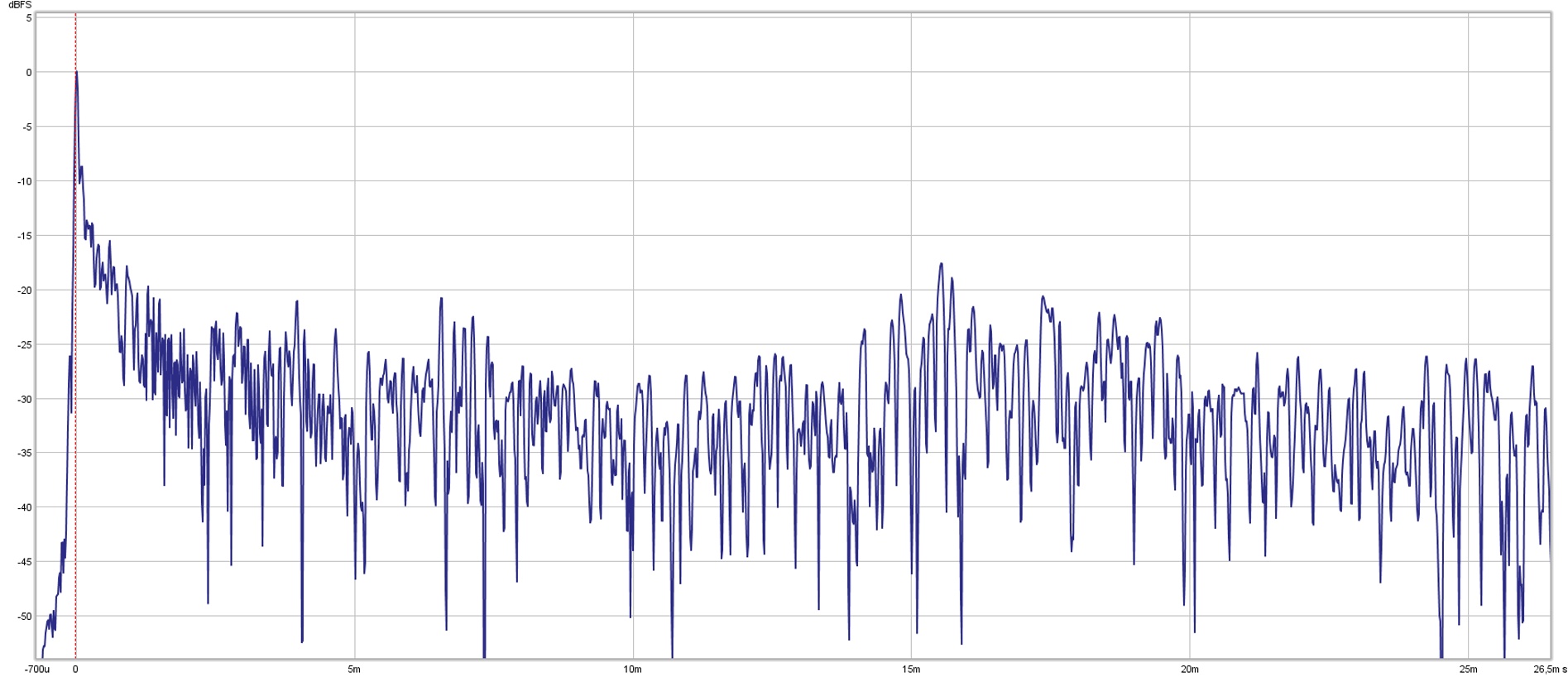

The CBT will average out a lot of reflections but I'm guessing it still needs either a large room (with speakers free from boundaries) or use side wall treatment.
Someone with a CBT please post up the IR showing the first 20 ms at the listening spot. STEP too if possible.
