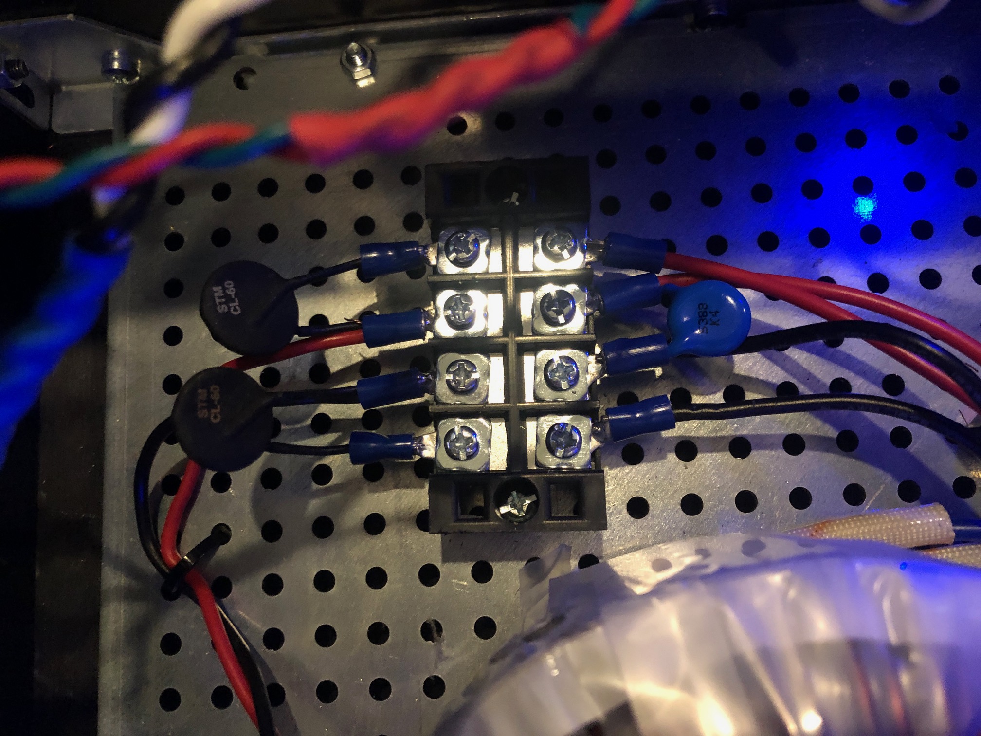

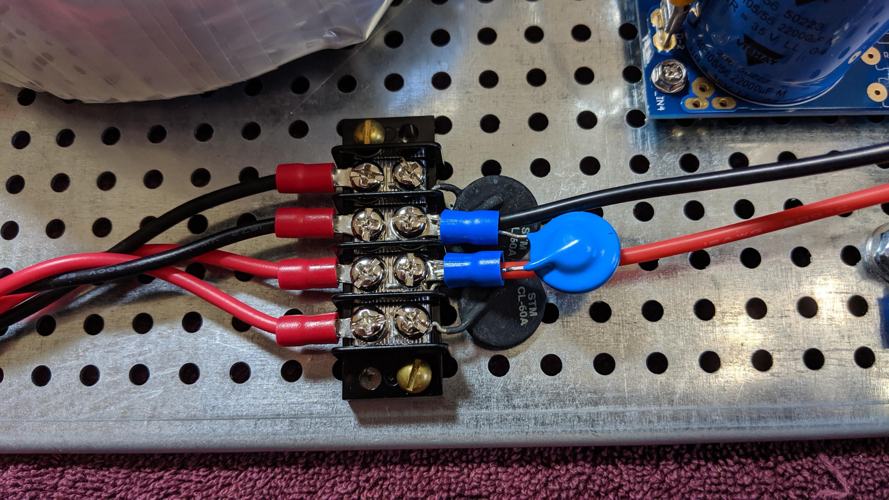

Great advice, thank you! I re did the barrier strip using those. After taking it apart, I realize that had to be the mistake. I tinned the wires and the solder dried in such a way that the contact between the wires and strip was probably very minimal. Now there is much more solid contact.
I fired everything up and it's working great and is dead silent.

Do you guys just crush these things on? I cant get comfy with that. I grab the ring with an old pair of large needle nose pliers, stick the plastic end in flame until it begins to catch fire and scrap the plastic off. crush it to wire and solder. Then cover with heat shrink.
Russellc
A proper crimp tool is all you need,no reason to solder.

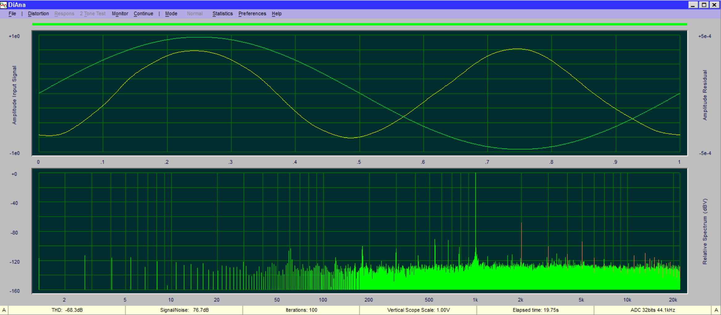

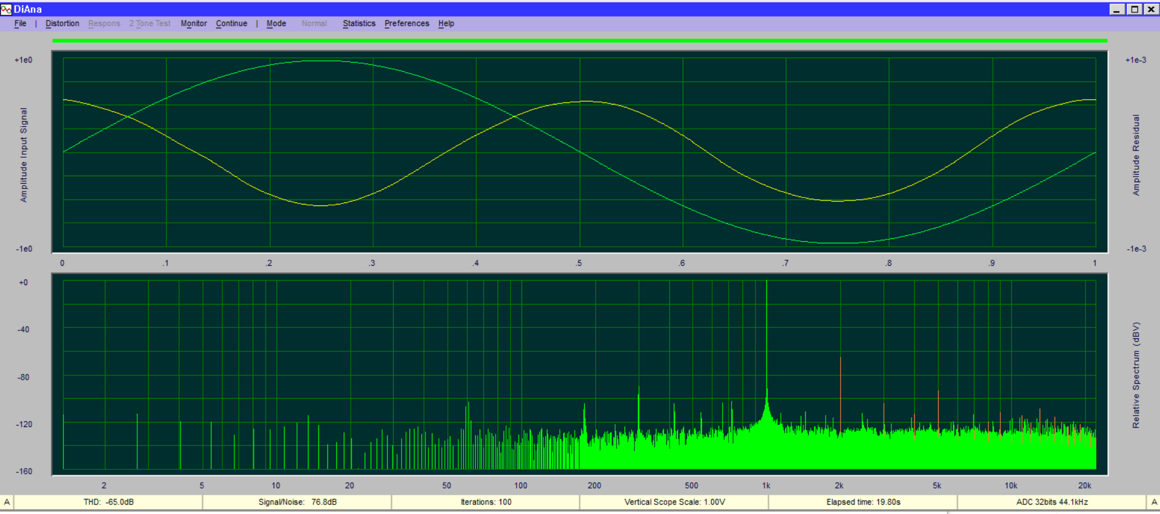

Questions for the more advanced peoples out there:
Here are two results from my very basic distortion analyzer set up.
The first picture shows me turning P3 to the left 3 turns.
The second picture shows P3 turned to the right 5 turns.
My uneducated interpretation of the results is that both of these results show a strong dominant 2nd harmonic. Is that correct?
What is the difference between the two results in the top section? Is that the phase or something else? The fundamental is the same but the yellow line starts at the bottom half on one and the top half on the other.

Yes, the adjustment ranges from in-phase 2nd, to null (none), to out-of-phase 2nd.
Mr. Pass encourages you to listen to the differences, and choose which you prefer.
Thanks for the answers.
The software is DiAna. I don’t have the software calibrated and fined tuned perfectly, but I think well enough to test for the harmonics.
It’s an interesting delimma with the “ideal” setting. I like it null and with a 2nd harmonic. For different reasons and for different music.

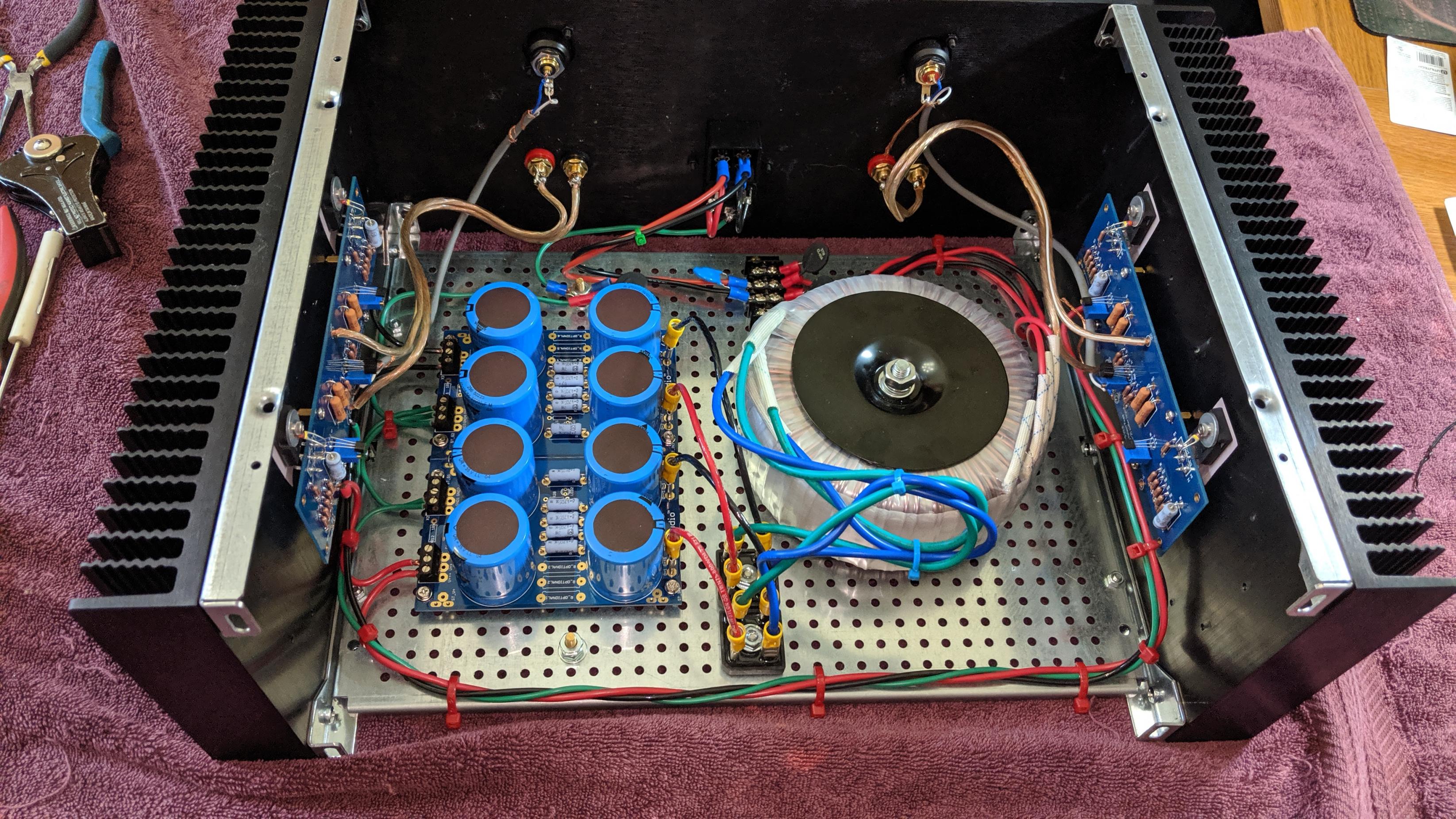

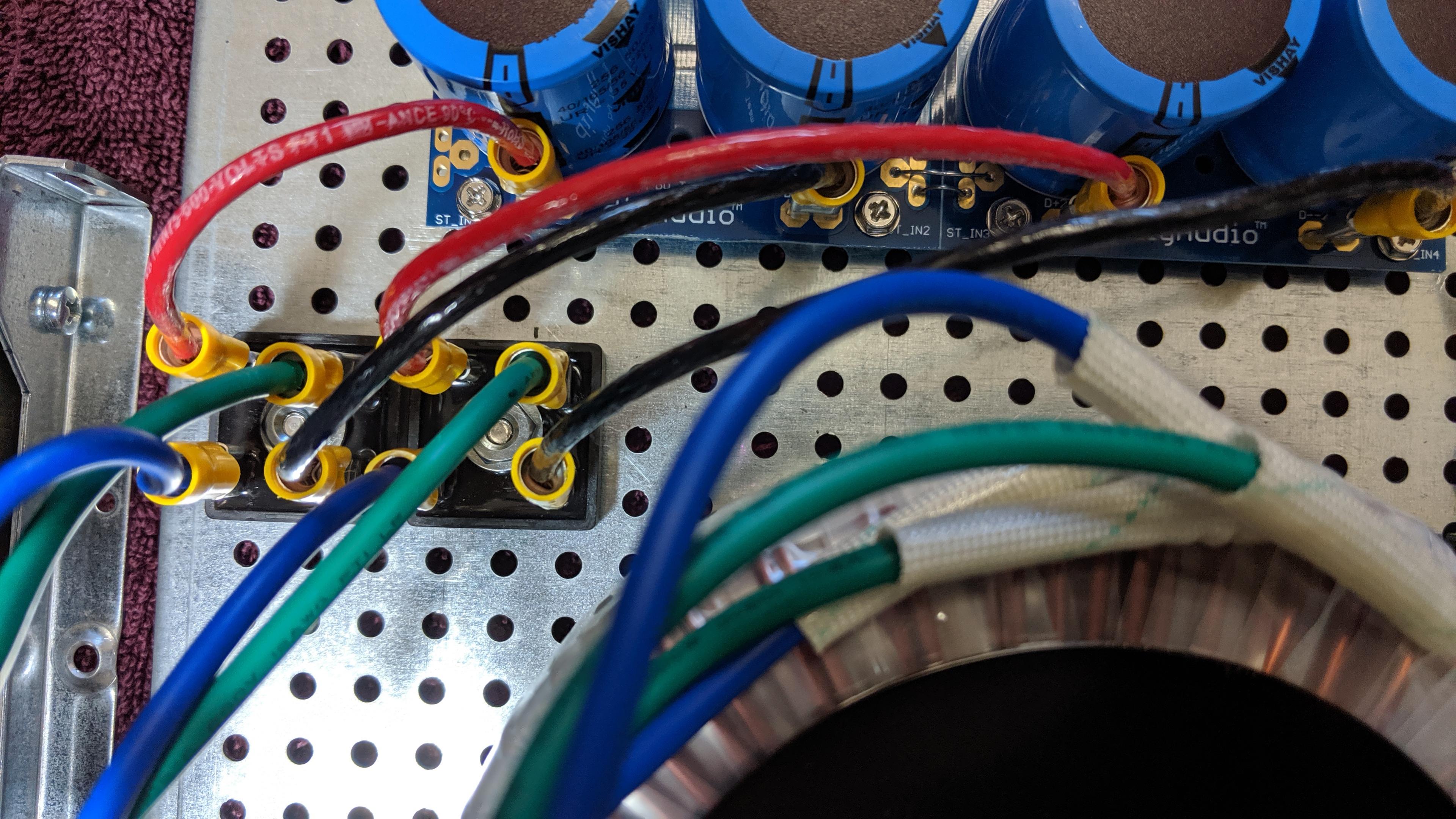

This is a PSA (Pre Smoke Analysis) If someone would take a look at these two pics and let me know if these connections look correct before I energize it, I would REALLY appreciate that! In the pic with the block rectifier, the + beveled corner is the upper left corner of the block with the red wire attached to it.
I already intended to test the PS without anything on the output but thanks for reminding me. I'll get the CL60s off the deck. But with no comment I assume the wires look like they all got to the correct places? What voltages should I expect on the PS outputs initially?
