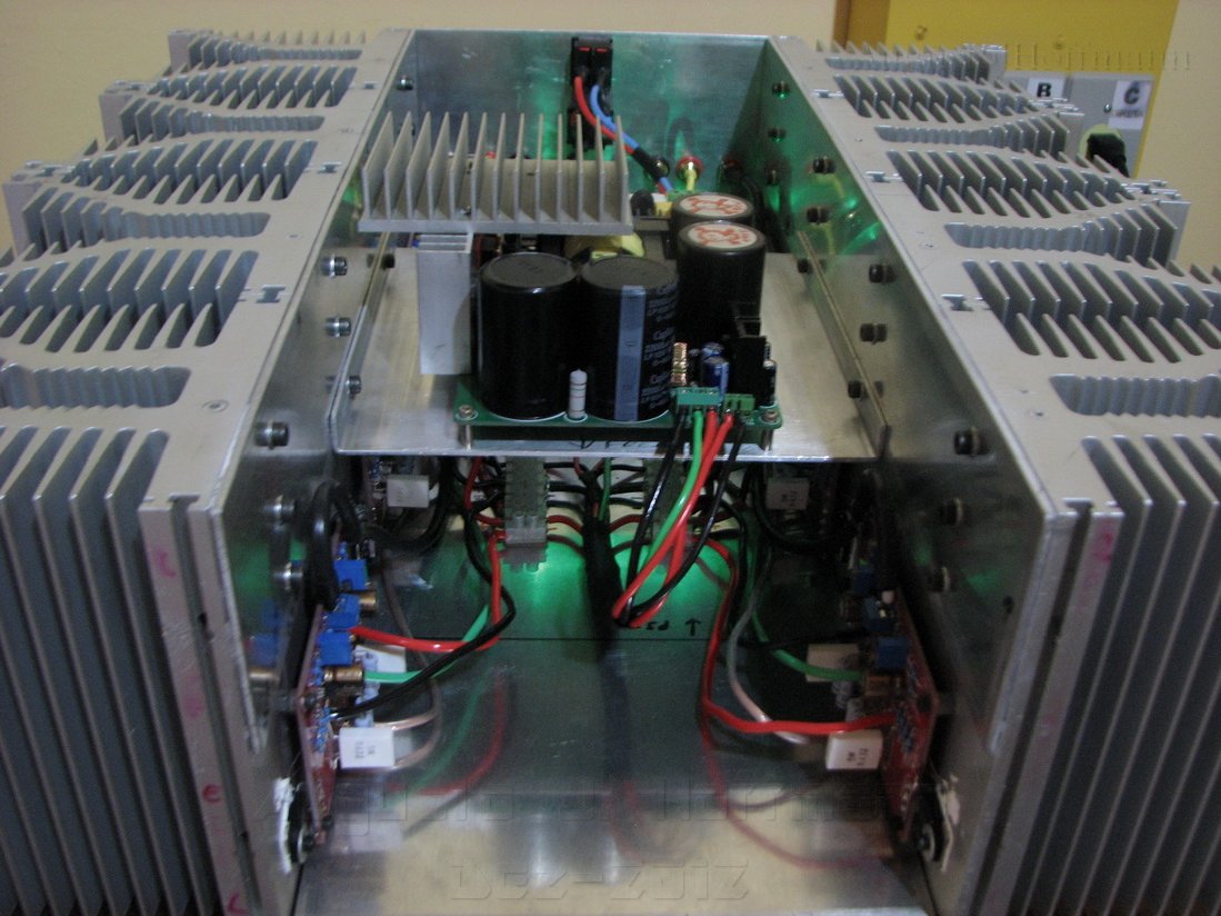

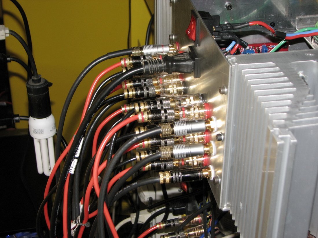

Yeah AndrewT - well, I'm not technical nor designer. Just like to know how to handle audio and solder and screws. Follow some rules and just turned on the amp.. Heats much but works very well. Pat Metheny's guitar sounds better and interpretations of Mike Oldfield or Vollenweider are more vivid. Very good. I hope to continue working in Brazil have much heat.
