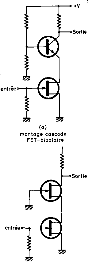

Hi, this is the background of what I mean:I don't understand what you mean by reducing the gate current.
see Le Monstre by Hiraga, 1983, in part 1. The schema shows that the configuration is similar to the F5, except the output pairs (Darlingnot) are now FETS in the F5 of a type not yet commercialized at that time imho.

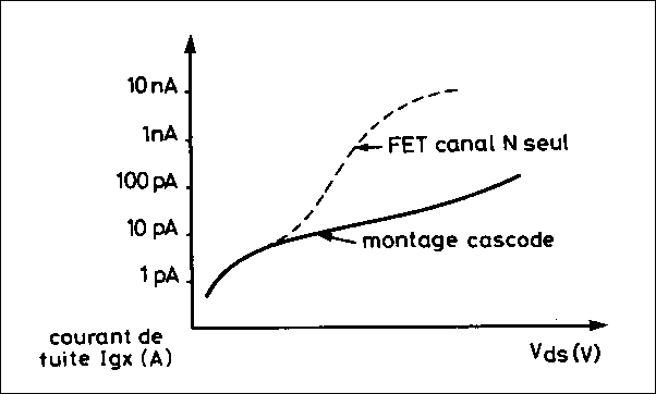

Cascode input current reduction
Getting a lower gate current improves the transparency. The gate current of a single 2SK170 will change a lot when the Vds changes - and in the F5 with the low feedback, Vds does change a lot.

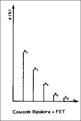

cascode jfet/transistor distortion
This is highly audiophile quality, good to have when applying feedback.

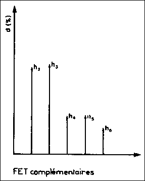

cascode jfet/jfet distortion
You see this is not a really 'audiophile' input combo. On feedback, higher order distortion starts to increase.
Of course the Miller effect vanishes too.
Hiraga also says that the combo of a biasing of the cascode with a zener sounds worse. (Now your "super"zener IC might sound better than a stock zener, but I just want to mention it anyway.)
Just my two pennies.
albert
These are the two types.
Andrew,
The jfet+cascode on the top is the winner. This nice harmonics goes for the earthed config.
So it works like this in the Zen I/V, but for the F5 the bottom of the bias circuit has to be connected to the source, sort of 'floating', as far as Hiraga's recommendations go.

Of course the text should be "The jfet+bipolar transistor cascode on the top" [of the illustration].
for me a transistor is a bipolar NPN or PNP device; I would never call a jfet a transistor. Just my nomenclature.

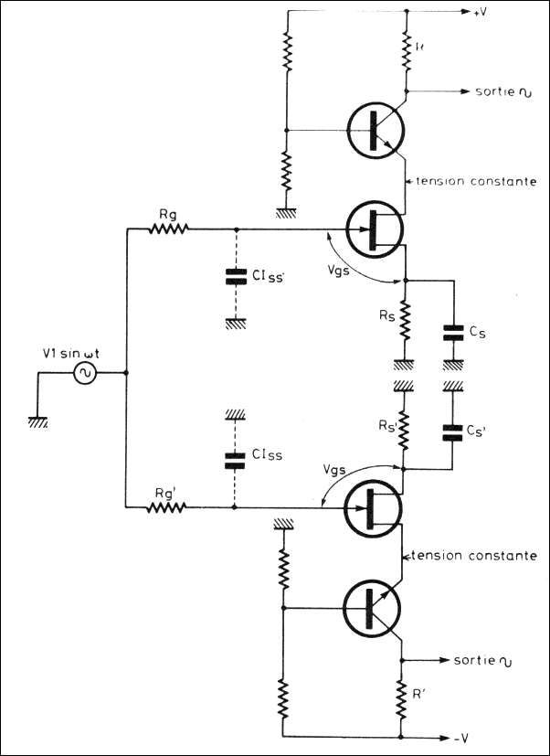

This is the input of the described amplifier of Hiraga [without the feedback], just to see the overview of the input of that reference:

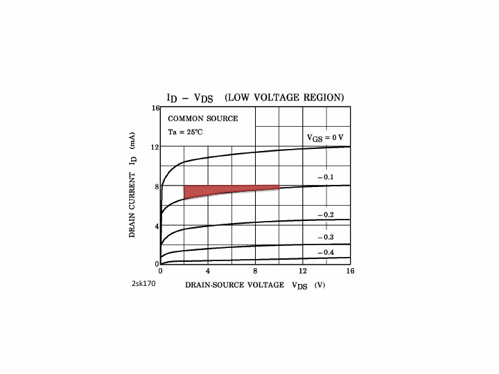

- sorry I only have the degradation curves shown earlier and not with a floating Vsource of 8 V pp. Would be interesting. However, it does not work to measure with a closed loop (a running amp). But looking at the curves we see the bad effect of the floating source:
The jfet is 'forced to bump around'.
Well of course we keep 15-20 dB away from the worst case situation, so in practice . . . we are all happy anyway; and some like the ensuing distortion when driven hard.
