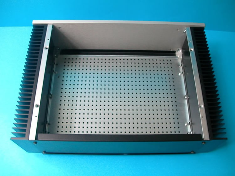

I'm not Albertob, but if you're looking for heatsinks you might be interested
FRANAB - Industria Metalúrgica Ltda
If you're in SP then they're in your neighbourhood. I bought sinks from them for my F5 a year or two ago and was very pleased the quality of the sinks and the service. I live in Brasilia, so probably like you I can't buy sinks from the places most people on the forum do, because of the shipping cost, but these came out quite reasonably priced.

Radiateurs - Audiophonics - Câbles, Amplificateurs et Accessoires DIY
I think the shipping will cost you dearly

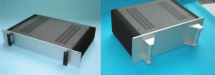

Thanks very much for the info:
I also saw these: Hifi 2000 - Boîtier dissipateur 400mm 5U - Facade 4mm at € 215
Silver or black:
They are of Italian origin, I understand
