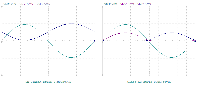

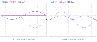

Just sharing some fun.
Looks amazing, I think this needs a new name, maybe call it Class B ?

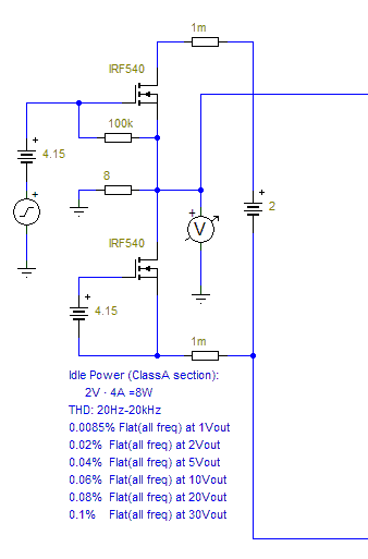

Umm.. but it is fixed biased, at around 5A not a variable biased amplifier, and it still draw 5A when idle. This amount of current is double of normal push pull classA that only need 2.5A bias for equal output power.
No one using this one because it need twice idle current compared to normal classA. They love their power and save them.

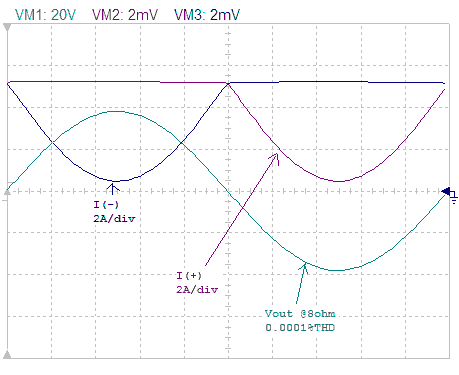

The first picture, 5A dissipated only from 1.5V

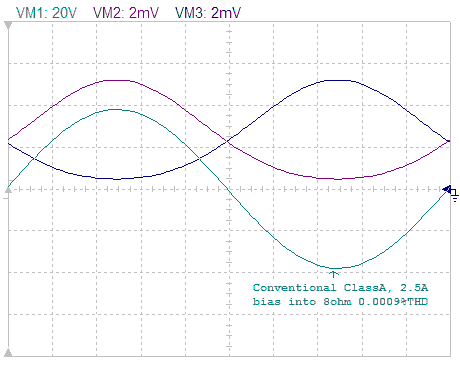

With conventional classA it need 3V supply and 8A idle current for best result, I am not in canada, so I reduce the power wasted as low as possible, up to 0.5V supply used.
When supply less than 2V classB-like classA has better linearity than normal classA. I am still investigate it
I attached the result of common classA in 1.5V and 3V with 8A bias.

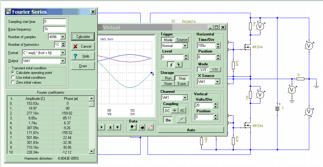

This series amlpifier is very old and ever produced as classA+, and I see that nowadays classA is still HOT like what it should be. May be something wrong with this series connection or something else. I am interesting to try one with little differences, classB input is now from output of classA. With this quick tracker:
http://www.diyaudio.com/forums/solid-state/182663-fast-simple-driver-hexfets-linear-use.html
