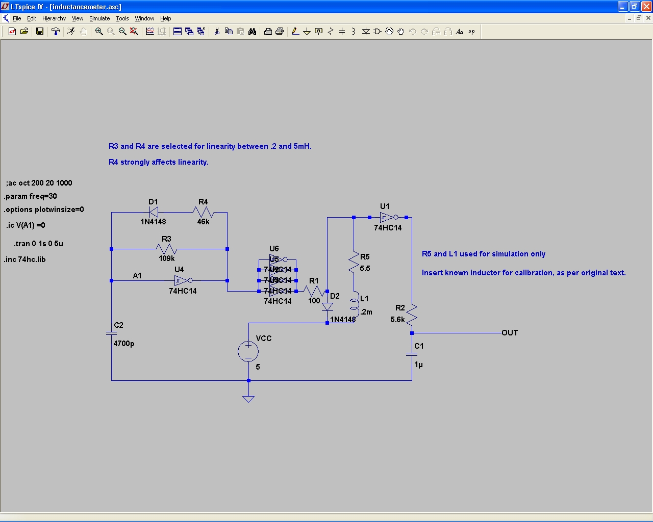

I slapped together an L meter for speaker range inductances. Not nearly the same league as this, but it fits in a tiny box somewhere near your DVM.
I got the idea from here:
Inductance Meter Circuit | Circuit Diagram
The "major" drawback is the test frequency and waveshape, but can probably get you within of a few percent of the number you want in any case. Pretty easily 1% if you're winding or modifying air core inductors.
The inverters can all be from one hex package, they're only different because I don't always use ltspice right.
