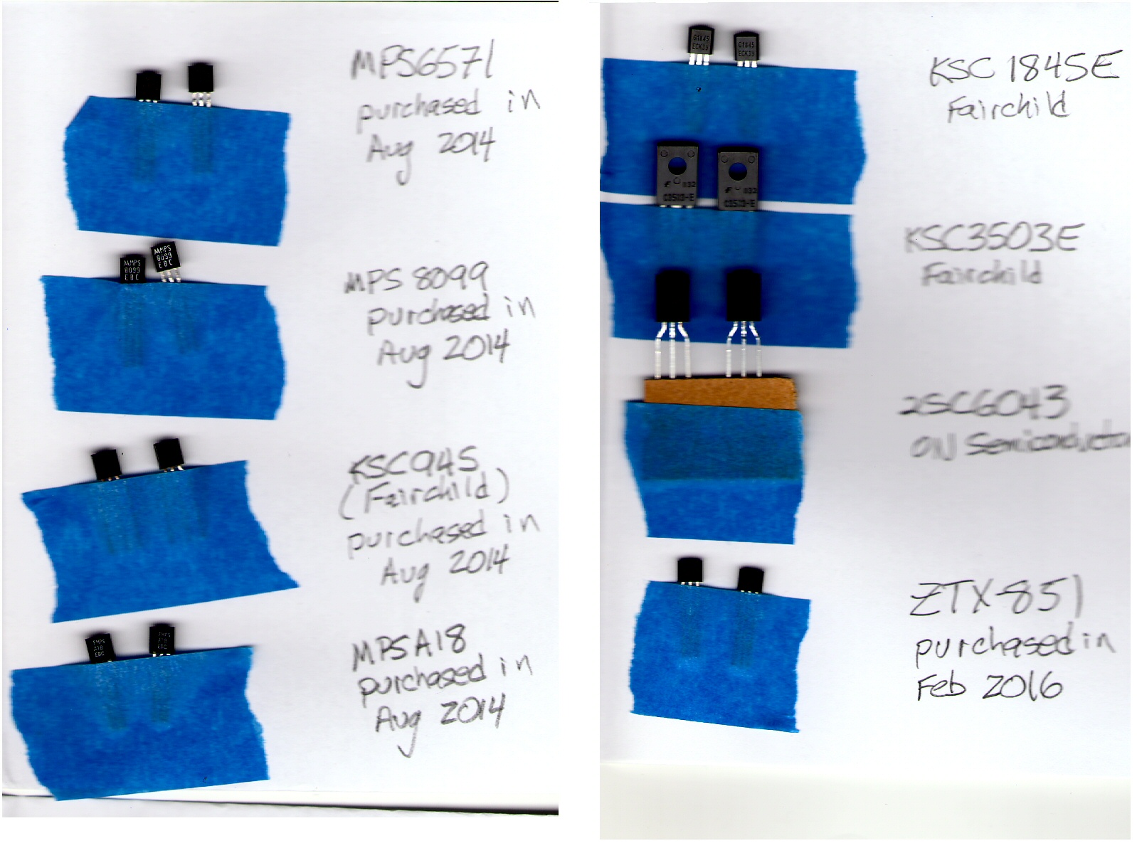

If you PM me your shipping address, I would be glad to send you a few samples of the lowest Rbb transistors that Horowitz and Hill measured, in their 2015 survey of 54 different BJTs (Art of Electronics, 3rd edition, p.501). I'll also toss in a couple of MPS6571s; these are the NPNs that Nelson Pass used in the Threshold M1 moving coil pre-preamp, and that he also used in the Threshold NS10 preamplifier phonostage and line amp stage. Datasheet attached.

If you PM me your shipping address, I would be glad to send you a few samples of the lowest Rbb transistors that Horowitz and Hill measured, in their 2015 survey of 54 different BJTs (Art of Electronics, 3rd edition, p.501). I'll also toss in a couple of MPS6571s ...
Sent today: 16 samples.

Horowitz and Hill report rbb = 1.67 ohms for the ZTX851 while you report 84 ohms, that's rather a large difference.
That's worrying: as I don't suppose H & H used heavily simplified measurement methods and gear like I did, my figure is most probably incorrect.
I probably went one or two simplifications too far.
I'll have to review the possible causes for such an error.
The direction of the error is unexpected: most simplifications and errors should in principle result in a measured value lower than the actual one.
Among the few plausible culprits are the self-heating and the emission factor.
The thread will return on the back-burner for the time I investigate....

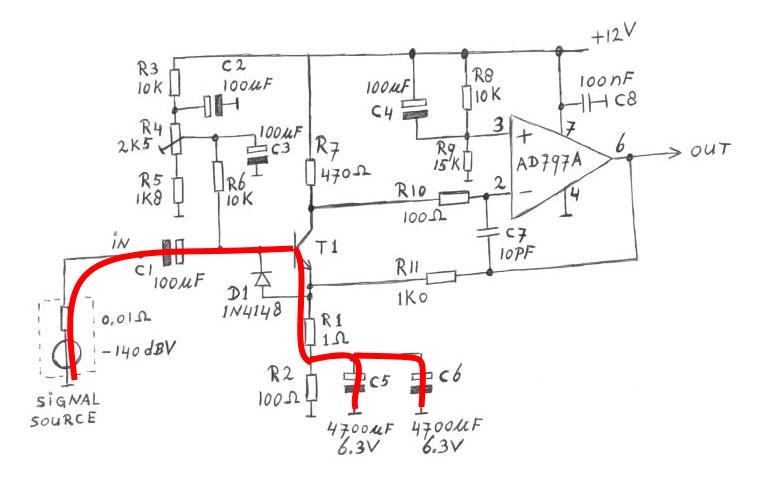

Elvee,
What do you think of this method of measuring Rbb based on the transistor voltage noise? I saw this circuit years ago but had questions because some transistors advertised a low Rbb had high voltage noise.
It is a known and recognized method for measuring Rbb, but as shown, it is simplified and only gives approximate results, but even the full accuracy method cannot be 100% accurate, because there are excess noise sources unaccounted for.
Of course, all external methods of measurement for this parameter use some kind of approximation.
No, I had hoped for an illumination, but so far I have seen no light.
The ideality and self-heating fixes I added work as intended, but some higher order effects still pollute the measurement, and I have no clue as to which might be dominant: the number of minor deviations mechanisms in semiconductors is overwhelming, and it's one that not taken into account by spice, because in sim, it works perfectly.
This also means that the sim is useless at providing clues.
I use a variant of this method as a sanity check, because although not very accurate, it is reliable and predictable (it provides an upper bound for the resistance value).
For relatively ordinary transistors, it is in good agreement with Horowitz & Hill results, but for the more exotic types, the discrepancies become enormous.
Maybe those transistors have extremely low Rbb and extremely high excess noise, or else.....
Yes, more or less.
This is the principle:
https://www.diyaudio.com/forums/att...lack-knight-base-spreading-resistance-rbb-pdf
The real thing needs to take in to account some practicalities, like the ability to test both polarities or the usability.

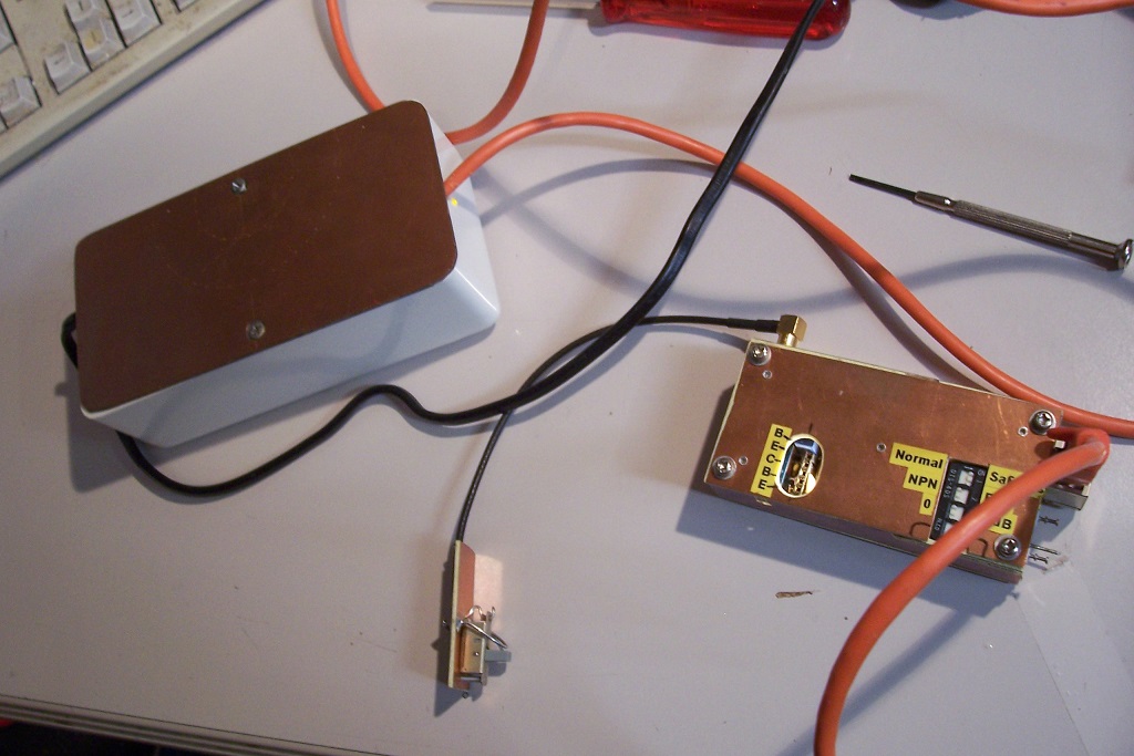

This is the complete tester, with an umbilical-connected supply:
attachment.php
This configuration eliminates hum issues.
4 switches control the configuration. The "safe insert" mode mutes the supplies, discharges all the coupling caps and lights the socket zone:

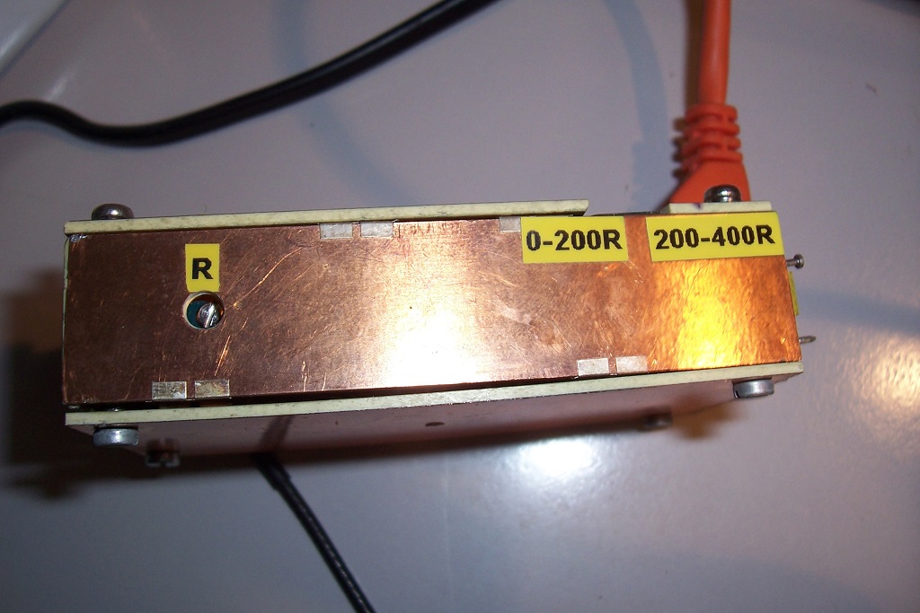

The input resistor is a 20 turn, 220 ohm trimpot:
attachment.php

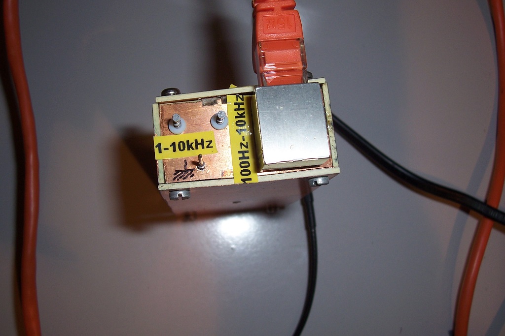

Two outputs are available, but further filtering is normally necessary:
attachment.php

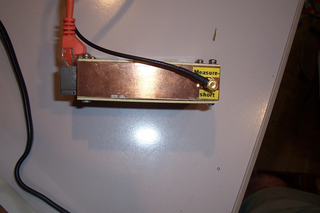

A connector gives access to the resistor value:
attachment.php

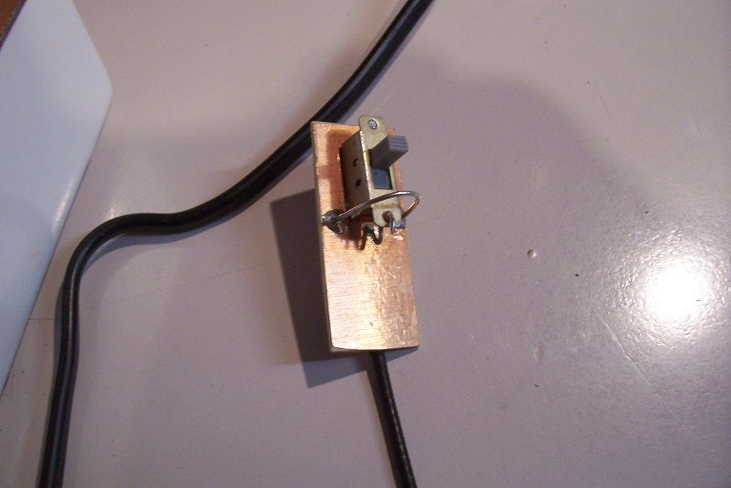

The switch shorts the resistor:
attachment.php
