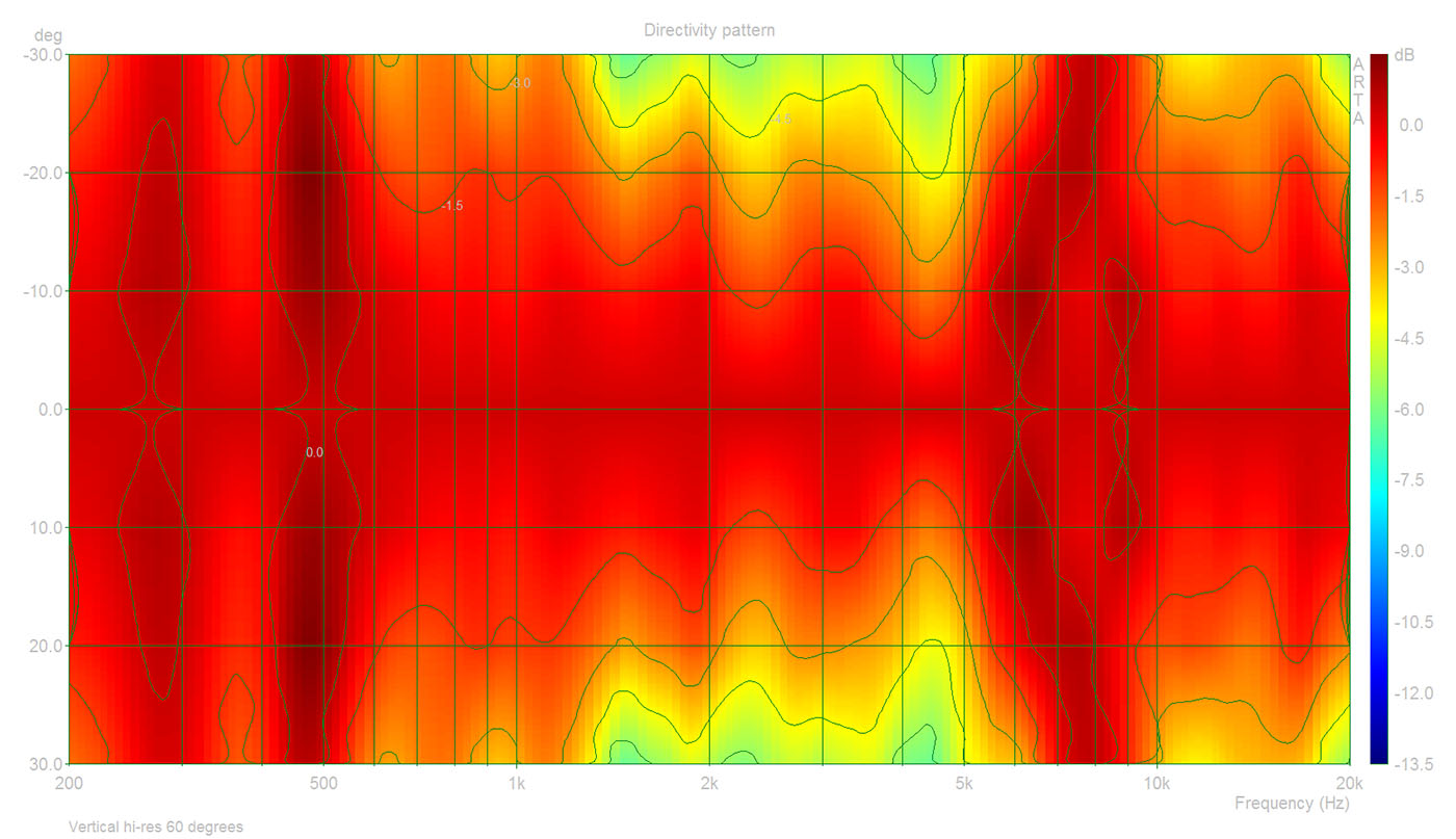

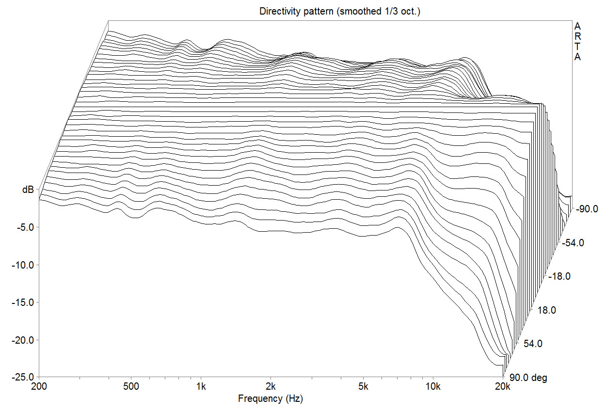

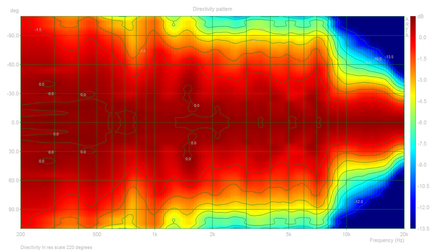

One of my criteria for xover frequencies & slopes is so the directivity changes doesn't change across the xover.
I was doing 'controlled directivity' since the late 70's. The papers I quote all bear on this.
Would you like to post what treble & bass/mid units you use with 2.5kHz xover and perhaps some off-axis responses of the units and the complete systems? I'm seriously interested.
That's exactly what I said, two ways to do it: 1) waveguide, extreme example the Geddes approach. Problem is that you still have a sharp transition between the listening window, where the FR is relatively straight, and beyond that. 2) Other way is to cross over the mids before they start to beam, so that they are effectively in 4 pi radiation at xover. This is my approach, we can perhaps come back to why this desirable at a later stage.
This necessitates small mid-drivers and low xover frequencies. Does it work? Bet you it does. Please have a look at the following:
This is not your normal listening window, but a 180 degree measurement. Even at 90 degrees off axis, it is almost straight right up to 7kHz. The subsequent fall off is the natural beaming pattern of a 3/4" tweeter. For those who like colorful images, here is a directivity plot of the same speaker, but in another graphical representation:
This measurement goes from 0-110 degrees off axis (indeed, from slightly behind the baffle in the most extreme measurement).
Richard, I'd love to tell you which drivers I use, but I won't because of commercial reasons. The sizes are 3/4" for the tweeter and 2 1/2" for the mids in a d'Appolito configuration. The trick is in the enclosure, based on an old patent, with a new patent pending.
Vertical dispersion is pretty decent, but not completely to my liking. Even a 4th order filter keeps the mids going on for too long, resulting in a bit of suck out. Yet, the vertical listening window is about 30-40 degrees, which is not bad, but I want to get it better by using steeper filter slopes. This will require FIR filtering. Last picture:
Please note that these measurements are relatively old ones, and improvements have been made in the meanwhile. Time to book the anechoic room again and get some fresh data.
