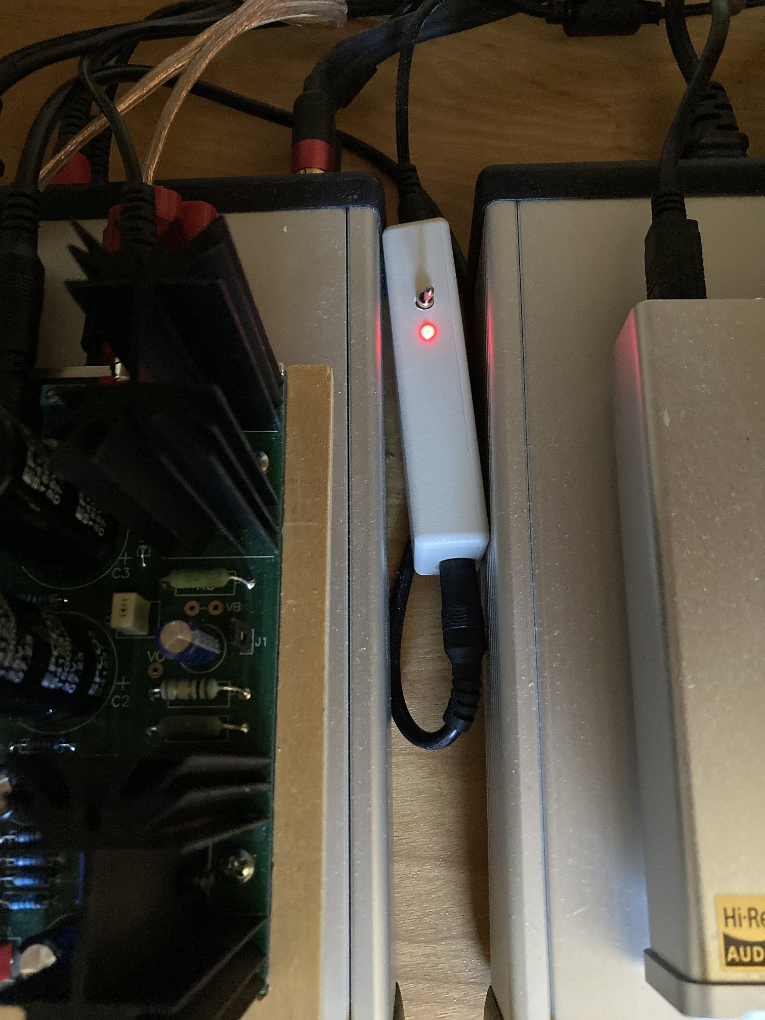

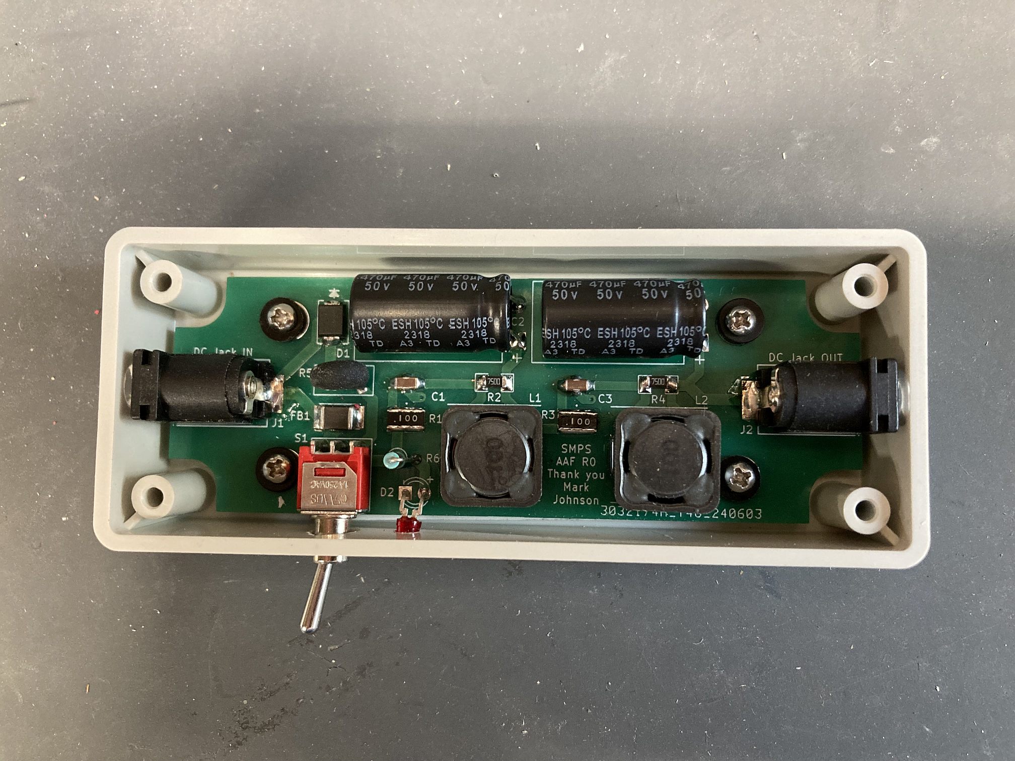

I recently put together a second ACP+ using the AmyAlice.
The two units are virtually identical, but one is using two PO89ZB boards in series and the other is using the AmyAlice.
The AmyAlice unit sounds better. Without going into audiophile terminology, the sound is more relaxed and seems to be coming from a blacker background.
The P089ZB is still worth building if you are not up for minimal SMD soldering. The only hard part for me was that third leg on the C1/C3 caps, but only because my eyes are not what they once were.
I had the same experience using the AmyAlice.

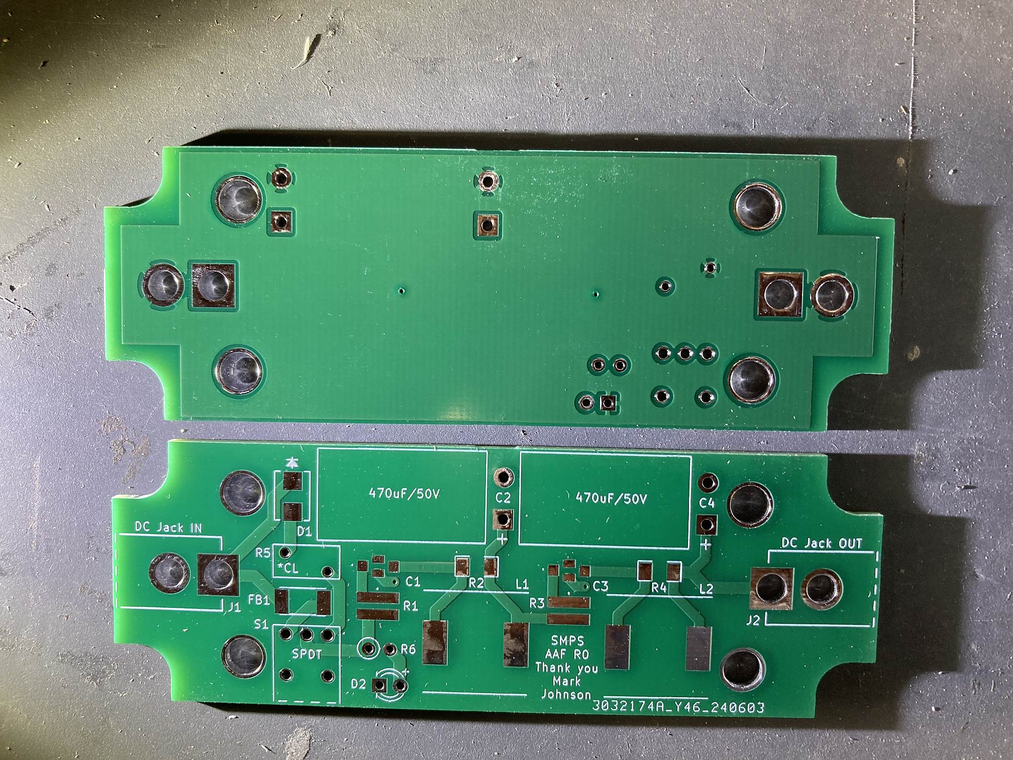

- Power Supplies
- AmyAlice: DC filter for SMPS, using 2 feedthru capacitors + SMD assembly. max 3A & max 48V
