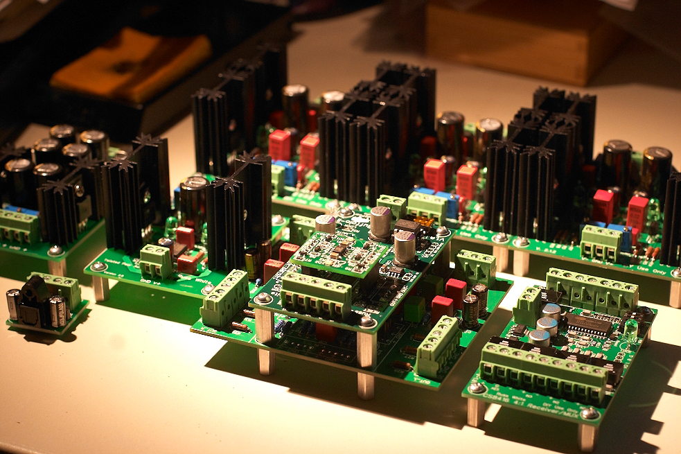

Wow, what is all that? Do you mind going through all those juice deprived circuits and giving just a short description?
I recognize the Buffalo II by TPA, but what is the rest?

It's all TPA indeed. Went a bit overboard with the power supplies . Although the small print is not the Volumite but the optical receiver. First I'm going to hook it up to the Aleph P which I'm currently building, so I'll use analog attenuation.
