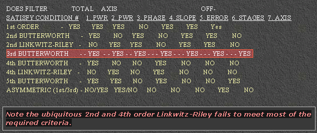

On Auratron - Components and Systems 3PX8 ELECTRONIC CROSSOVER DESIGN PHILOSOPHY there is an interesting table which summarizes the characteristics of various Xover configurations. The visual formatting of the chart needs changing though

OK, let's take a step back for a minute to try and see the bigger picture here with respect to loudspeaker crossovers.
If you want to be accurate, you will need a more accurate model of the driver(s). So far (I believe) you have modeled drivers as second order HP stages. This is a first approximation, however, drivers have a bandpass character meaning that you need to add to that a LP filter (typically 4th order) to approximate the upper end behavior. Herein lies the problem with approaching this from the electronics side: every driver model has different HP and LP behavior, and this would still only be an approximation of a real driver because it does not include cone breakup, effects from mounting the driver in a cabinet (e.g. baffle step type effects) and so on. So what you have is electrical modeling of the crossover filters, so you are missing some rather important aspects of the real world system. A loudspeaker system includes other important issues that relate to the quality of sound reproduction such as the finite excursion capability of the drivers, their frequency dependent distortion characteristics, interference between the soundwaves propagating outward from each driver depending on the relative phase angle at any observation point in space, the position in three dimensions of the acoustic center of each driver, etc., etc.,etc.
Essentially, modeling like you are doing with SPICE can only take you so far and to design a loudspeaker (the reason for the crossover in the first place) you need to start taking measurements on an actual system FIRST and then subsequently design a crossover system based on the measurements. The fact is that once you throw in all the driver and system related issues the conclusions obtained from crossover only modeling are no longer all that valid, really. As an example, the main premise of the SPICE studies is to examine how the crossover filters sum together. That is all well and good, but without the acoustical side (the drivers) you are skipping over some rather important points about a loudspeaker. You MUST know driver phase (including propagation delays, etc not just HP LP modeling) to begin to say anything meaningful about a loudspeaker crossover and how things sum together, which is I believe what you are trying to model. Some important aspects of filters, like group delay, don't seem to be known to you.
This is exactly the problem that I had, and still have, with the approach taken by Douglas Self in his recent book "Active Crossovers for Loudspeakers". He is an excellent designer of electronics, including crossover electronics, however, in his book he steps through an active design without any good model of the loudspeaker driver (e.g. the frequency dependent phase behavior) as if assuming that phase of a driver is 0 degrees for all frequencies. Not even a novice loudspeaker designer would make this kind of mistake. All of his electronics designs are excellent but his loudspeaker crossover design approach as described in his book is suspect. He doesn't even mention anything about driver phase, so I have to assume that he doesn't know much about the subject and how important it is to know that accurately in order for the driver responses to sum together in the desired way.
I see some of the same type of mistakes in your work, JrmEng. Your SPICE modeling is fine, but you are pursuing electrical models to the nth degree without taking into account some other rather important aspects of loudspeakers. This is the source of my chagrin, not an attempt at character assassination as you have mentioned. Again, since you are designing a loudspeaker crossover and not just a filter network for electrical purposes, your simulations only apply to a small portion of the crossover design problem. Another example of this is worrying about amplifier distortion, which is on the order of 10-100 times smaller than driver distortion, or less. Measure the distortion in the acoustic output of enough drivers (home audio types) and you will see that driver distortion just isn't very low, especially as SPL level increases above 90dB@1m, which is not super loud by any means. Driver distortion nearing 1% THD is not uncommon! As an example, Doug Self mentions that he laughs any time someone objects to using a 5532 op amp, because he knows that the signal passes through hundreds of them on its way through the recording chain. That's right, hundreds of op amps! Is one or two more going to make that much difference (if designed and implemented correctly)??? This is a device that has less than 0.001% distortion, around one hundred to one thousand times less than a driver.
What I am getting at here is that you might want to take a step back and put your modeling into perspective with respect to the overall task of designing a loudspeaker crossover network. What you have done is certainly valid for the electrical filters, and you have started to add in some characteristics of the driver to your models. But you are still a long way from the complete picture, which unfortunately doesn't lend itself to general modeling because it is driver and system dependent to a large degree. I've done this as a hobby for a long time, and I have written some free tools for designing a crossover system based on driver measurements. These are coming from the other direction compared to your efforts, that is they assume ideal, lossless and distortion free filters in the crossover network. Loudspeaker system design involved both electrical and acoustic modeling, so we both have something to add to the mix. I'd be happy to share my modeling experiences with you, as long as it is used for DIY purposes. For commercial purposes please contact me to work something out.

Well and good, but the original post is not intended to analyze the complete xover-driver interaction, only to demonstrate the characteristics of various xover implementations as a starting point and expose many common misconceptions.

Let me be blunt then, many of your "conclusions" are at best suspect and at worst wrong because you don't include key details about the drivers or loudspeaker system in your models. Obviously you can't do that because you are only doing SPICE modeling.
You can not take observations from your electrical modeling of filters and apply them to a loudspeaker where things will be very different because there is an entire acoustic side that you do not account for. You say things like "The sum of the total power radiated by each driver (must be considered)" but you have a completely useless or missing model of the driver radiation!
You seem to assume that the filter output that is directed to this driver describes what the driver is doing in the acoustic domain in terms of power, phase response, etc, etc. Nothing could be further from the truth.
