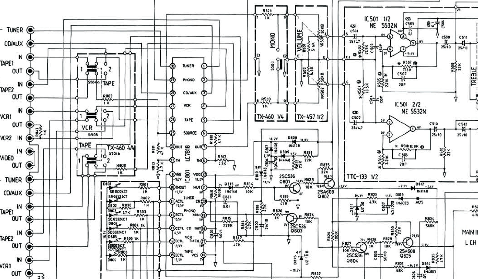

I have an acoustic research A-06 amplifier, when I change the volume there is quite a bit of noise on the left channel as I move the knob, it's motorised however I do not use the motor as I lack the optional remote control.
This noise also seems to throw my 12" woofer cones in and out in a way that is slightly concerning, though once it's left the amplifier functions perfectly, the noise is only produced by the act of altering the volume.
I was pondering just taking it apart as best I can and cleaning everything I could, is there anything else you could suggest that could remedy this issue?

This can also happen if there is dc flow through the pot. Like if it's a dc coupled amp , a slight dc offset in the source can cause a very noisy pot till things settle down. Sometimes it might not settle down. For this problem you need to use a decoupling cap which is another major issue. What value and what type/brand and how many dollars !
It could also be dc from the stage following it ! Try to look at the circuit diagram and see how the stage is designed.
Then of course it could be just particles from the track or dust which needs to be blown off by air or a non condensing spray.

Exactly. In cases with dc coupling or by electrolytic caps with internal residual transition resistance cleaning of the attenuator is not enough. In case of used electrolytics in front of the pot and behind of the pot replace this parts through foil caps. By dc coupling pots cut the wires and introduce foil caps (consequently dc coupling in amplifier set-ups from the source to the loudspeakers I hate in general).
Then the shoot-noise during rotation goes away.

Download a service manual from
ElektroTanya | Service manuals and repair tips for electronics experts
C501 and 502 after the volume pot are probably worth replacing with new parts.
Hope I found the right schematic!
Regards
Martin

After a third attempt at cleaning with spray and a look at the tracks they don't look dirty, I'm starting to suspect this is something else as the right channel is perfect yet the left is so very wrong, the solder joints looked ok and taking the pot completely apart looked like it'd be quite a bother.
This problem also seemed to happen suddenly, there was no gradual creep in just suddenly it started doing it. As I mentioned earlier the noise makes the bass cones throw themselves out in a frankly scary way that I never see when listening to music within sane volume ranges, it makes me think that somehow higher voltage is getting in there somehow, definitely something way out of the range of line level audio.
Put back the pot or put an equivalent resistor in place ( with slider and top of pot connected together ) and see if there is a dc voltage on it when the amp is powered up and if so does it drop with time.
Compare both channels. If there is nothing, then probably the pot is just bad !
Try using external wires to wire the pot terminals to the pcb so that left and right channel sections are reversed. If the problem goes to the other channel the pot is surely gone. If not ,look elsewhere ......like above ....
