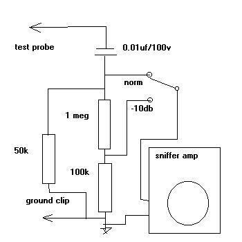

if you use a signal sniffer amp, make sure you include a 0.01uf/100v (or higher voltage) cap between the test probe and the sniffer. remember some of the points in a DC coupled amp are within 0.7V of the rails. also since everything after the VAS stage is at a much higher level (the usual voltage gain for a 100W amp is 30), you might want to add a 10:1 voltage divider in the input of the sniffer as well. when using a sniffer with a cap on the input, you need to provide a discharge path for the cap, that's what the 50k resistor is for. remember to short the test probe to ground after checking nodes near the rails to keep the cap from causing large spikes when you test one point and move it somewhere else (remember you have a charged cap in line with the probe). in the drawing below, the switch is for switching between direct and -10db attenuation. with normal signal levels being line level and higher, an amplified computer speaker will work here. it's best if it's battery powered, but a wall wart powered one will also work.

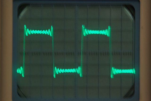

yeah, looks like the crackle is not coming back any time soon.. i've been running it solidly into a big pair of speakers for hours/days. so in the meantime i put a 10KHz square wave in and got this at the output of both channels..
this is not good, is it? is this oscillation? remember the output stage now has MJ21193G/MJ15024G as drivers and MJ21194G as outputs. not sure what i need to do to stabilize.
The schematic is on page 2 of this:
http://www.crownaudio.com/pdf/legacy/psa2schematics.pdf
