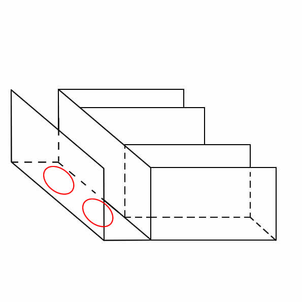

Thanks for your replies. It is definitely made for 240 VAC, as it was made in New Zealand. The heatsinks consist of a flat piece of aluminium sheet bent into a large U shape with the two output devices mounted on the bottom, and to one flat side of the U there are two more similar heatsinks mounted lengthwise. Hard to explain clearly, so have drawn a diagram that hopefully better explains it.
Pretty simple, 3 bits of sheet bent in a U, the ends of two of them joined to the side of one. In the diagram, the dotted lines show the edges etc, and the two red circles indicate the position of the two output devices. There is one such heatsink assembly per channel.
Model number is National NM27-114. Its a nice looking amp, and I was going to start the process of replacing the DIN connectors with RCA's and binding posts, but then I noticed how hot it was getting. Compared to the likes of a Musical Fidelity A100 which has a similar output arrangement designed to be biased into class A and uses the entire case as a heatsink, the heatsinking on this amp is pretty minimal.

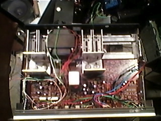

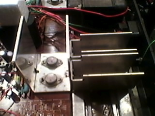

Okay, I have a uploaded a few photos of the amp. Sorry the quality is not very good, I only have my phones vga camera. Should give you an idea of what it is anyway. In one of the photos I have put a green circle around where there is provision for a trimpot to be mounted, with the two resistors in place.

from power supply and heatsink view there is no chance that this is a class A amplifier
reason for "over biasing" could be any shorted transistor or capacitors ...your amplifier is too old so one way or another capacitors will need to be replaced
you also need to check if there is offset in the outputs that will also be an indication of trouble
photos you placed are to small to see anything from
kind regards sakis
