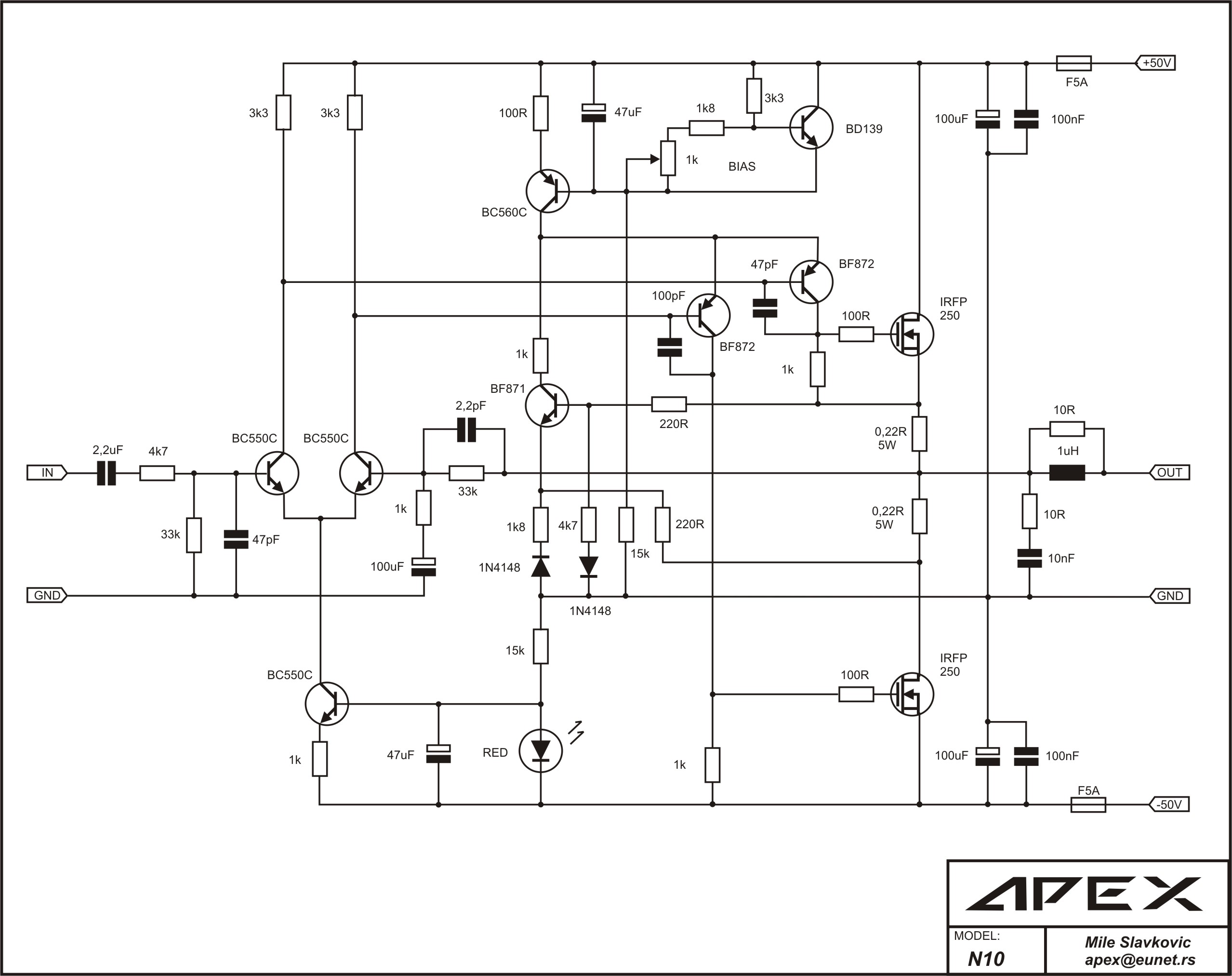

The RC circuit which is in paralel with one side of the current mirror
should be suppressed.
Although the amp become instable without it, it is the source
of a hard rail sticking in the negative going of the signal when
clipping occur...
Anyway, i wont go further in simulations, as it s time consuming,
and the design need a complete rework, sorry for apex...
Thank for your time Wahab, there is no point to use this topology for quasy complementary Nfet output stage.
Well, i think that this RC circuit with the current mirror is not
good even with a darlington output stage as it will also produce
a rail sticking when the amp is overloaded, so it would be better
to find another mean to make the amp stable, whatever the output
stage..

MOSFET Amplifier with IRFP250. BD139 on heatsink with IRFP250 for termal stability.

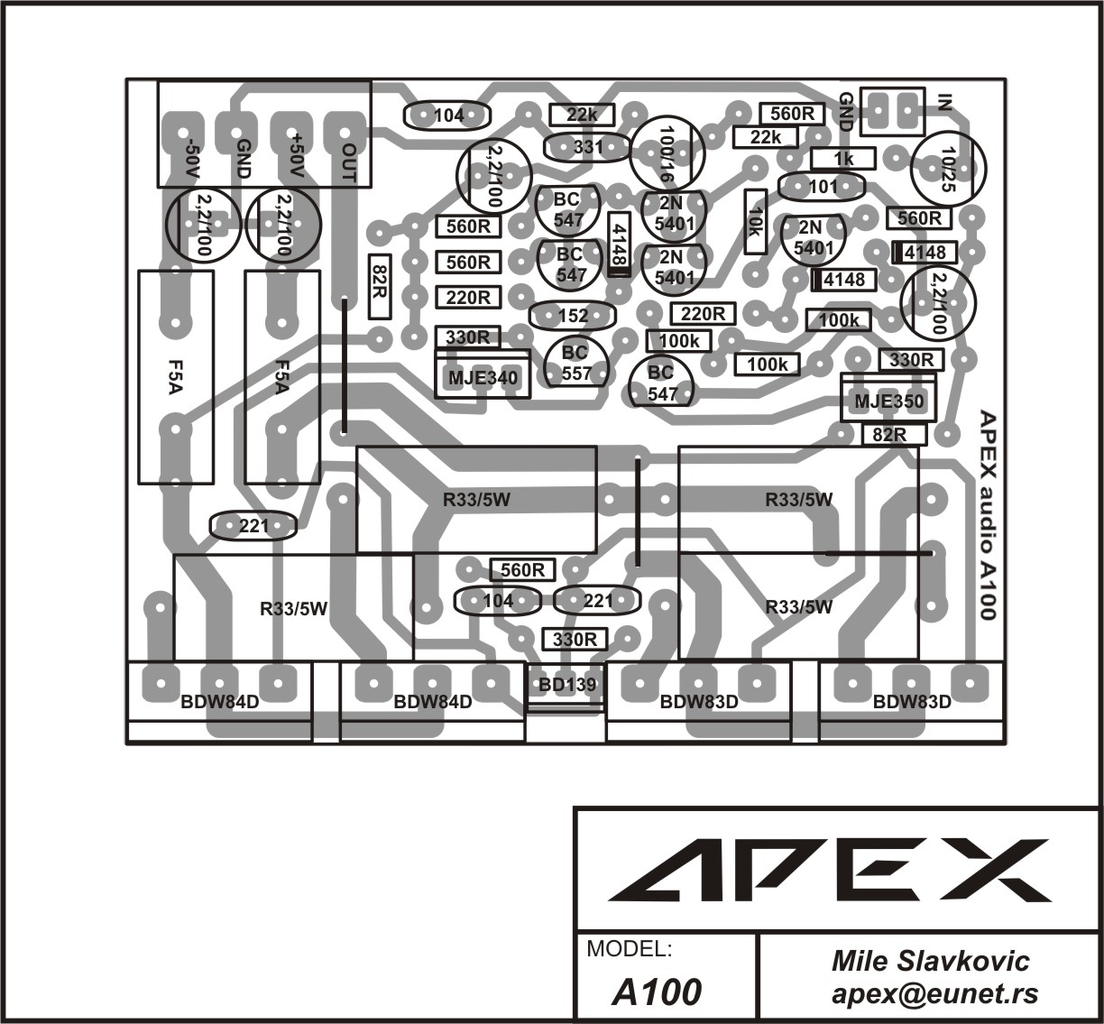

waiting for the PCB design.....:)

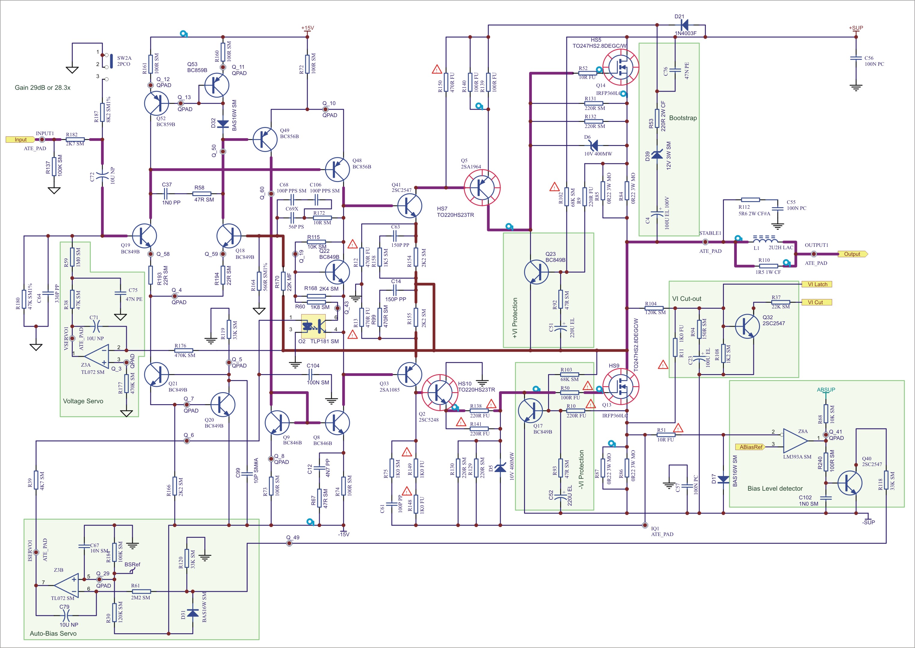

Output stage for 'Amplifier Motherboard' work in class E with tracking dawn converter for rail voltages. Rail voltages for outputs is +/-6V DC, and converter increase rail voltage with input signal up to +/-120V DC, and thats mean over 90% efficiency like in class D, but with class AB sound quality.
Power will be 1800W with only 4 pairs of outputs + mosfets for converter.
I will share schematic soon.
