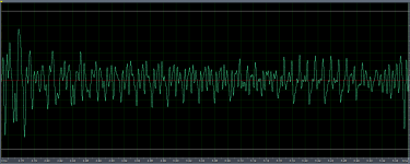

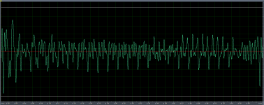

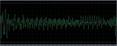

I've made measurements of this type before but never bothered to investigate too much or post them.
here's the thing. 2 amps with pretty different sound. the measurement is made at the level I normally listen at, that is ~9V RMS with full-scale sine input (4 ohm, 83 dB W/m speakers, impedance equalized, 4x5 m room, listening position at ~2.something meters away from the speakers plane). I've used a song which is especially revealing wrt sonic differences.
one of the amps has average harmonic distortion (3rd order harmonic @-50dB, the rest vanishing pretty rapidly) but I've tried to simulate something similar in software and it doesn't seem to explain the differences (quick math confirms it, at 20W in 4 ohms THD is ~0.2%). the other one has considerably lower distortion.
oh, and the load was the actual speaker playing music.
so, here are the 3 time-domain pics. amp input vs outputs of both amps. the outputs were low-pass filtered at 250Hz to eliminate phase-shift issues at high frequencies due to different corner frequencies.
if it's not already obvious, both amps are flat in that band (<250Hz).
first interesting question is, which of the two is the better sounding one? 🙂
(try to view the files with IrfanView or a similar viewer, and switch from one to another in order to see the differences more easily)

Your low-pass filter may have wiped most differences. In any case, time-domain differences will be mainly due to slightly different frequency responses, which is why people use FFT to get a spectrum instead.
sorry, but I don't see how that is possible. I agree, maybe I'm missing something but at this point I don't know what that may be. "slight" (how slight?) FR variations translating to huge time-domain variations? are you sure? have any quantitative example? 0.5dB means a 5% difference on a linear scale.Your low-pass filter may have wiped most differences. In any case, time-domain differences will be mainly due to slightly different frequency responses, which is why people use FFT to get a spectrum instead.
first, I would say the time-domain differences are huge, I didn't need a looking glass 🙂
second, there are no significant freq. response variations (mentioned in the original post).
and, speaking of which, guess which of the 2 amps has the FR that most deviates from flat? 🙂
are you sure you switched from one pic to another like I described? (amp in vs A, amp in vs B) using the forum pic viewer is useless unless you're very patient.

ok, looks like we have a dud.
it took a while because I wanted to redo the measurements properly.
I think it was the measurement setup that caused the huge unexplained time-domain difference.
now the time-domain plots look pretty much identical, as expected.
it was worthwhile though, I did some frequency-sweep measurements and it's really intersting to slide the cursor in CoolEdit and see how the distortion spectrum varies with frequency and how it rides above mains-related peaks.
it differs quite a lot between the two amps.
