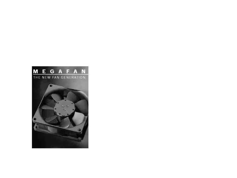

Thanks Kenny,
Well the best is yet to come.
I will shortly refer to equations for the thermodymanics of the enclosure, particularly if you are like me and aim to use the existing enclosure, thus the solution as Mr Pass put it is "In a word FANS".
However, its not that simple and the selection of the right Fan requires some calculation for the correct operation of the fan and the desired level of cooling with the box.
My investigations so far lead me to believe the total energy losses with the box (less the heat sinks) is in the order of 100 watts worst case scenario.
This includes the transformer losses (based on manufacturers data), and PSU11 simulations for rectifiers and the chokes under the X Aleph operating conditions.
For practical purposes, if the maximum temperature of the toroidal transformer insulation tape is 105 C and the temperature rise is 60 C under full load, then the highest allowable ambient temperature inside the box is 40c worst case scenarion.
Given that it is summer in the USA and the air temperature has been in the order of 102 F (38 C) in the Reno area recently as I understand it, then you will have a problem if the box ventilation is not designed correctly.
The technology in fans is such that devices with noise levels of 12 dba are now available from at least PAPST, and while for absolute silence no fan is best, reliability is an over riding consideration where a big bang and then dead silence in the middle of a your favourite tune is frowned upon!
macka

Regards fans here is an interesting post from another thread:
Correction!! Post #46
Quote:
Originally posted by JDeV
Actually I thought everything over again, did some calculations and decided (after reconcidering your comments) to reconnect the fans, but replacing the existing "out of old PC powersupplie" 1's with the highly aclaimed (and highly )
Papst 8412NGL fans. ...BTW - these new fans are not really much an improvement on the noise issue, IMO Expected much more for $30 worth of fan.
These fans, Papst 8412NGL , ARE very silent - if you mount them correct. I made mistake to mount them inside "cages", which cause alot of "wind noise" not from fan itself but from air being sucked through holes in cage. Apologies to "Mr. Papst" - if there is somebody called that I also dropped the fan supply to just 10Volt, which made them virtually completely noiseless.
