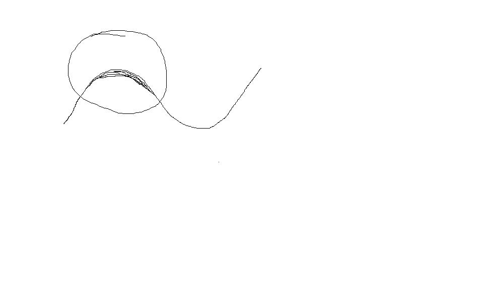

Hi Every one!
I found some problems in my previous circuit.So that I am trying another one ,this time the amplifier out put showing some distortion in positive peak.But negative peak is ok.I am hopefully
waiting for your clarification in this regard.

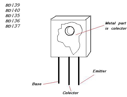

Give a second check in the transistor leads.
Check transistors to have sure they are connected correctly.
Good luck
regards,
Carlos

Hello Carlos,
Thanks for your suggestion. Once again I verified every thing on my circuit board.But still I getting the signal on CRO with distortion.Now I am attaching the file of what type of problem I am getting actually.I hopefully waiting for your reply.
Regards
Madhu.K

Have you mounted the diodes together on the same heatsink as the Bd139/140 transistors? (hard to do this i know)
I dont really like that circuit. I would prefer higher emitter resistors.. 0.33R or so and get rid of those diodes and add a Vbe multiplier instead :)
You also might have oscillations because of the tight local feedback loop in the CFP output. Have you made a PCB of your own or did you buh from Rod Elliot (the site)?
Significant question because it is a CFB circuit. The PCB layout can be a factor. Sometimes it is hard to determine why there is an oscillation and when you finally cure it is can be a puzzle to figure out why the cure worked. This is similar to the P3A and I assume that Rod has worked out the peculiarities on his PCB.
First suggestion: re-melt all the solder joints, a not quite perfect joint can act like "diode like" (per JLH), which is not a desirable trait. BTW this is much more likely to be helpful than the suggestions that follow.
Second suggestion: check your wiring layout to be sure the input signal wires are kept away from the output transistors and wires. This applies to the PCB layout as well if you made it yourself.
Third suggestion: Try increaseing the value of the Miller compensation cap (220pF) in steps. This is an inelegant way to deal with your problem, but sometimes it helps.
Fourth suggestion: Ignore the problem if you can get the fuzziness down to where it's not too prominent. People smarter, more experienced and more iknowlegeable than I have have written that small CFB oscillations are benign and do no harm. Considering who it is that writes this, it must be true ;) but it aggravates me none the less.
