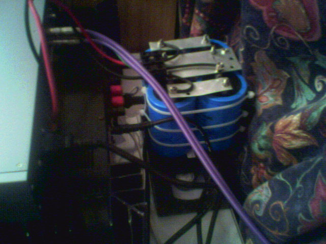

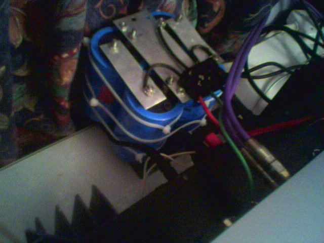

Hi again,
I decided to take AndrewT's advice on upping the supply capacitance for this amp. There wasnt any room inside to add additional capacitors and the replacement ones from electronics suppliers (47/56/68/100000uf) at 100V were too large to fit in the case .
So i took 4x Philips 10000uf 100V caps i had spare and wired them externally via very thick wires.
The amp now has a much more respectable 76000uf of capacitance (i also replaced the bridge rectifier from a 25amp to a 35 amp one to be safe).
havent had oppertunity to crank it up to listen for improvements yet, but theres bound to be at high levels.
