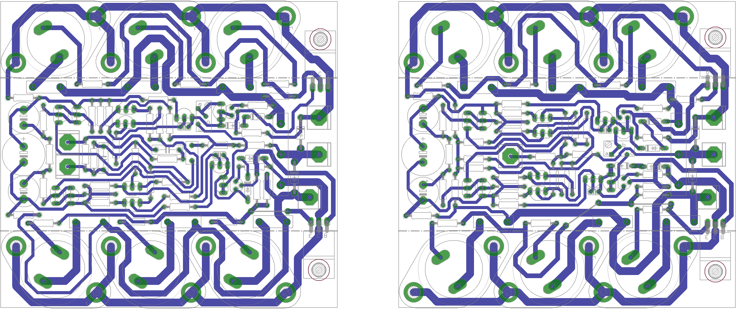

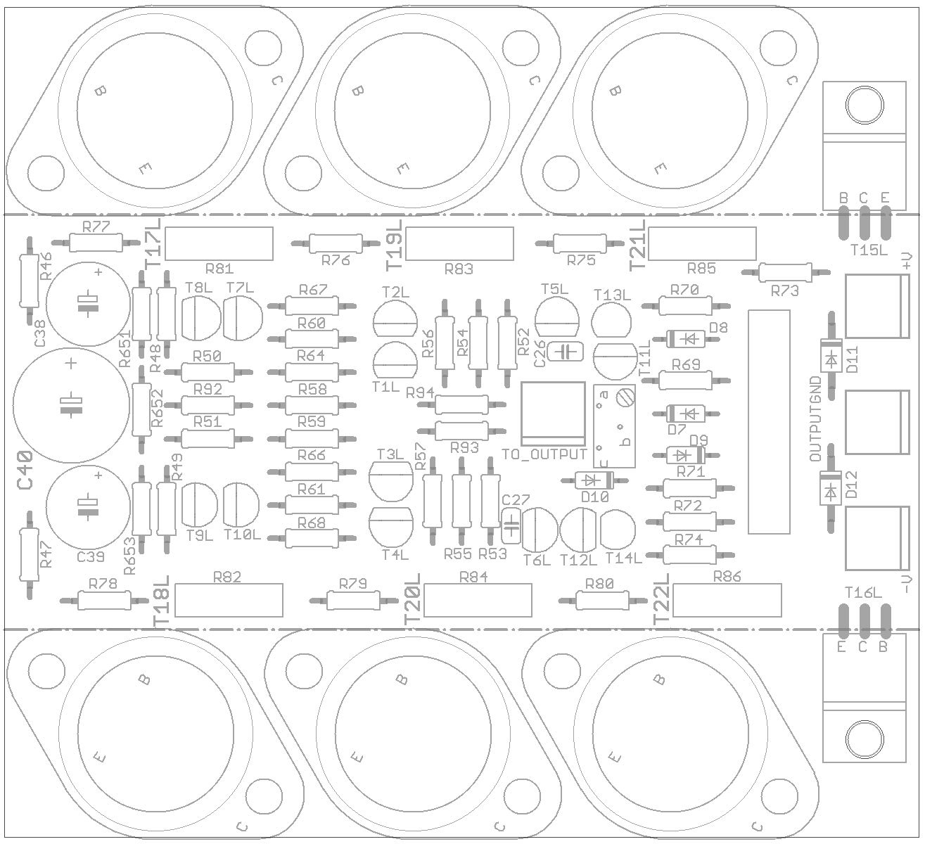

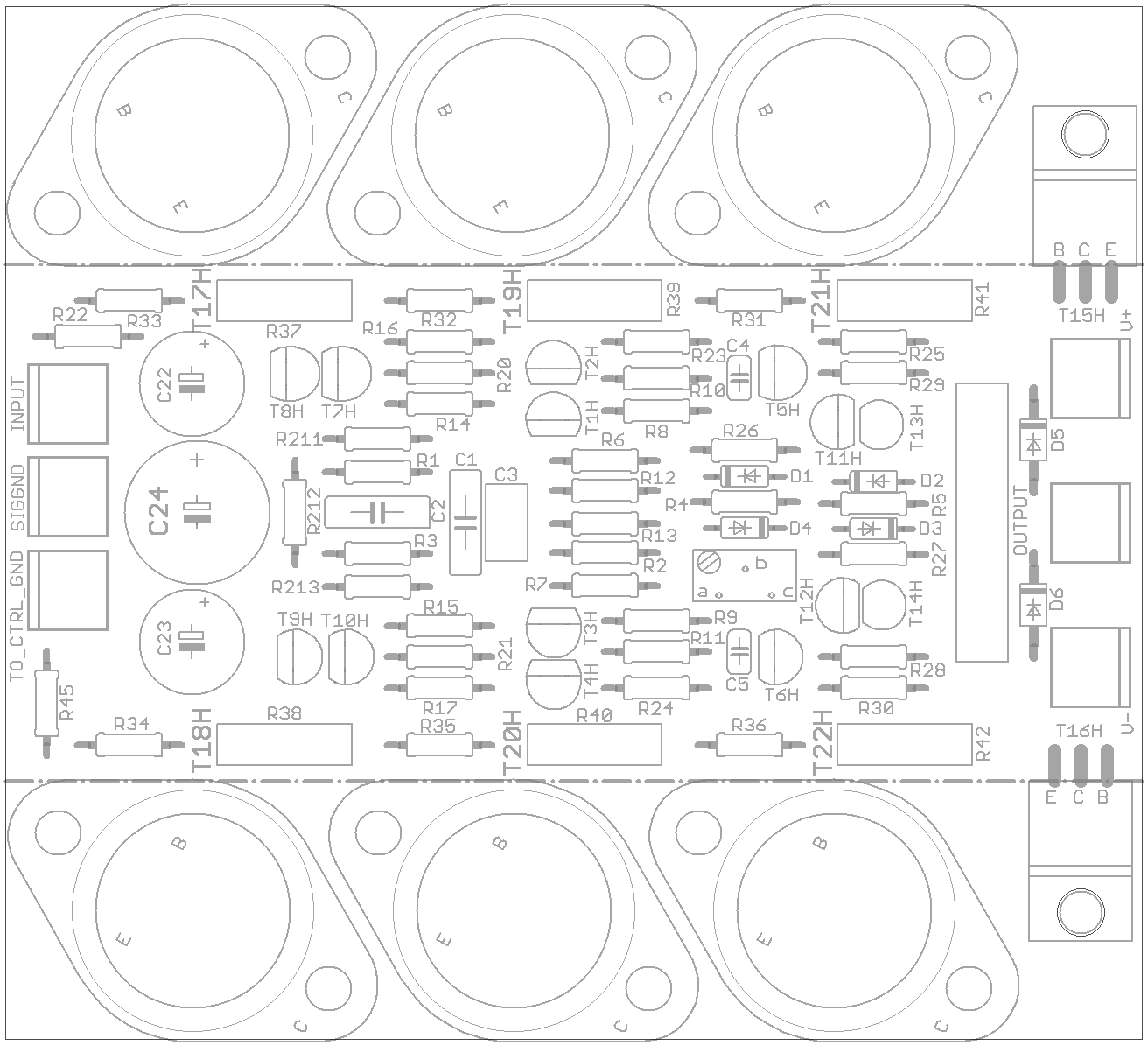

Here it is! A single sided layout for testing the prototype.
I wanted to have a minimum trace width of 25mils (1mm) and a clearance of 20mils, so the space got quite tight in most places due to the wide traces and wide spacings. Plus I wanted as much as possible to avoid straps. So I had to make some compromises, with a little smaller traces in the small signal areas to get everything closer together so it could all fit. I wanted also to keep the board sizes as small as possible, so since I started with 100mm x 110mm and having all the TO3s on it, which avoids wires as much as possible, the parts placement was nicer in the beginning but then I was forced to move things around a bit to allow those wide traces to pass.
I kept the psu off the boards and made on board for each amp side, so here are 2 boards, same size 100x110mm, and single sided.
This should be good enough for testing and proof of concept.
I will look into adding the protection networks now.

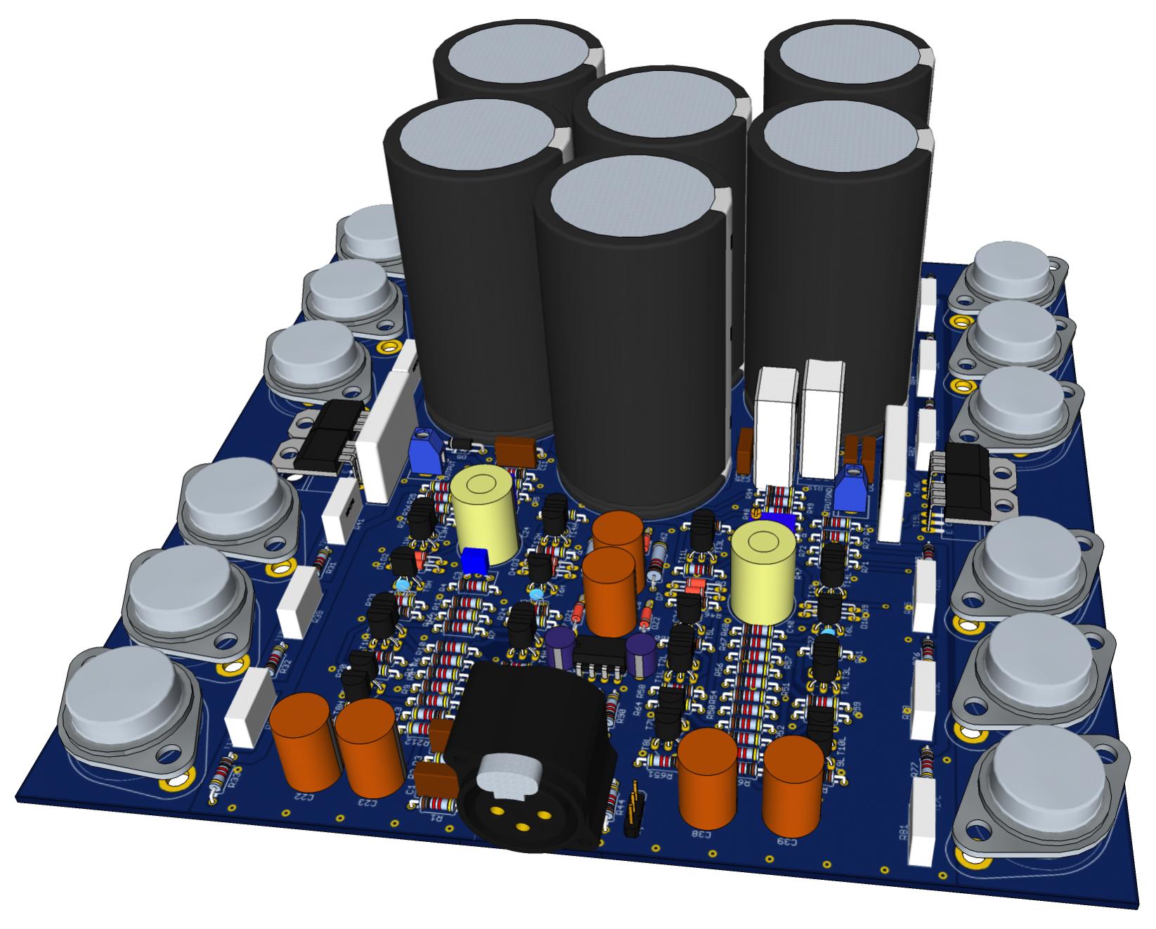

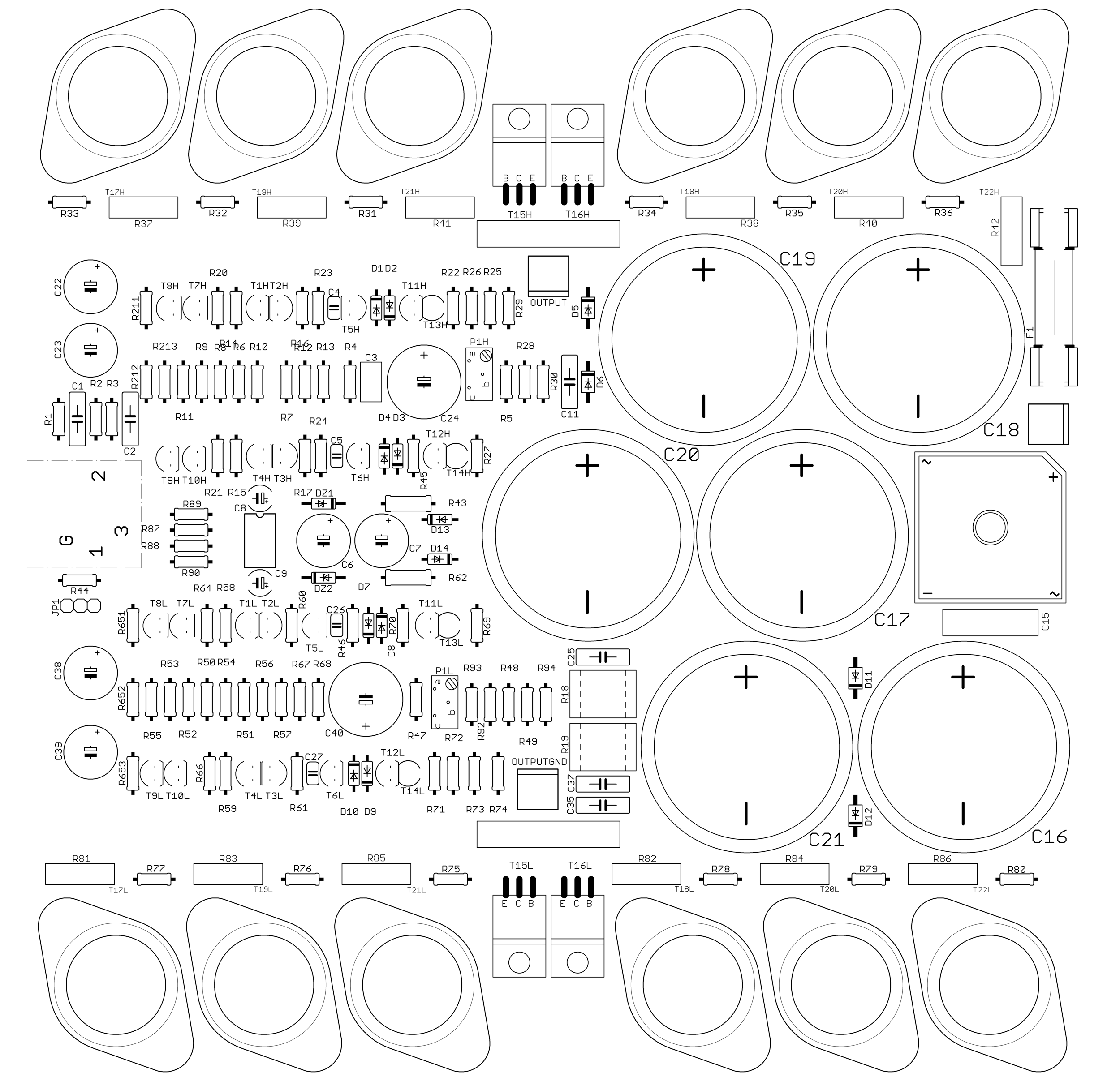

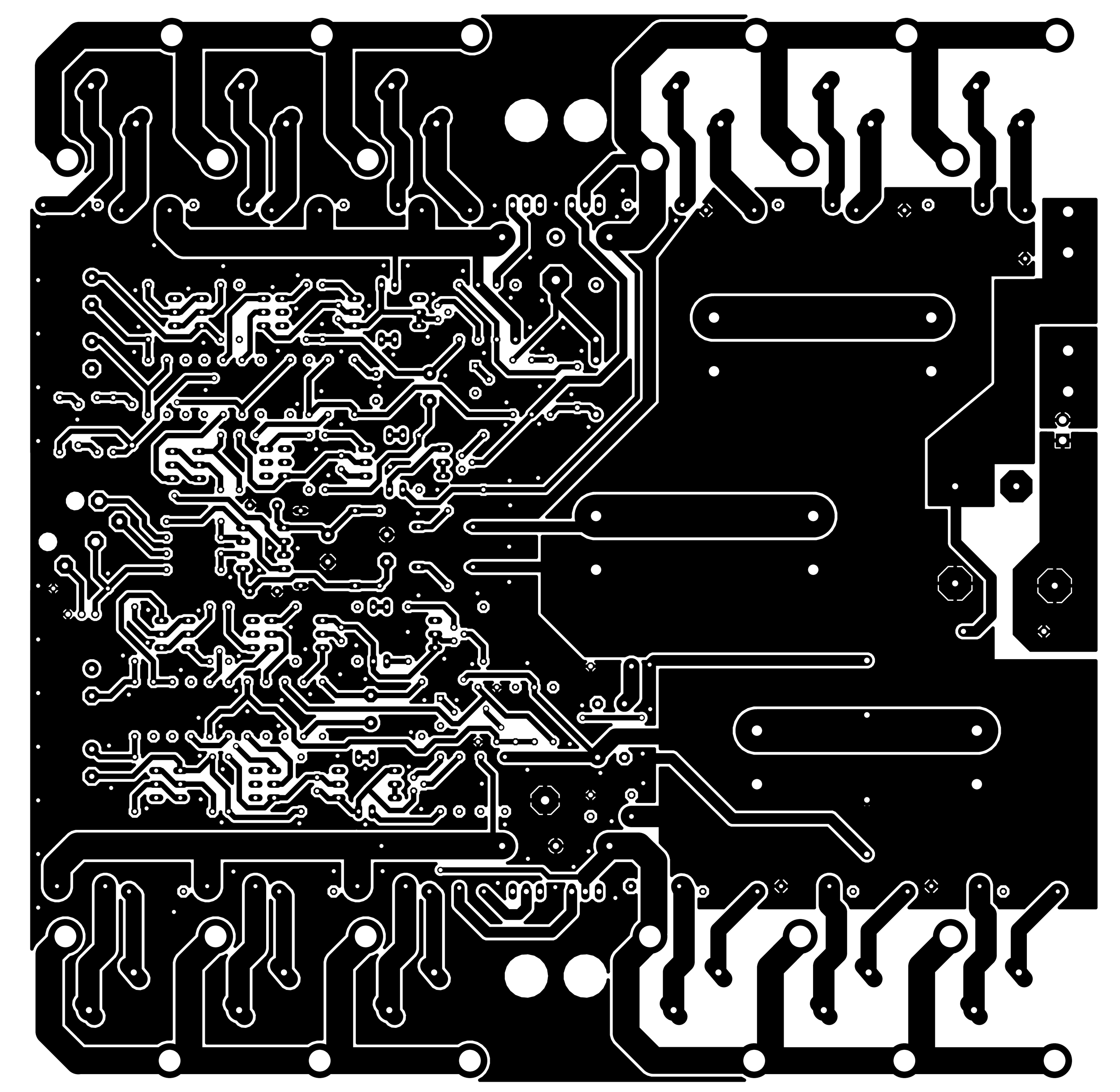

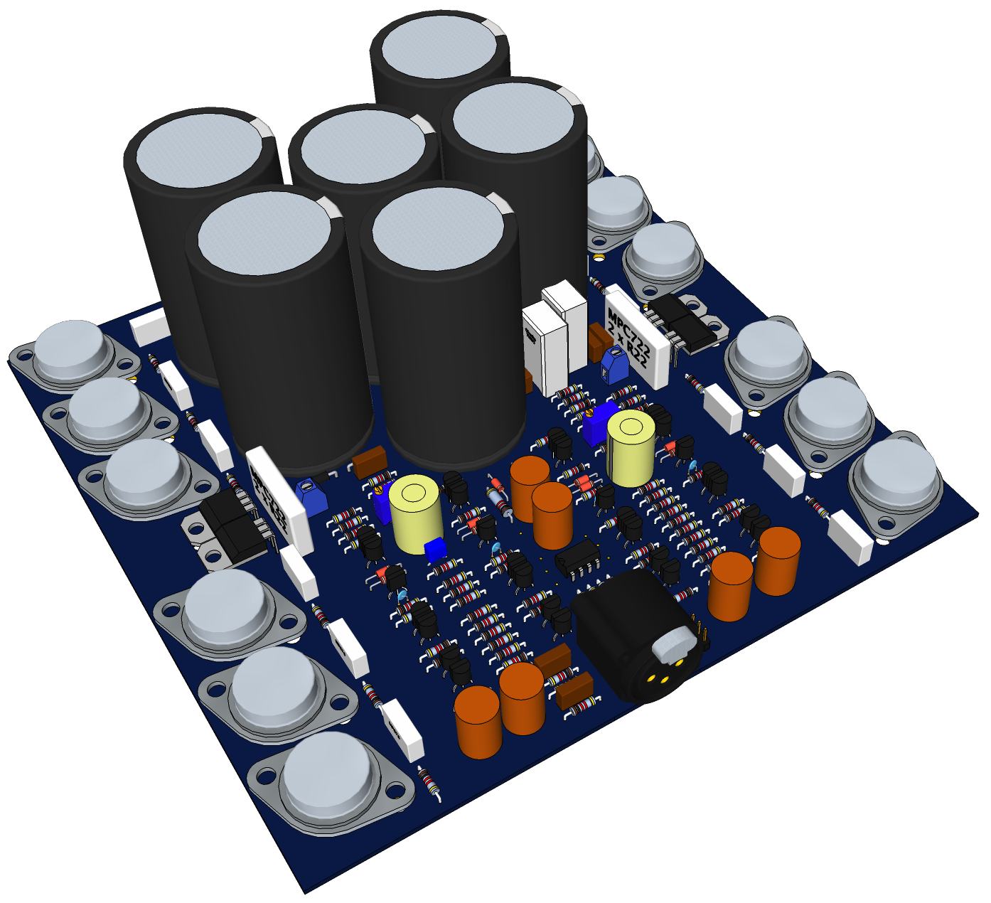

For the main pcb design, here is the current version without the protections.
Board is 200x200mm, double side plated through.
I hope there is enough room to squeeze the protection networks in there, otherwise we have to increase the board size.

I would suggest putting the design of the main board on the shelf for now, finalize it only after the prototyping as you will likely end up seeing the need for further changes.

I will look at the double sided layout now, and we'll see if we can add protections later on too.
The board size choice was driven mostly by having the TO3s right on it, and 3 TO3s in a row is about 100mm, but since I wanted to slap the drivers on the main heatsinks as well, then I had to go 110mm long.
Perhaps going double sided can help bring down the 100mm width somewhat, but then again, if we add protections, the room spared by going double sided might just be enough to include those without going bigger.

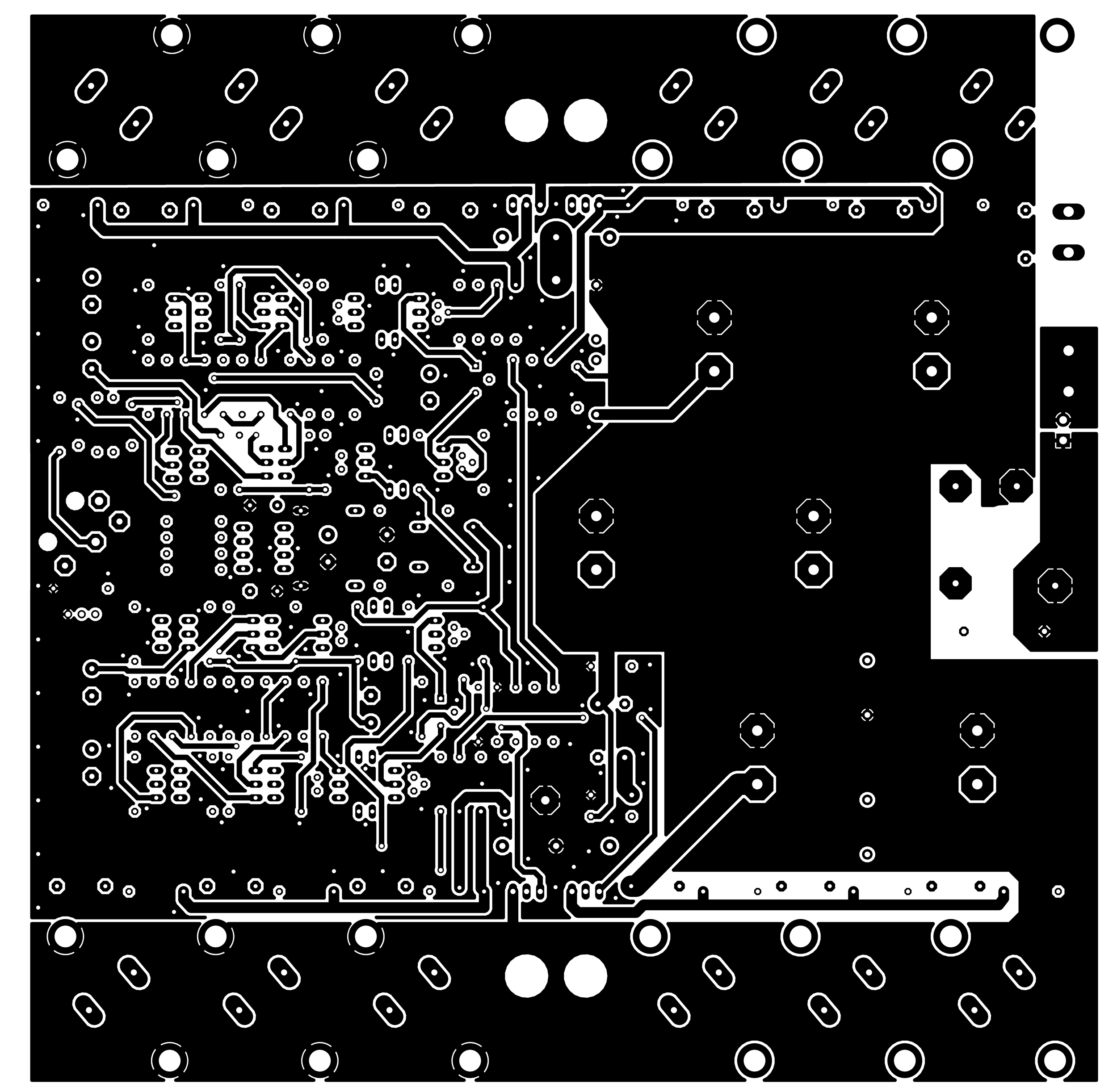

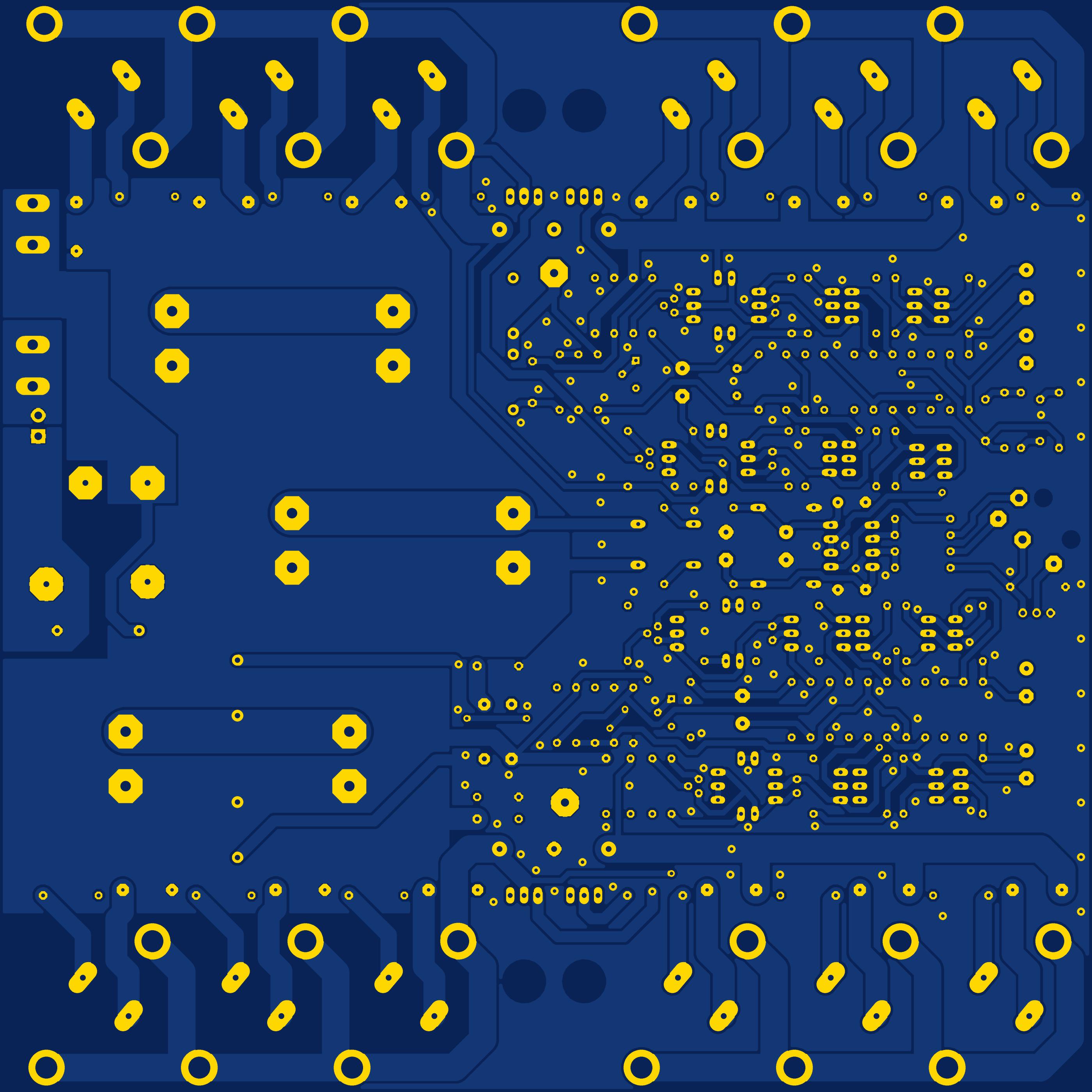

In the mean time, I just got done laying out the high side board for this project's proto. It's 100% routed but I still have a little work on it, and the other side is 30-40% done too.
I'm posting that first board layout now and I'll post the other views later.
I used ground planes and copper floods for the power and other things.
I also added an extra ground connection on the high side board because it makes no reference to it at all and the ground plane needed to be hooked up, so that connection would go to the central ground, which I think the best place must be the ground ouput on the low side.
That board was easier to route, although not quite so easy in some areas and I tried keeping wide traces and a good clearance, so although it's looking much better than the single sided, being strapped for space still caused a few issues in a few spots. Still it's not a bad looking board now. I'll make some 3D outputs when it's finished.

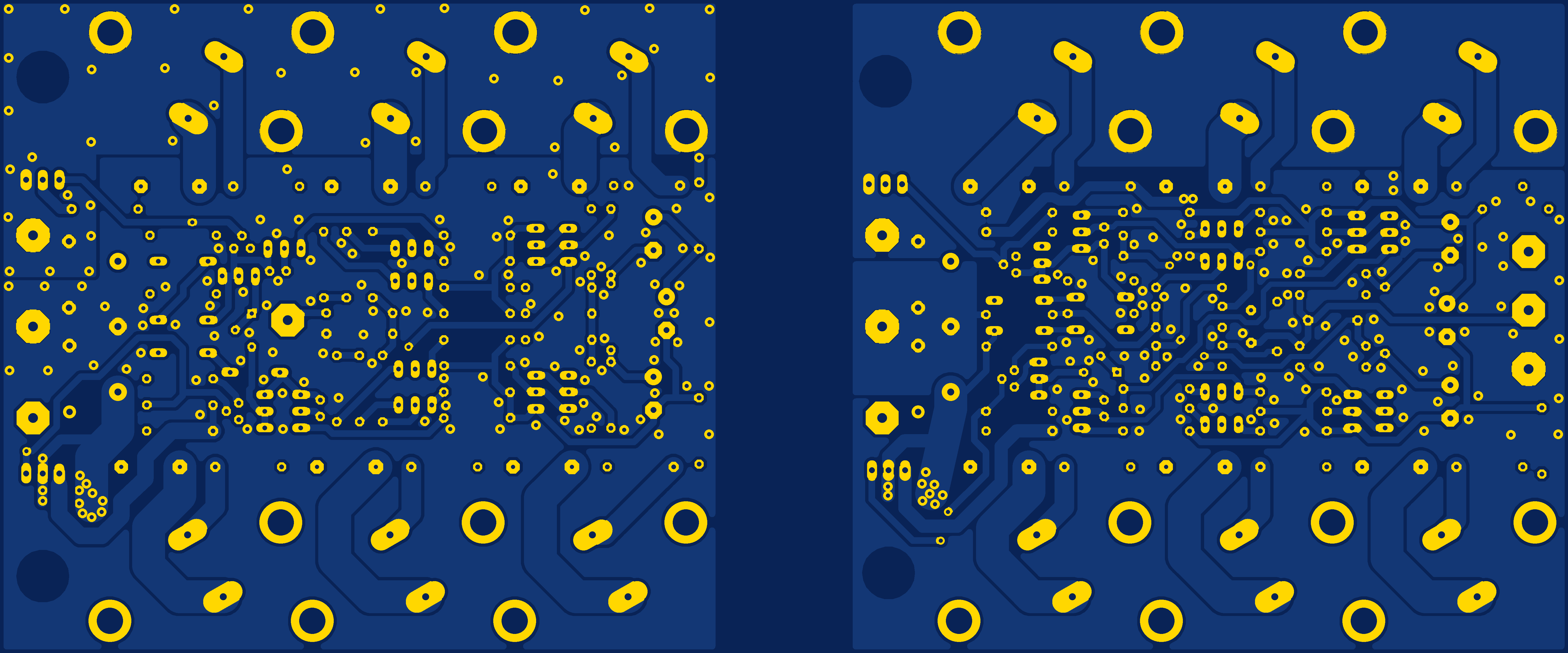

I'm not so sure how this will work right on this quasi, with the 3 transistors "pseudo-darlington" (not the 3 pairs), I need to find something that works.

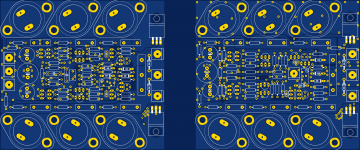

Here they are!
I layed them out together, so both boards are on the side panel/picture.
I don't include the components names on the silkscreen or it's overcrowded.
This should be scrutinized, just in case I left something out or made a mistake.
