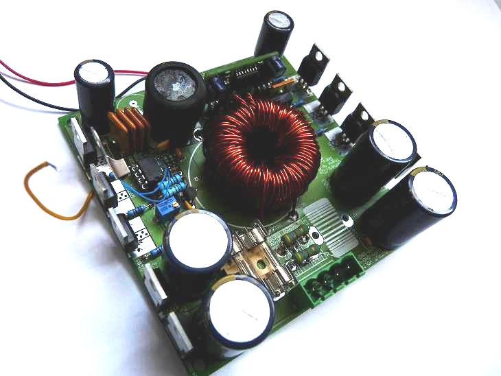

oh no, its know core, just BIG one, so I can have low freq, so that I max out 1mm wires on it... it has 6 turn primary and 20 some on secondary...its unregulated, just voltage limited... don't want to kill IC on amps
I would normaly go higher with freq. but since core is 63mmOD/36mmIN and 25mm high, with a lot of wire for primary and secondary, I have pretty damn rock hard output voltage, I only tested it for about 300w or so, since my moded PC supply wasn't to happy with 25A+ for any long period of time :)
Only battery could give me more, but that will be in car, since I don't really care how strong supply is, as long as it can hold voltage up for the amps to blast, that's fine by me

Yep yep, I am almost done, everything fine so far, here are few pictures

Ok so, since I have already posted picture of heatsink (part of case) here, all end it also here. So today I finished wiring all of the amp, minus the output from amp's to case output terminals, I'll do that soon.. Amp's are both working, PIC is doing its job, and man, do they have some nasty power to give and all this was with current limited 130w supply, this should be insane in car with say, 80A fuse :D
I designed my own board now, or actually, me and a friend did...

Ok so... I got 3 pictures, not the best I could take, but will have to do for now, since camera died on me (is in process of ...)
If somebody will want more, I try to find some other way of taking picture...
Taken from power and output side
From the side...
Output...
There are some changes that will come at a later date, but now itsmore of a test time, see what everything works every single time, for now it is...
Still need to put(and change) heatsink on driver IC's and I'll probably change from resistive load to get some min duty cycle from smps, to HV buck converters, that will have power from output of smps, so that there won't be heat dissapated in resistor network
