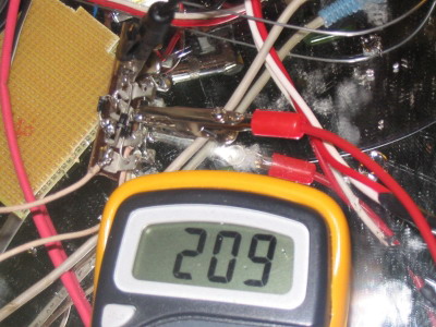

The valve socket seems to be ok...i don't get it. Forgot to say earlier that when connected to my house 230V line the plate read 24V. An improvement!!!! From line to anode there's the ss bridge, a 47 uf cap followed by a 330 Ohm resistor followed by a 100 uf cap followed by a 47k resistor followed by a 47uf cap and a final 100K resistor to plate. The voltage goes right until the final resistor but it reads ok so....
Now i'm lost and don't know what to check. At my wit's end.

the clue is here: as the filaments heat up the voltage drops slowly....Have 2 power suplies now and the plate reachs to 280V which is the correct value but when i switch on the filaments supply the voltage drops slowly to 140V. Yes before the drop was to 8V but i did rewire everything and found a mistake....had a 220 ohms cathode resistor in the triode input instead of the 330 Ohms which is the value that appears in the schema. That may be what has raised the voltage...so if put a bigger resistance in the cathode will i get more volts? The amp was working well with the original schematic. The 330 ohm resistor was there before and the amp worked at full potential now it doesn't.
Everything is ok so i must assume my OT went wrong. I have tried different valves and still the same problem.
What can it be?
I have checked all the resistors,they're ok. Could it be a faulty condenser?

changed the bridge, some caps....the same
went back t frank's advice and removed the OT from the circuit....only 20 Volts mor 140 less than it should be.

Alk,
Surely it must have something to do with to PS, probably one or more diode(s):
-you have 280VDC, your target voltage when the tubes are warmed up, when the tubes aren't heated.
This should be considerably higher as no current is flowing. It's as if they're not there.
So, the 280VDC could incidentally happen to correspond to what you'd expect to see with the circuit functioning normally.
-OPT removed, voltage goes up a little: normal.
-Assuming a diode is disconnected or dead the net result is close to what you're measuring and I suspect a high ripple level on the PS as well since it could mean the full wave bridge now works similar to a capacitively loaded full wave rectifier...
-If one of the PS caps is quickly losing its charge the voltage should get high first, then it would keep on dropping untill it stabilises to whatever charge it can still hold.
Either way, if you have replacement diodes and caps, I'd try them first then measure the ones you pulled to see which is faulty.

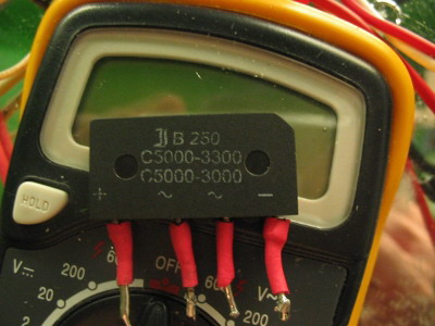

Thanks all for you help:
Karma thxs for the lnk i've read that before in my opinion SS bridges sound quite good. Still student no budget for tube rectifying.
v-man that would have been too easy.
Frank what is a capacitively loaded full wave rectifier? Seems i have one of those. Anyway was that the problem or is a new one? In the pic you can see the prior bridge and the new one which was made in a hurry but it's correctly wired. Should give 285 Volts. Maybe i did burn a diode...but what did burn the first one? Well tomorrow i'll buy more diodes and check again.

The type of rectification shown in your diagram with the PCL86 is a capacitively loaded full wave bridge rectifier (FWB or Graetz bridge). It's the most efficient type as it wastes the least voltage and current.
It also rectifies the full cycle of AC coming from the xformer as opposed to a half-wave rectifier.
