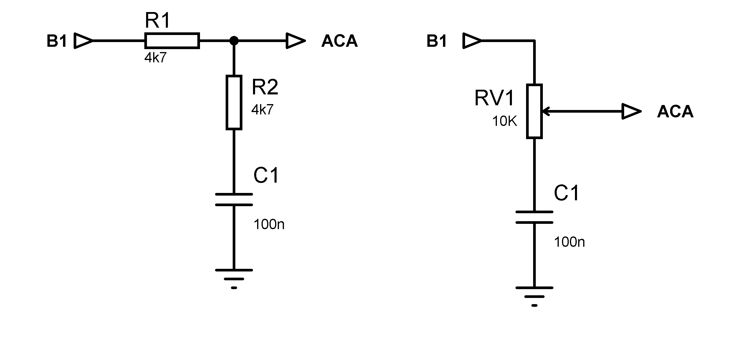

I was wondering if there are any nice little tone control circuits that I could build discrete components or one that would even just roll of the treble in a nice way. Or perhaps there is something that would mimic a phono RIAA preamp EQ but for a line level input. I could then switch between source direct and EQ with a switch.

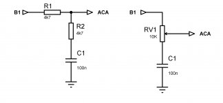

My first thought was to use a couple of resistors and a capacitor as shown. the size of the resistors and capacitor determine the tonal balance, and that is up to your taste. If you are using a potentiometer instead, you may find a setting that suite you.
