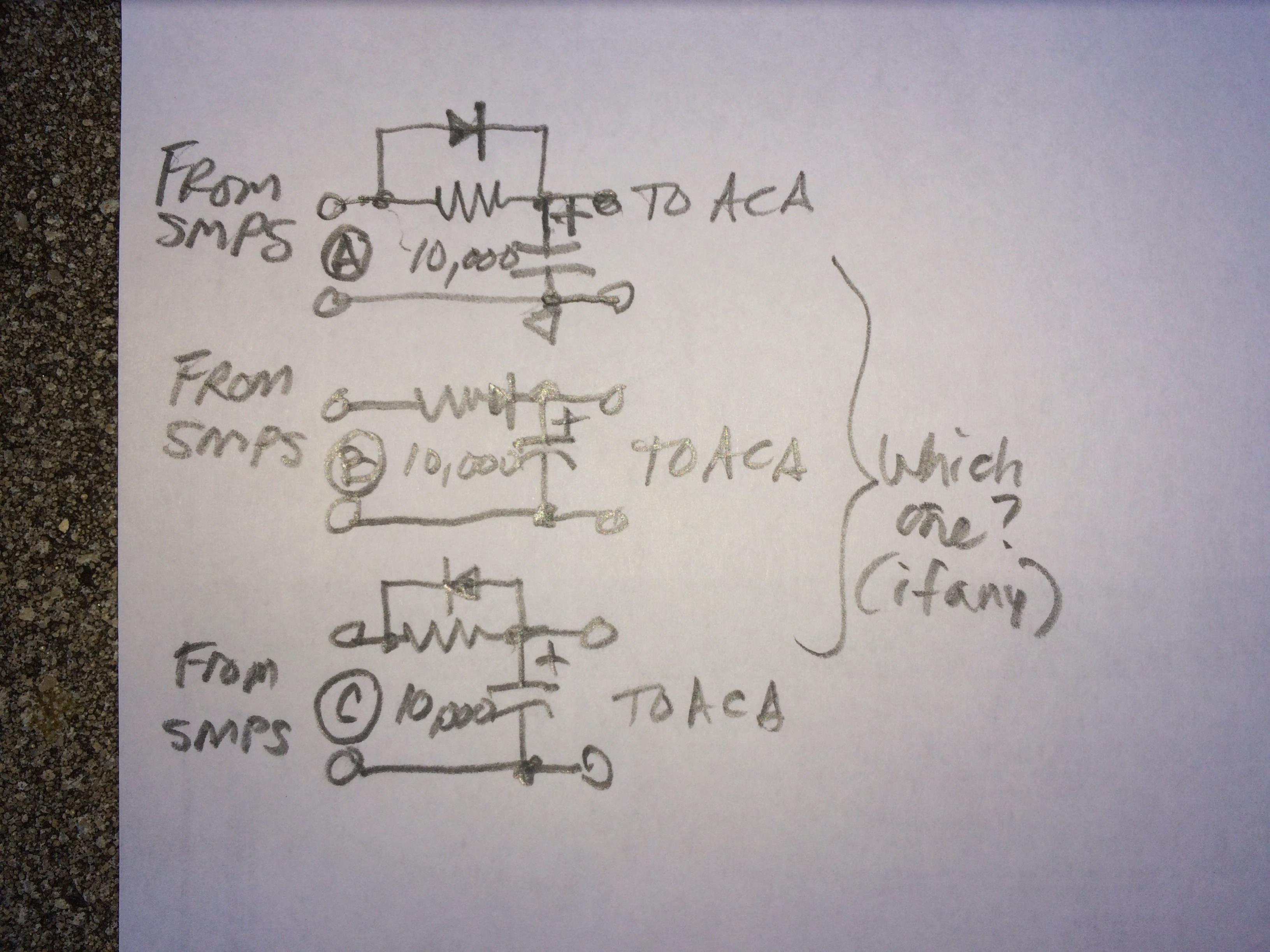

I am trying to imagine how to arrange the resistor and capacitor.
The three ways I could think of are drawn below:
Which, if any are what you had in mind?
The ACA switching supplies I have seen will charge a 10,000 uF cap. If they
don't there is a simple addition using a resistor and a diode to provide slow
charge for the cap.
An LC filter with lesser values of capacitance will still help with the noise figure,
so feel free to try it.
The diode need to be anything 50V PIV or higher and 2Amps or higher. The resistor needs to be 39 Ohms 10 Watt. The cap perhaps 100,000uF 25v. The cap charges up slowly when power is turned on. The resistor limits the current to keep the SMPS happy. When the SMPS is turned off, the diode turns on and discharges slow enough to de-thump the ACA.

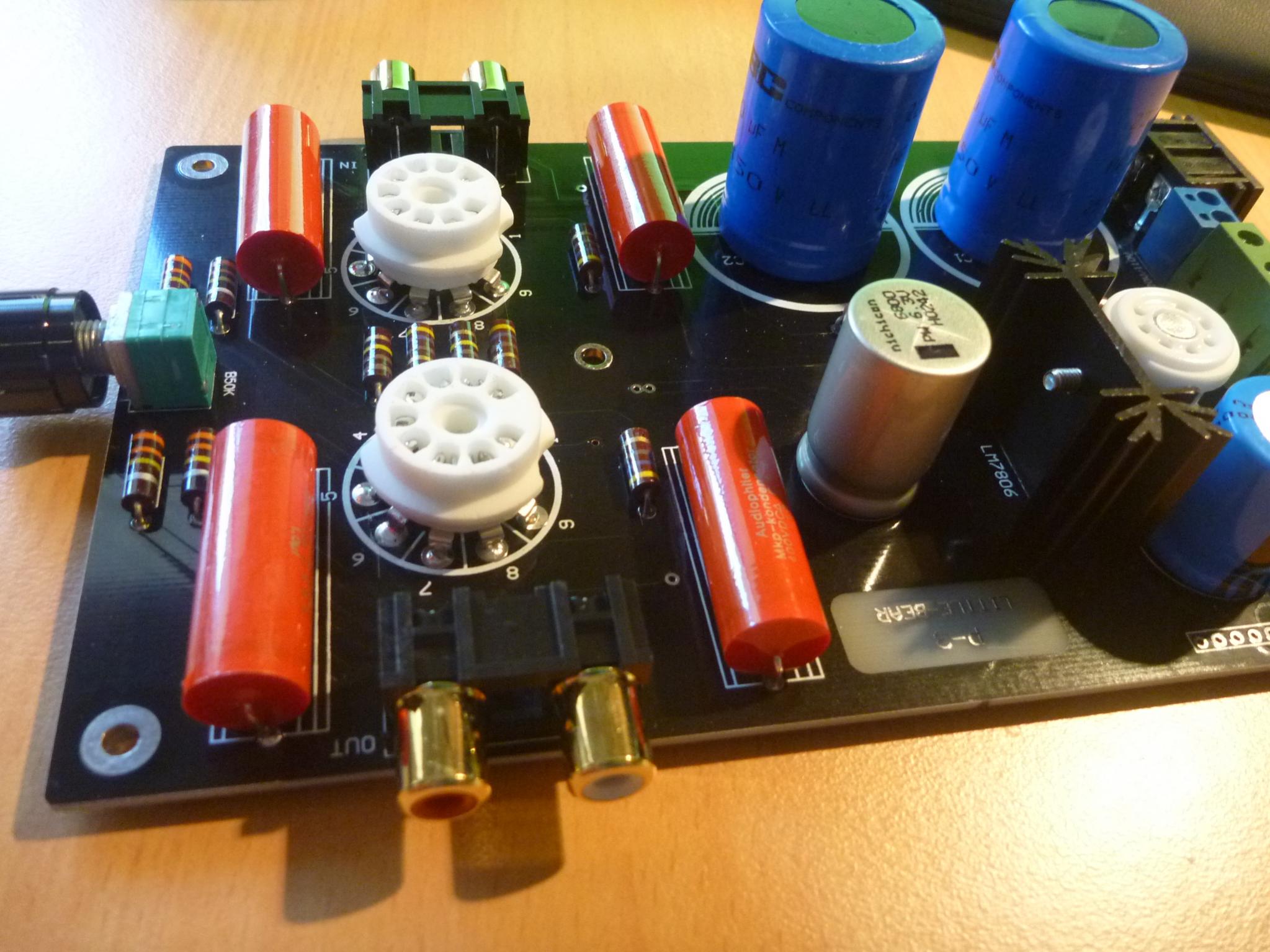

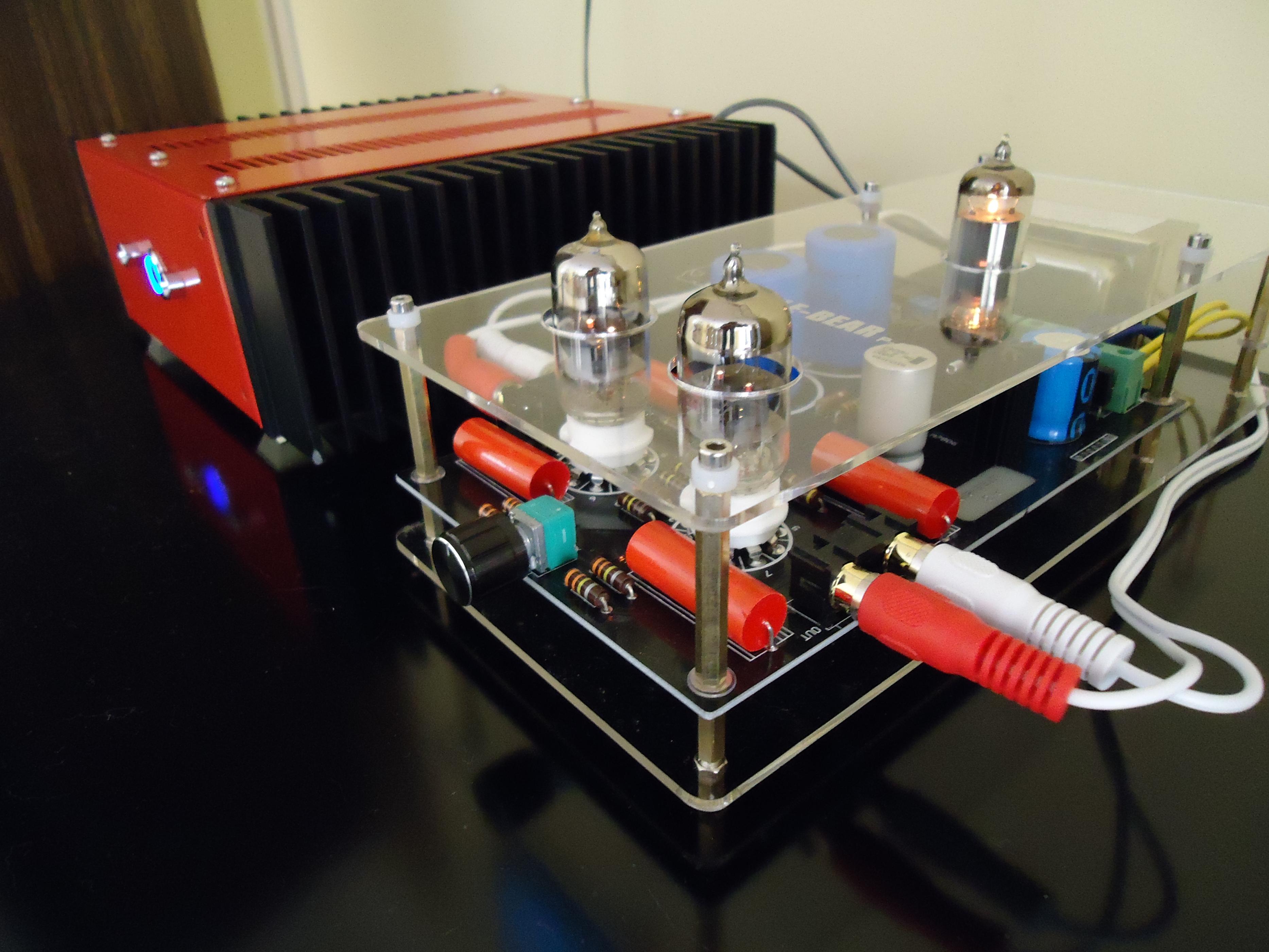

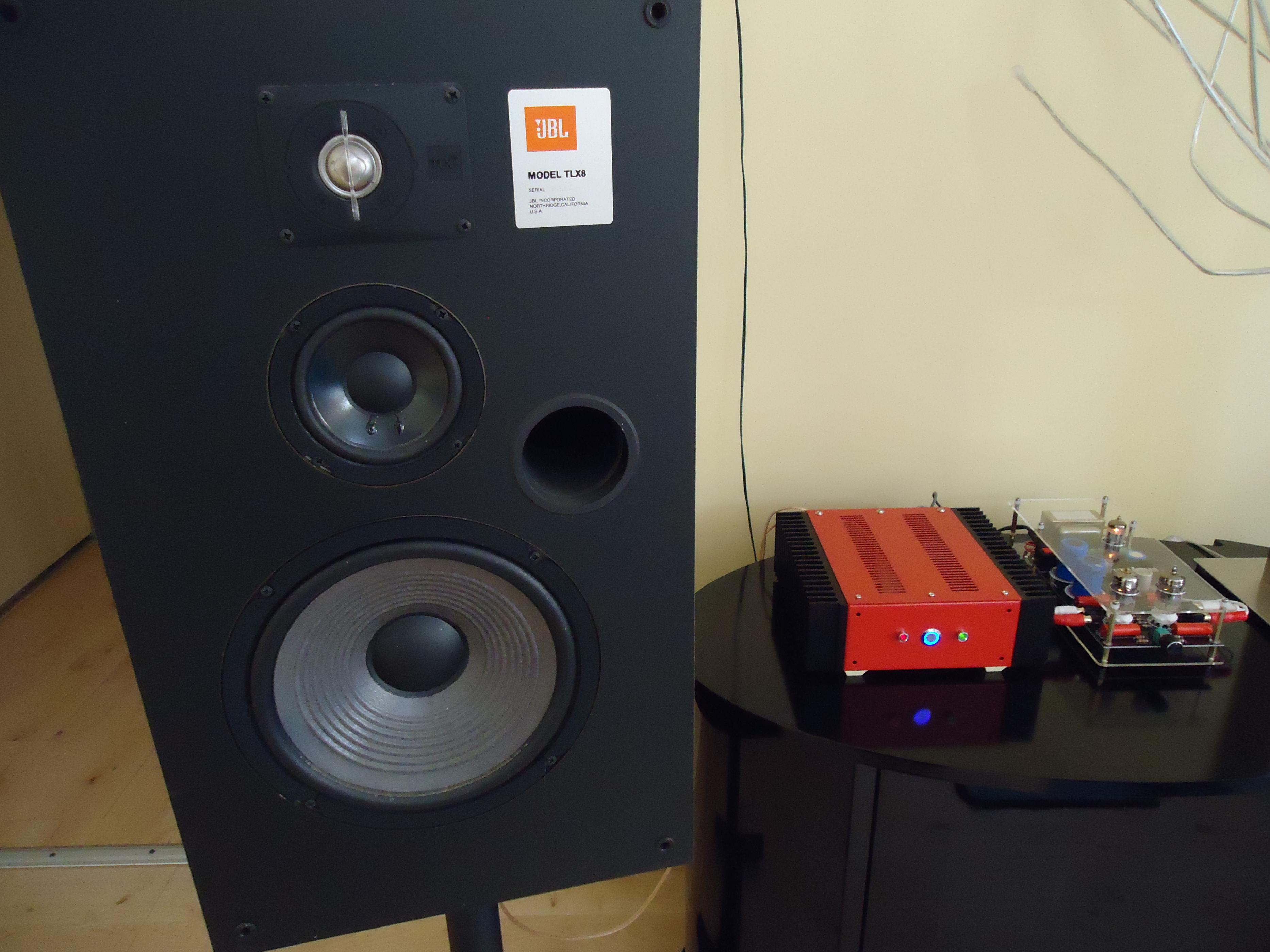

Little Bear P3 connected ACA
Well it's been a while but I've finally got myself organised and got back on the forum.
The Little Bear P3 arrived from eBay and I got the ACA from Sachu888 assembled and running. I was genuinely surprised at the sound. Running the ACA direct off my Sonos into a set of 1984 vintage JBL TLX-8's I got a nice sound. Also, given the JBL's aren't particularly sensitive, I was pleased with the sound level the 6W ACA gave me. Putting the Little Bear P3 in the loop gave the sound a little more warmth.
I've attached some pictures of the setup and the Little Bear P3. The Little Bear P3 was supposed to be a kit however basically you just wire up the transformer and put on the covers (which aren't safe if you have people who might poke fingers into it, so worth doing a nicer surround).
I also did the 6W mod to the ACA kit, photo attached. Heatsinks seem to cope however it's coming into summer here so we'll see how it goes with higher ambient temperature.

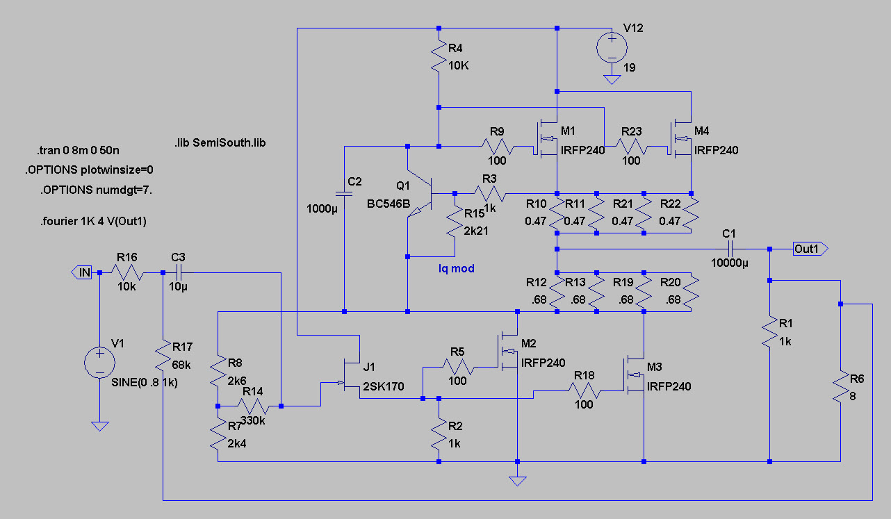

I have just built myself an ACA and wondering if it`s possible to increase the bias?
I have already done the 2k2 mod. Heatsinks are big so no problem there!
double mosfets
double mosfets
Ok? How to do that? Ekstra R5 and R6 on gate for double Mosfets, Source and Drain in parallel with existing Mosfets?
I was thinking maybe resistors in parallel with R1/R2 and R3/R4?
upper ones matched
lower ones too
or change (add) resistors , do not double mosfets - use IRFP150N instead of 240 , that will give you double everything , without need for matching
power will not increase , without increasing PSU voltage
you asked for greater Iq , and that's what you get
there must be also edited schm for increased PSU voltage , somewhere earlier in the thread
