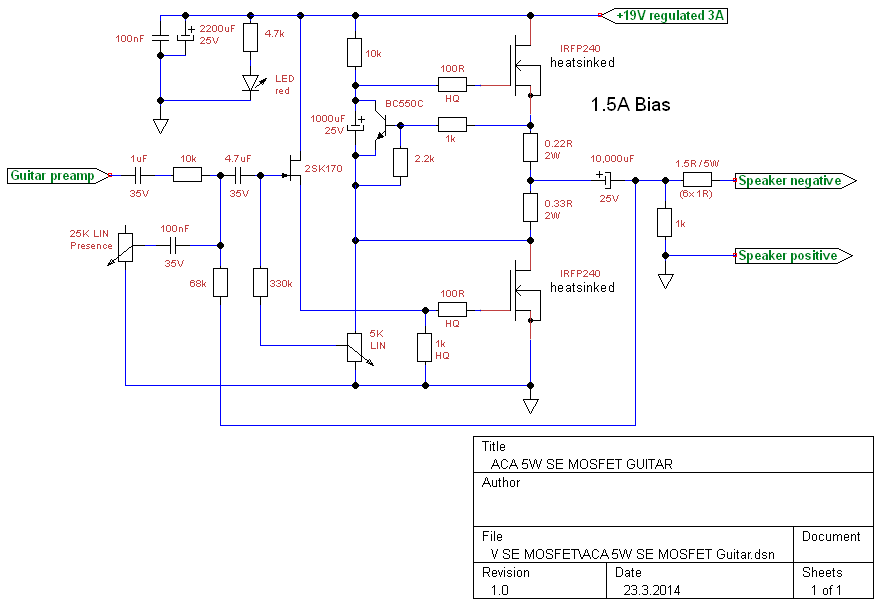

Presence control
How can I implement presence control? - shunt high frequencies from feedback to ground so at the output high frequencies will be amplified.
I have tried implementation as in the schematics, but it works exactly opposite way - cutting high frequencies instead boosting them.
If you must have a presence control, try the schematic attached below. You will probably need to increase the presence cap to 220nF or 470nF. Be aware that the input has no protection and driving the power amp too hard can damage the JFET and/or the lower MOSFET. For more fun, just disconnect the 68K and run with no feedback. Change the electrolytics on the input, you can use much smaller film caps. They will recover faster when the amp is overdriven.
