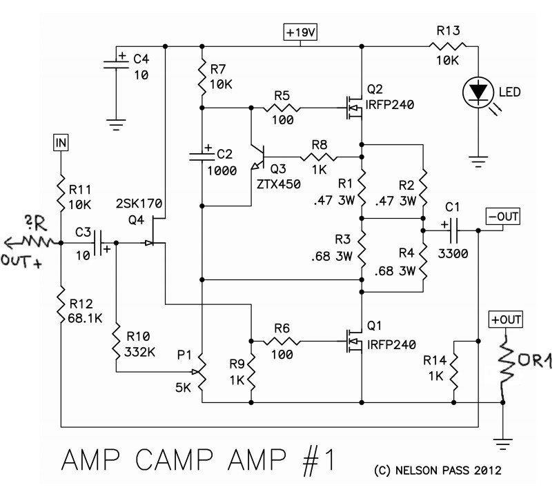

I'm still trying to get a feel for the Mu Follower. In the ACA, is the value of R7 a major factor in the bias? If one wanted higher bias, what are the best options?
Can you lower the value of R7?
Would a Darlington at Q3 work well (to get a Vbe of 1.3 instead of .65)?
I used the addition of R15 in my build of the ACA, but would that type of solution work for any bias desired?
I'm also trying to understand how the J2 CS works, and I'm having a hard time drawing analogies to the ACA when it comes to the opto-isolator. Is the opto-isolator forcing a Vbe of 1.4V to get the 1.7A bias?
Operating current is determined by R1R2R3R4, and has nothing to do with the R7.

What is the purpose of R7?
How does R15 increase the Bias with regard to the Vbe?
I have a bad understanding of the Mu Follower.
R7 designed to provide Q2 bias, but bias voltage controlled by Q3.
Q3 control voltage to the voltage supplied by the current R1R2R3R4 over about 0.65V bias voltage of Q2.
R15 supplement aimed at each end of the R1R2R3R4 voltage R8R15 voltage divider. Voltage voltage of Q3 is still 0.65V,
R1~R4 voltage will be higher,
A better approach is to reduce the resistance of R1~R4.
As regards the actual total resistance up to R=0.65/I to reach.
Increase of R15 the right resistor is:
I (after)/I (ago) = (R8+R15)/R15

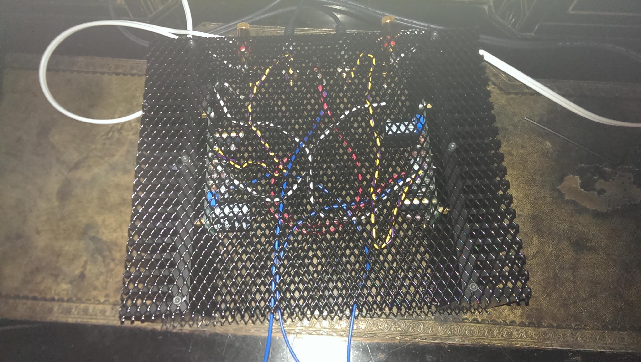

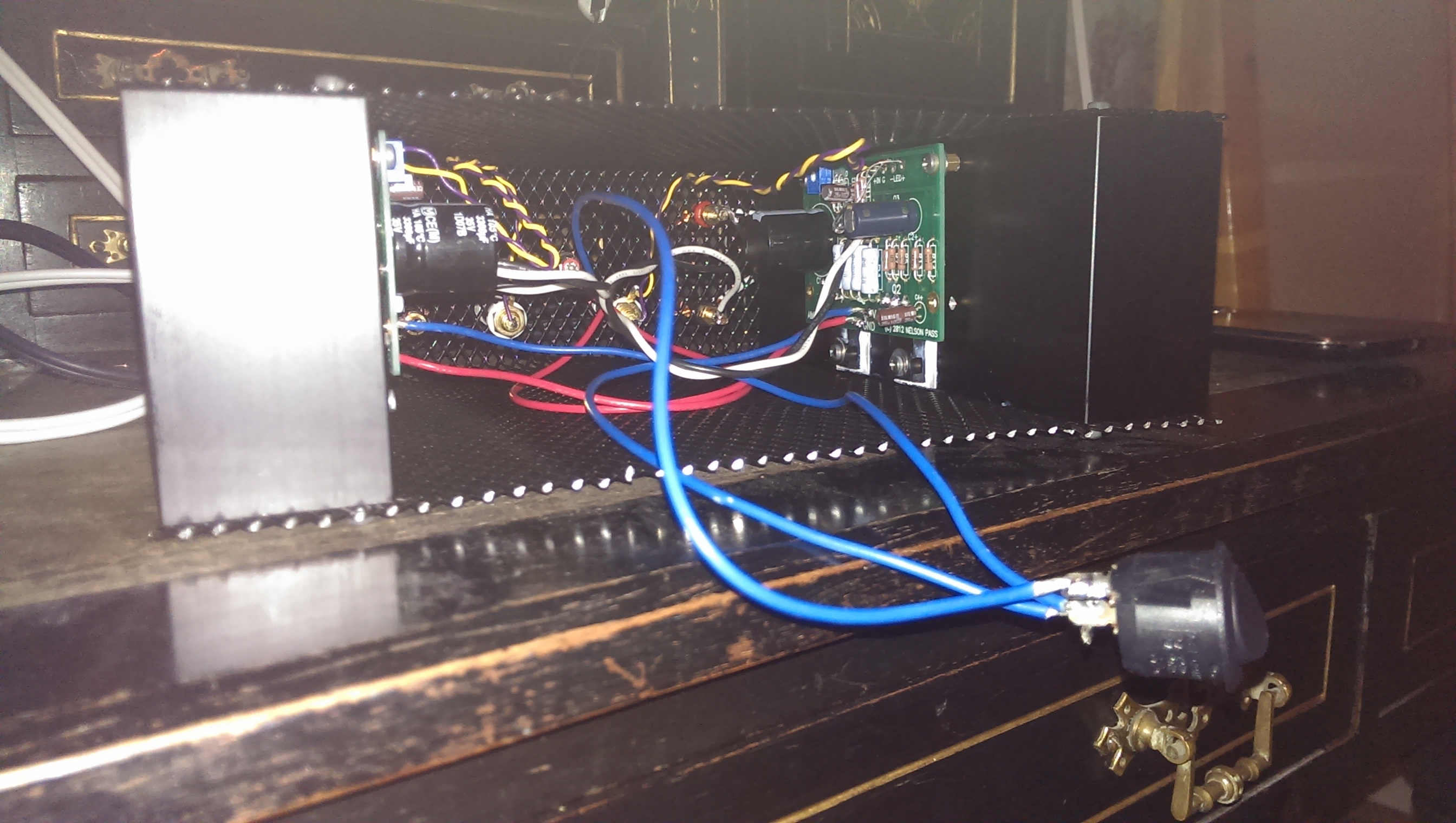

My ACA minus a finished chassis.
learnt loads doing it - still yet to do the mod with the resistor.
The hardest part was soldiering the plugs.
the worst part was drilling and tapping all the holes.

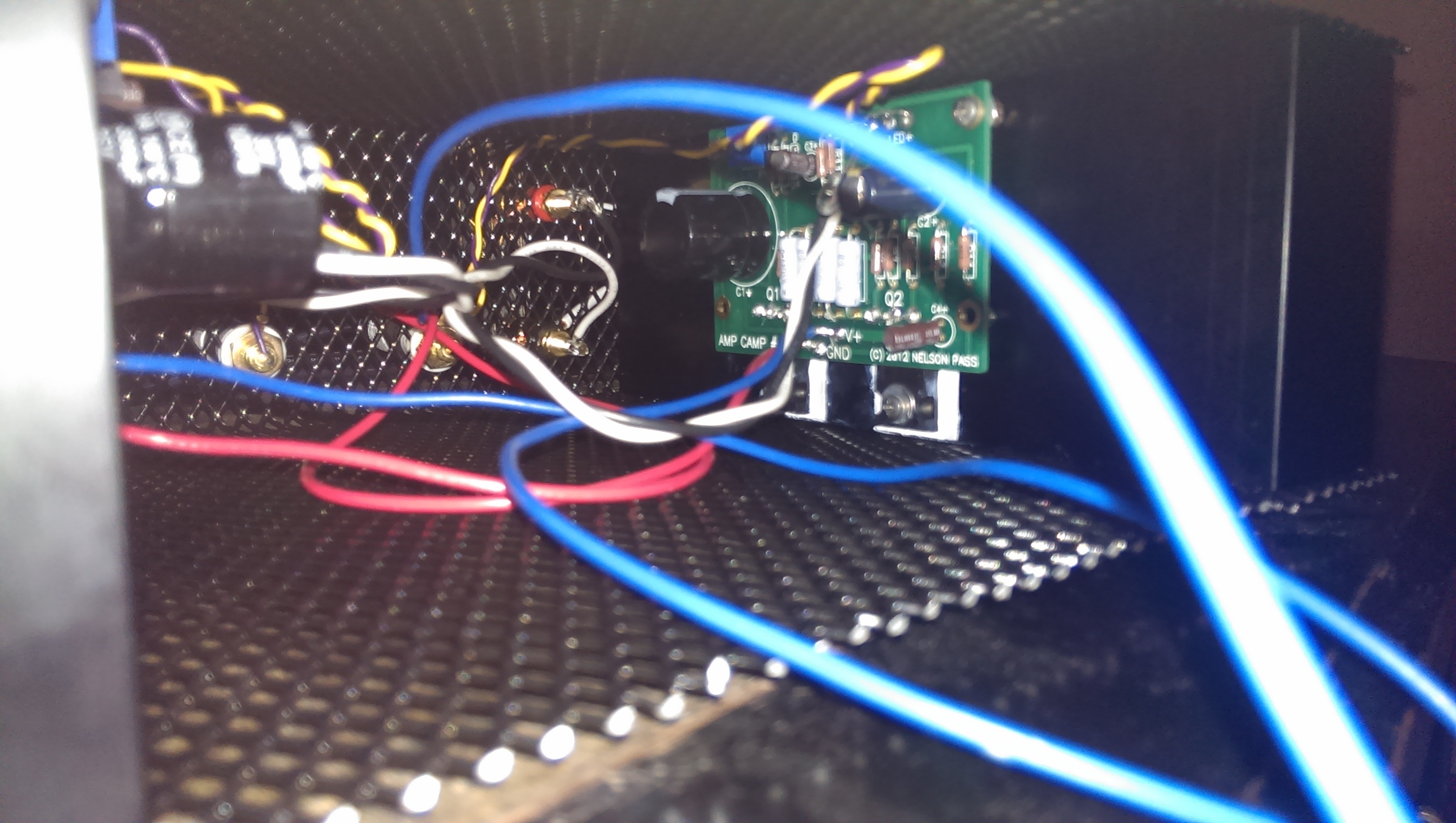

Cheers 6L6. I opted for a single power input hence the snakes wedding in wires. I am yet to find a sensible way of routing them all in one chassis.
I've still got alot to learn but its a start. I have researched what all the components do individually but what they do all connected to each other is the next step.
The R1-R2 to R3-R4 ratio, as well as their absolute value, (and the transconductance of Q2) determine how Q2 assists Q1 in supplying current to the load. Those resistors also influence the open loop gain and the distortion profile. IMHO the R15 mod is the best way to go, but seemingly little changes to the ACA change many other things.

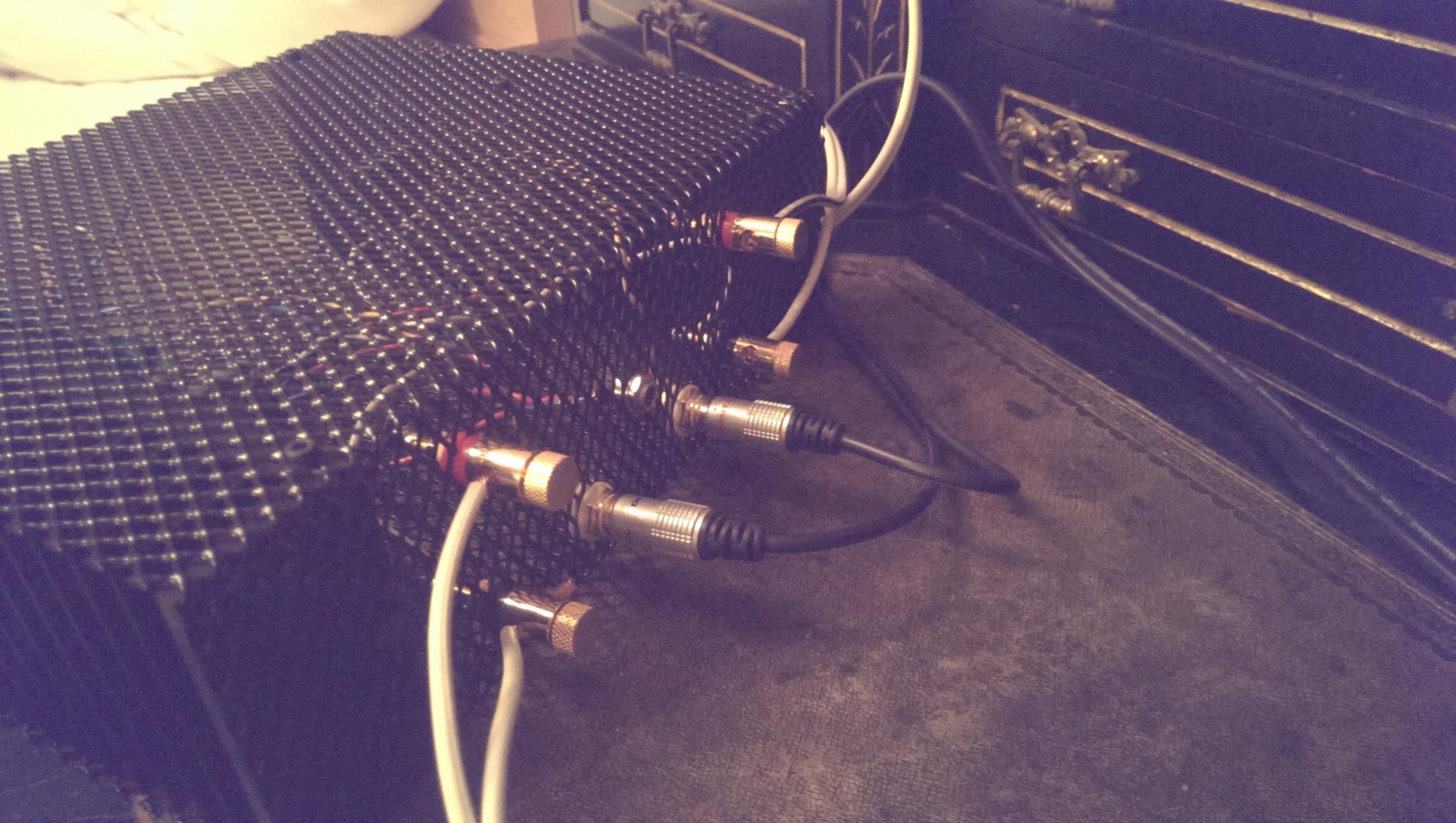

The cabinet looks great. Where can you buy them?This amp with that bias mod is really loud. I found that I don't need more power, and I use a B1 as a "pre". However, you can hear the the amp has a bit higher THD compare to begged FW amps, especially on higher volumes. If you listen to simple enough music, you will newer notice, but I am a huge Steve Vai fan . Don't get me wrong this is a really nice sounding amp, I put it way above F5 for example. And the bass, it will surprise you... But I have a better PSU, can't say about ones from that kits.
Some more pictures of finished amp:
