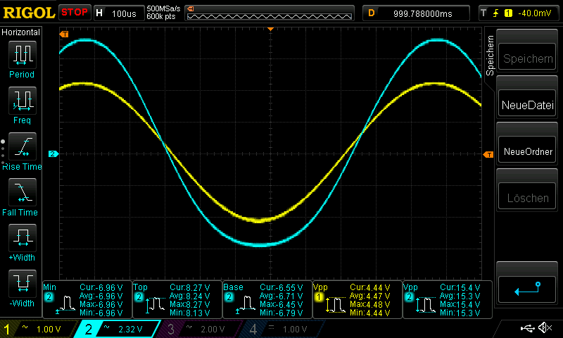

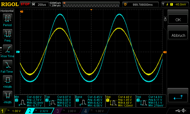

i follow your instruction:
here are some pics/measurements about my R channel with 24V supply and just this channel was connected, means RCA just at R ch, load 4R at R channel, L channel completely disconnected.
finally i got after my 4A fuse at the amp and connections 23,82V at the amp board.
bias is 1,57A and AP is 11,20V
pic 1 Rchannel Supply 23,82_1500mvrms
pic 2 Rchannel Supply at _23,82_1540mvrms
compared to the L channel
pic 3 +4

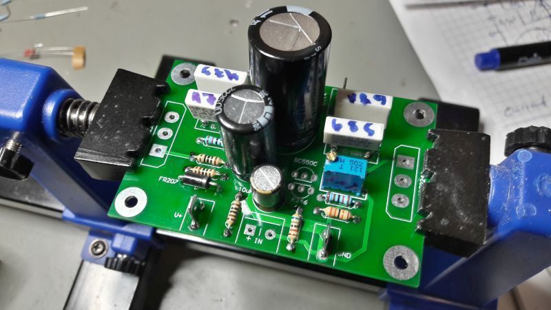

i am thinking that at this clone pcb this strange diode is doing something strange...
pic 5 left buttom corner FR207 no idea what this diode is doing...

OK, just clarify this then.
Your boards were obtained already built up with parts fitted or at least with the parts supplied with them?
So we do have the possibility of parts on unknown provenance in that case.
Is the diode across the power supply or in series with the power supply as some form of reverse polarity protection?
Where is that diode on the circuit because that means the design is different to the ACA.
What parts does it connect to or connect between ?
It feeds the Drain of Q4 off the +19/24 volt line. There is no C4 (10uF) cap.
Thanks Alan. I wouldn't have thought such a diode would cause distortion but its inclusion is a mystery.
I think the whole board and the component types probably need to be gone over very carefully. We know the basic design itself is tried and tested and works well.
thank you to all for your help
ok. thx. so why is that diode insde??. i will short this diode...

...without diode(shorted) + heat update 2
Hi

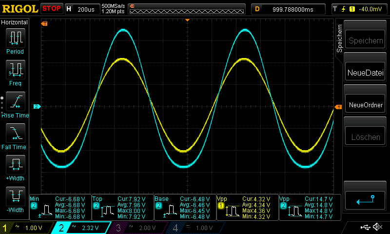

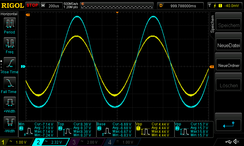

i put out the diode at this clone pcb and short this area..the amp is working well
measurements looks bit better...
4R max input 1540mVrms input..before clipping
pic 1 L channel Supply at _23,82_1540mvrms_without diode
pic 2 R channel Supply at _23,82_1540mvrms_without diode

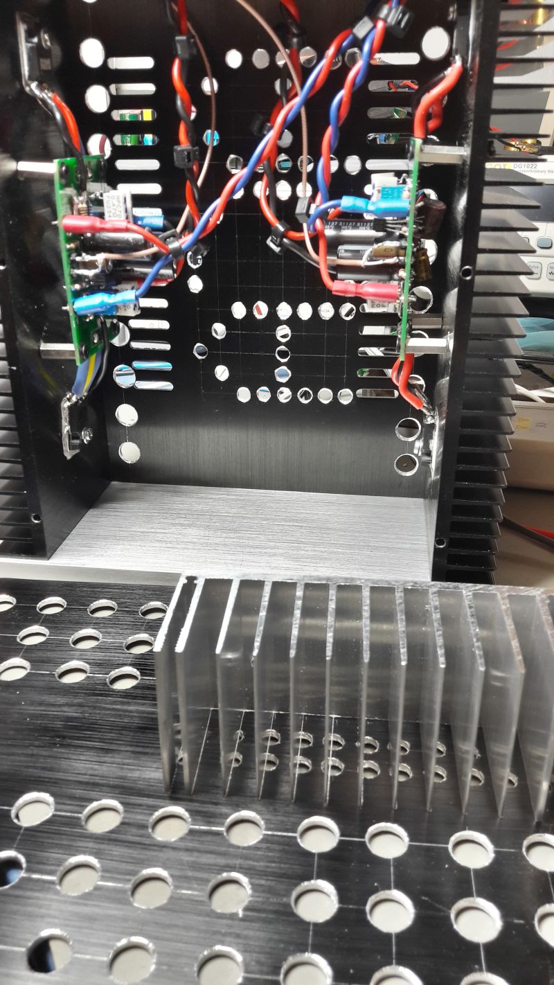

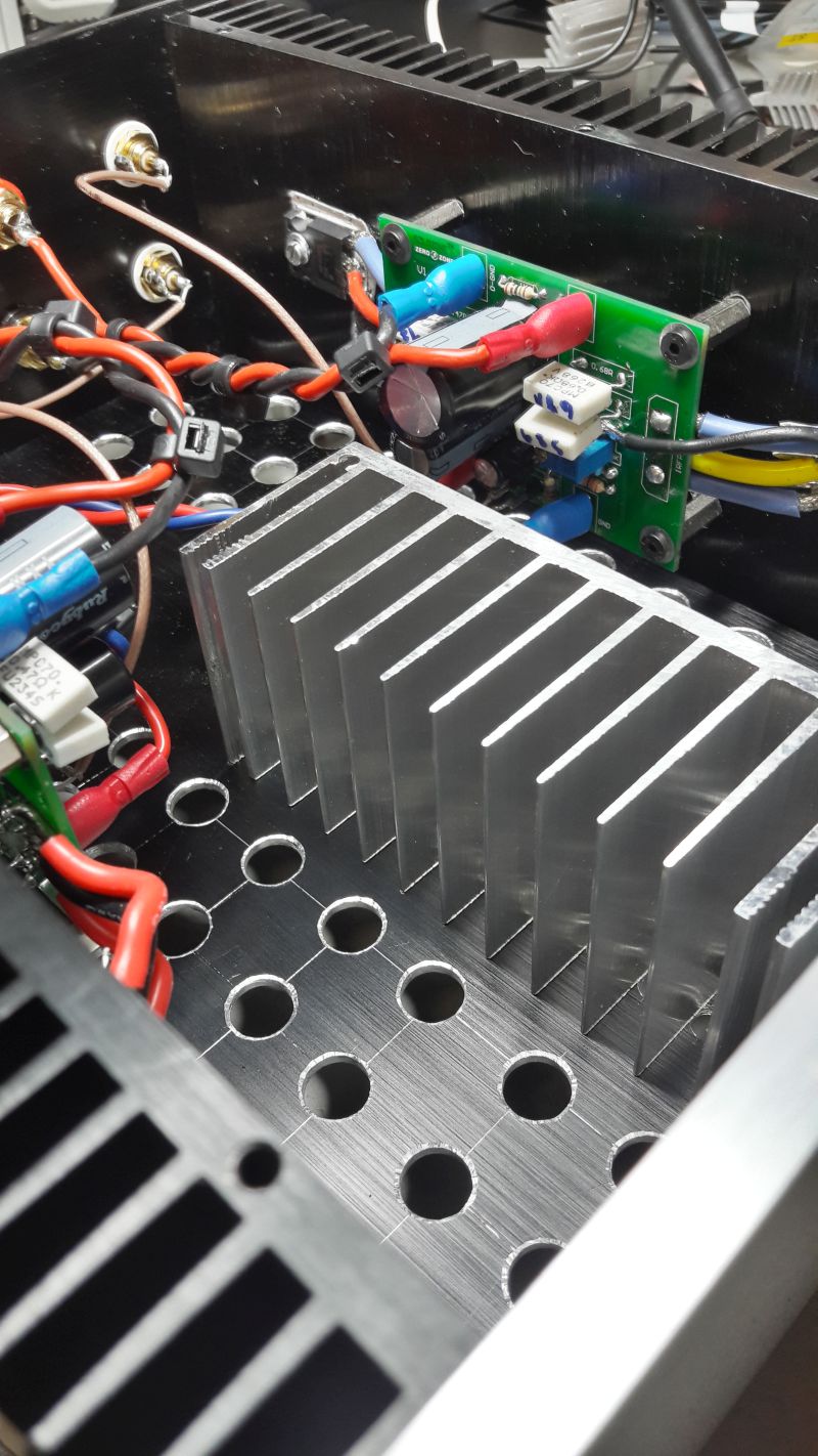

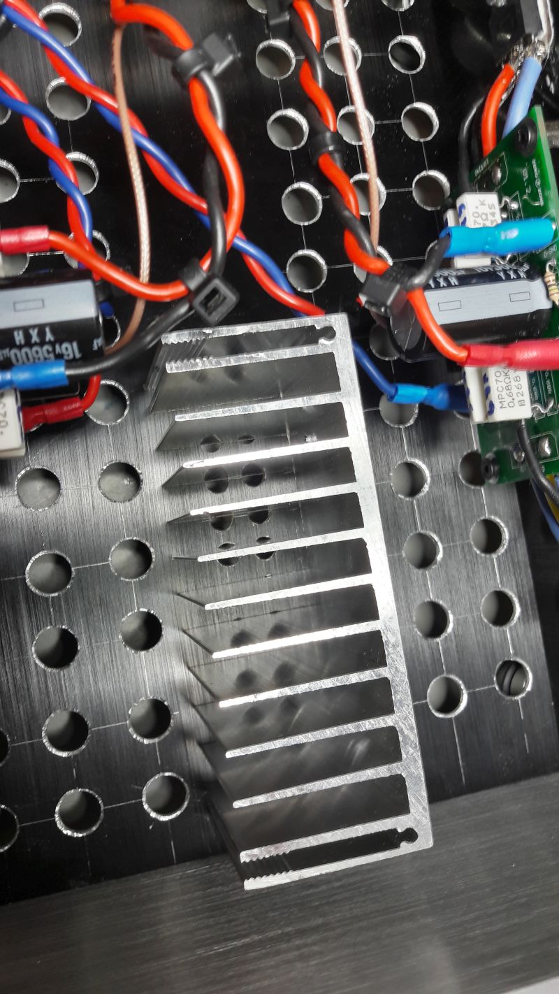

pic 3,4,5,6 are heat update with a small 50mm high heat sink what i have at home

i suspect that the diode is used as a safeguard against inadvertent reversing of psu leads, the amp will not work when that diode is put in reverse of the psu leads are reversed..
the smps will simple fold back and stop...
