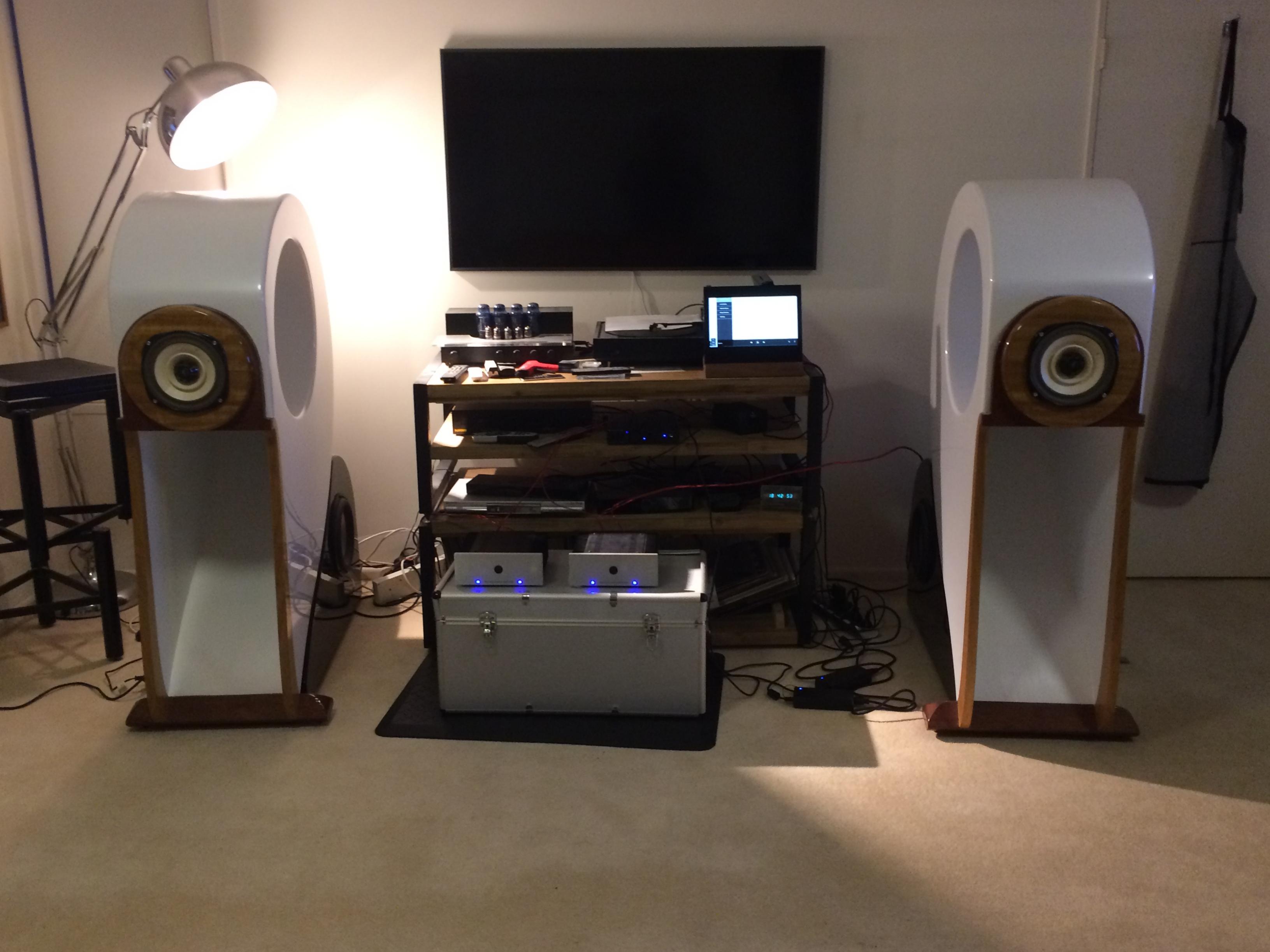

I think the above stuff is correct. The DIY Carfrae little big horns I use are full range speakers with no crossover between the ACA and main driver but the speaker cable is split at the terminals of a170watt plate amplifier in each speaker that’s manually adjusted for gain and crossover cutoff. The ACA never sees the load from the subwoofers. It was pretty easy to play lots of music and dial back the upper frequencies of the sub whenever it was a bit boomy. I don’t know how true it is but I was told that since your hearing is less sensitive in the low base area going all out Audiophile there won’t get you huge gains. It’s worth pointing out the sound from my subs is very well integrated. Seas 10 inch sub as same size passive radiator. It’s working well for me.

In my system the very lowest bass notes come from a subwoofer & plate amp combination but that's taking it's signal from the ACA speaker cables driving the full range drivers. Point being the bass signal from the ACA is very good the limiting factor will be the power. I'm loving it. At the moment I'm using Cambridge DAC magic plus to drive the ACA but have all the parts ordered not for the Korg Nutube buffer. Integrated Valve amp has taken a back seat!
