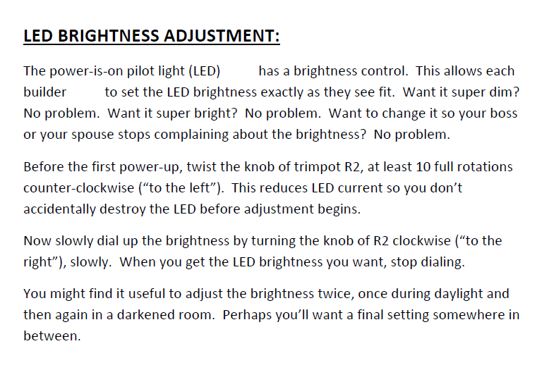

I decided to squander $2.00 of the builder's money. I installed a 25-turn trimmer potentiometer footprint on the PCB, in series with the LED, for project we're putting in the store soon. This trimpot lets the builder set and adjust the brightness to any desired level. They can also experiment: swap out different LEDs having different colors or different maximum viewing angles, and re-adjust the trimmer to get the desired brightness every time.
Your spouse thinks the LED is too bright? No problem, dial the trimmer. Etc.
Here is one way to spend a lot of money on a front panel LED

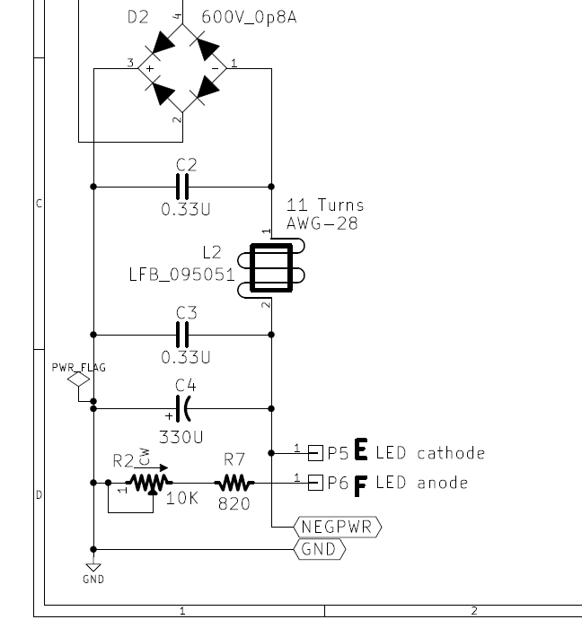

Having a pot without a series resistor is not a good idea for a DIY project. If the pot is at the zero resistance end, the LED will blow at power up. Many DIYers don't have the equipment to slowly turn on the project they are itching to try out. Nelson sometimes does this on Vbe multipliers. If the pot is at the zero resistance end, it's max fuse blowing bias.
Joined 2011
I combat this enemy, two different ways. First I use a trimpot with triangle pins footprint, ensuring it can't be installed backwards. This guarantees that rotating the trim knob clockwise increases the brightness, and rotating the pot counterclockwise decreases brightness, on every single unit, no matter who built it. The Builder's Guide .pdf document tells you how perform the adjustment (attachment #1 below).
Second, I include resistor R7 in the schematic and on the PCB (attachment #2 below). This guarantees the LED current cannot exceed ((Vsupply-Vled)/820ohms) even if someone fails to follow the written procedure just mentioned. Observe how recklessly I have squandered the builder's money: a fixed resistor in series with a variable resistor! Sacre bleu. Also observe how I have exaggerated the "danger", to increase builders' motivation to turn down the brightness control before first power-up.

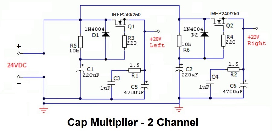

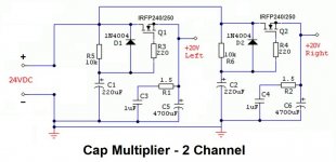

Lots of info in this thread: Juma's Easy-Peasy Capacitance Multiplier
I've used two cap multipliers for my ACA - one for each channel. It has the added advantage of giving better channel separation when using one power supply. See diagram below.
This Cap Mx has about 4V drop, so start with 4V more than you need for the ACA. I'm using an enclosed Meanwell SMPS and I can set voltage higher than nominal. If you want 24V into the ACA, select a PSU that will give 28VDC.
The second picture shows the two Cap Mx's mounted on the bottom panel of my ACA. It gets hot, so you can also mount it on the heatsink.
