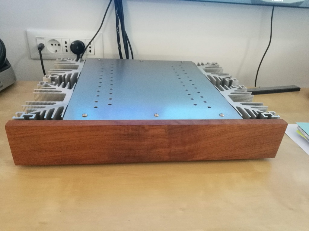

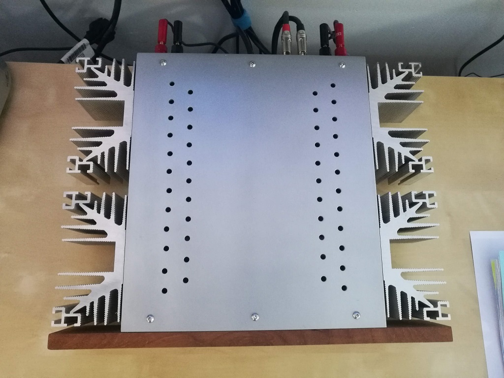

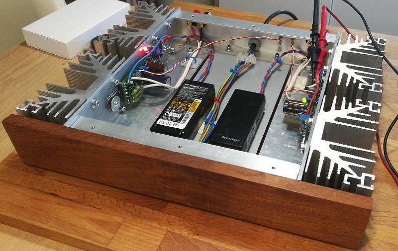

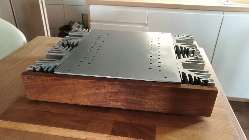

Often amps come and go, but ACA is in my system on regular basis. It is not that old (1 year), but I really like it. Especially, it is my first build, including chassis (I did not count how many holes I made, more than 300). Due to fact I like "slim" design units PCB's are not from diy audio store, but made by diyaudio enthusiast in Germany.
Front panel is teak wood (polished and oiled), everything else is aluminum. PSU's are Lenovo units, providing 20V, dual mono unit, sharing only power cord.
In fact, this (last) Saturday, ACA was playing (at full power, of course :)) at my daughter's birthday. As being "fed" by reasonably big Yamaha receiver (rxv 1700 - used as preamp), most people did not believed what actually is powering speakers.
Of course, none of it wouldn't be possible without extensive help and experience of other members of diyaudio forum!
Next in line is Babelfish J, coming soon :).

@TungstenAudio: thanks. It was my first diyaudio build, and I was not limited in time or dimensions (often a problem when buying premade enclosure). There are still a thing or to to make/improve, but as it sits - I am satisfied. Thank you very much!
@mraudioguru: that is exactly what I was thinking before start. ACA is just THE RIGHT THING to make, having optimal number of parts to make it a beginner's project, exactly as was Mr. Pass idea.

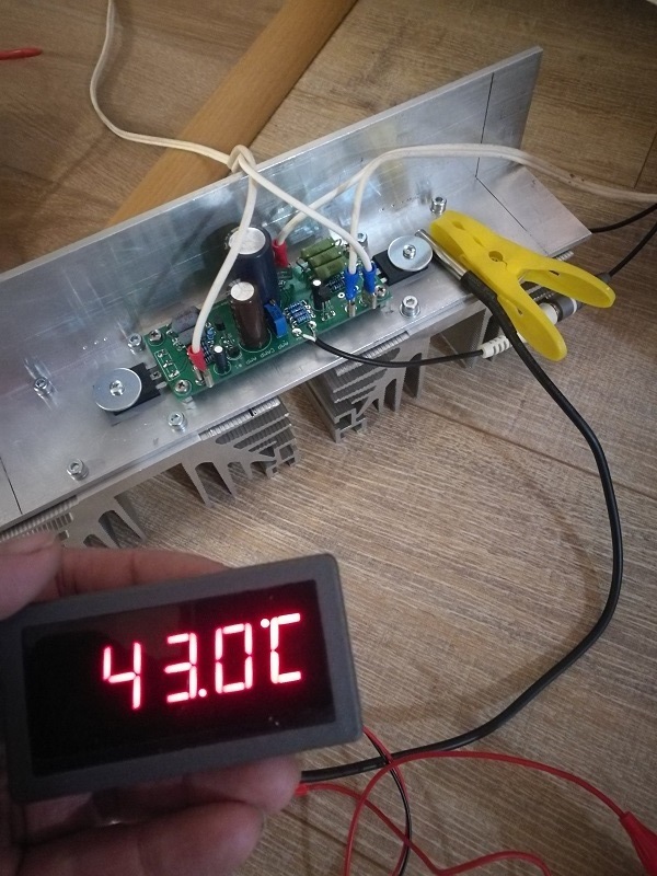

@oc11: well, to my surprise, it is not that cool as I was thinking it will be. I can not find photos at this moment from when I was measuring finished amp, but I did find some from testing phase. Anyway, temperature of complete amp inside rack was cca 50 deg C (so 122 deg F), and I decided it is not best idea to keep it in rack, so it is on top now. Also, I have made some kind of wooden stand for it (like wooden brick, oak wood, I couldn't find teak wood that big), but I removed it for safety reasons (my kid's birthday). I guess that temperature now is 42-43 deg C (cca 110 deg F), so really nice.
Here are two photos few minutes ago. It was really difficult to cut that one peace of aluminum heatsink into four pcs, than grind them (by hand) to make them same thickness, and drill all holes, and thread most of them. 90% of that was done on kitchen table :). Not to mention holes on top cover, or frame made of aluminum L and U profiles.
Well worth the effort :).
