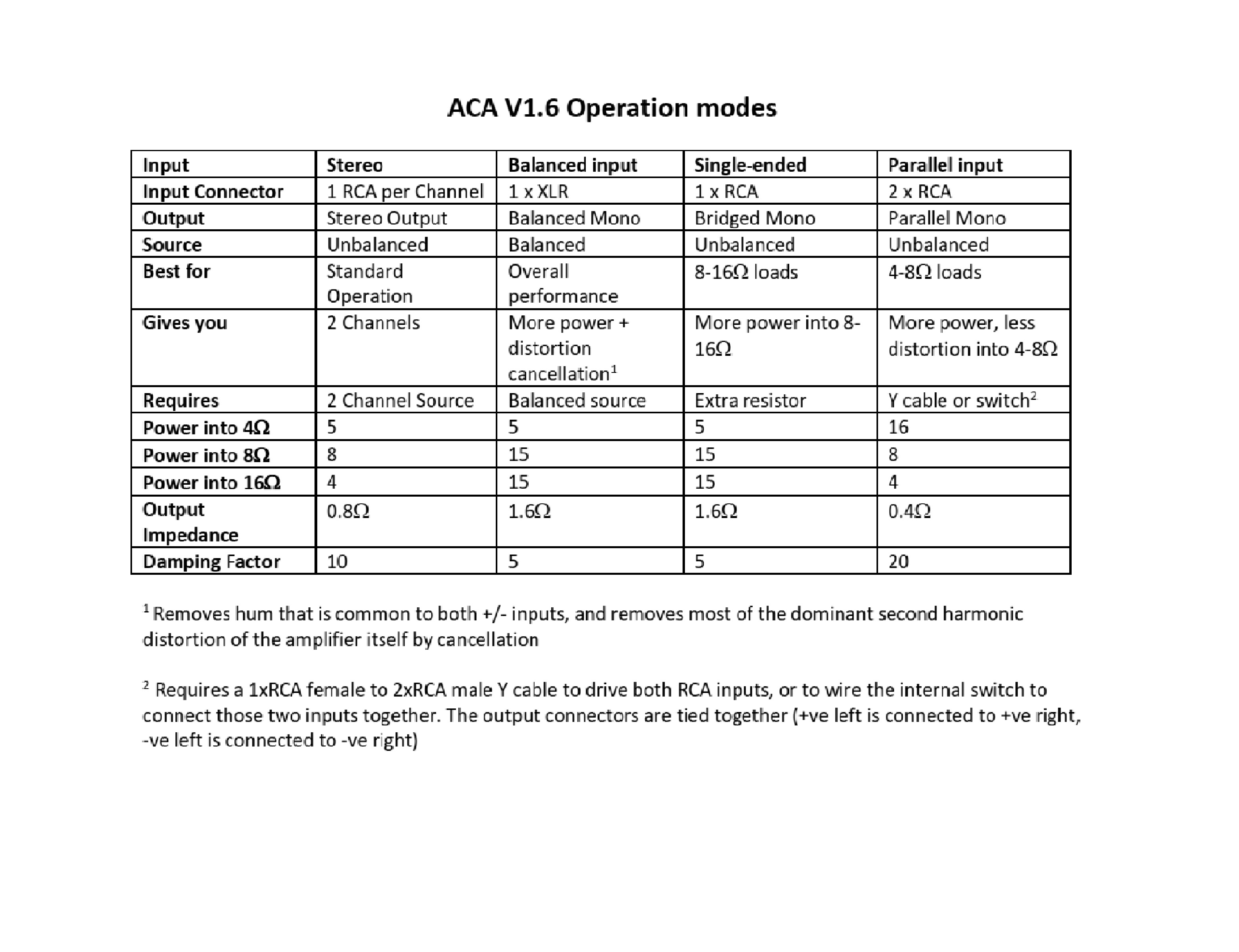

Hi, does this mean that you can effectively get a 8w+8w amplifier ?I built v1.6 a week ago. What a sweet little amp. Great detail and the bass is amazing. I don't blast music any more and I can't believe this drives my MMGs to a satisfying level. I've had a rash of amps pass through this system and this rivals the best I've had (Audio Research CA50 and Pass Aleph 5 come to mind). I'm thinking of buying another and running them in parallel mono mode.
I had this idea of buying two parts kits and installing them side by side in the same chassis, each being driven by one RCA, naturally they wouldn't be balanced, but at least I'd get double the power.
Or am I missing something?
The answer is yes or no*.
Mono 'bridged' or 'balanced' mode (2 ACAs) gets more power out for 8 to 16 ohm impedance speakers so say 14 - 15 watts. They can effectively swing more volts.
'Parallel' mode (again 2 ACAs) gets more power into lower impedance speakers. 4 ohms or so. Could be 15 watts. This is because there is double the current available.
* So the answer depends on the speaker impedance as much as anything.
There are puts and takes for either mode and it is covered here https://cdn.shopify.com/s/files/1/1006/5046/files/ACA_Monoblock_Operation_RevA.pdf in the build guide.
Hi, thanks for that reply-taken in the helpful vein that it was intended.
But, and it's a big but, this is a DIYaudio forum is it not? Why would I want to buy $280-$400 worth of pre amp?
I was hoping to find a way of doubling the power in stereo, that would be sufficient for me.
As I've said, I'm hoping that the bare bones 8wpc will suffice once built, as I'm hard pressed to follow an electronics wiring diagram, even the tripath amp that i built (and it works fine except on tuner) I built by sight and layout. Once parallel paths had been created on the circuit board, I was no longer able to test the resistors on the board, only prior to soldering.
Such is my limited ability.
Anyway, I still appreciate the reply, it's all good.
If you want an inexpensive DIY fix.. Reduce the feedback to get more gain. You can do that in the ACA by changing R12 from the 39.2K found in later versions of the ACA to the 68.1K found in the earlier version.
Jim
