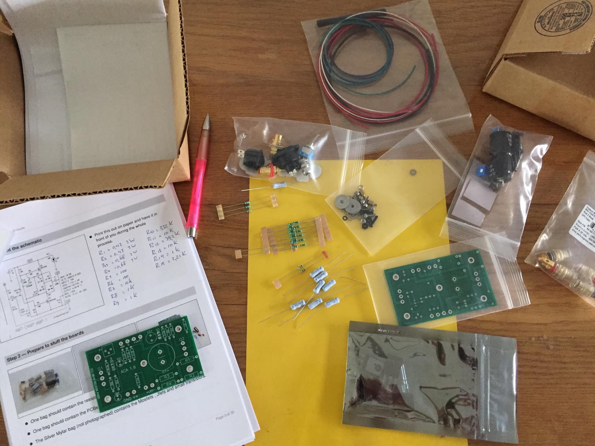

Thanks for the responses. Since (lol, last September) I've been slowly putting together a pre amp, and the bells and whistles that I have added, and being a dad of a lil 2yo have slowed the pace of that project. The upside is I have been reading and learning so much during that time from all of you through these various threads on here. But at the end of the day I'm still the equivalent of the newbie 101 freshman year, while most of you are like Phd expert levels.... AKA there is so much I don't understand yet.
My dum dum questions:
1. I have extra washers and nuts (Please tell the there are extras in the kit)
2. "Beep" to Ground... Is there a thread that explains that to a neophyte such as myself. I googled "beep to ground"... I could figure out that I grab the DMM set it to the ohm position, and can place one lead on V+ for example and the other lead on say the heatsink??? for ground??? and I get O.L for infinite resistance and that happens (lol, doesn't mean I understand it). Am I in the right ballpark here? Granted anything combo yields O.L for me other than if place a lead on each side of a part like a resistor for example.
I'm a lil lost when it comes to this part, everything I have done so far looks exactly like the pictures, and I want the magic smoke to stay inside.

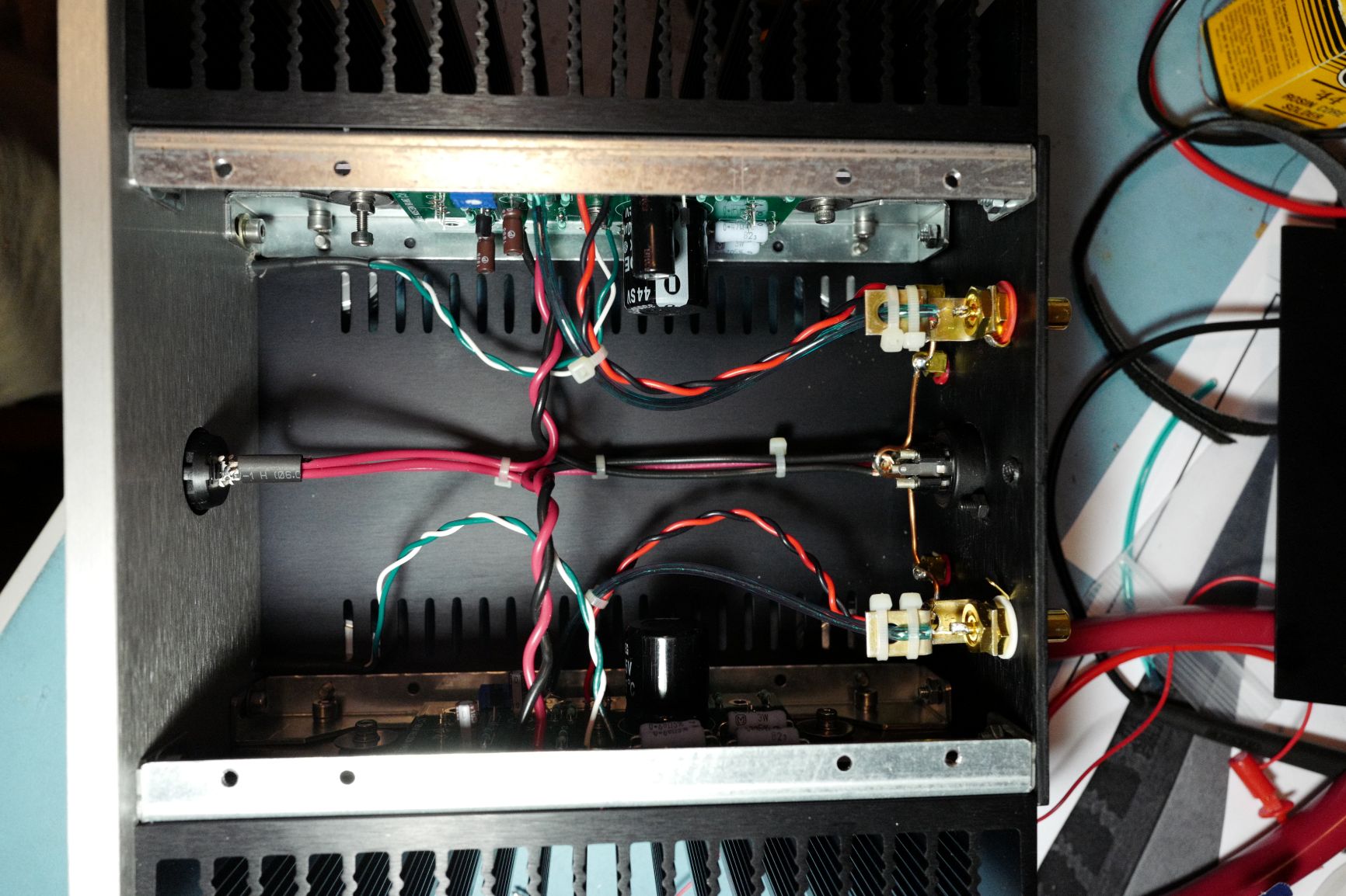

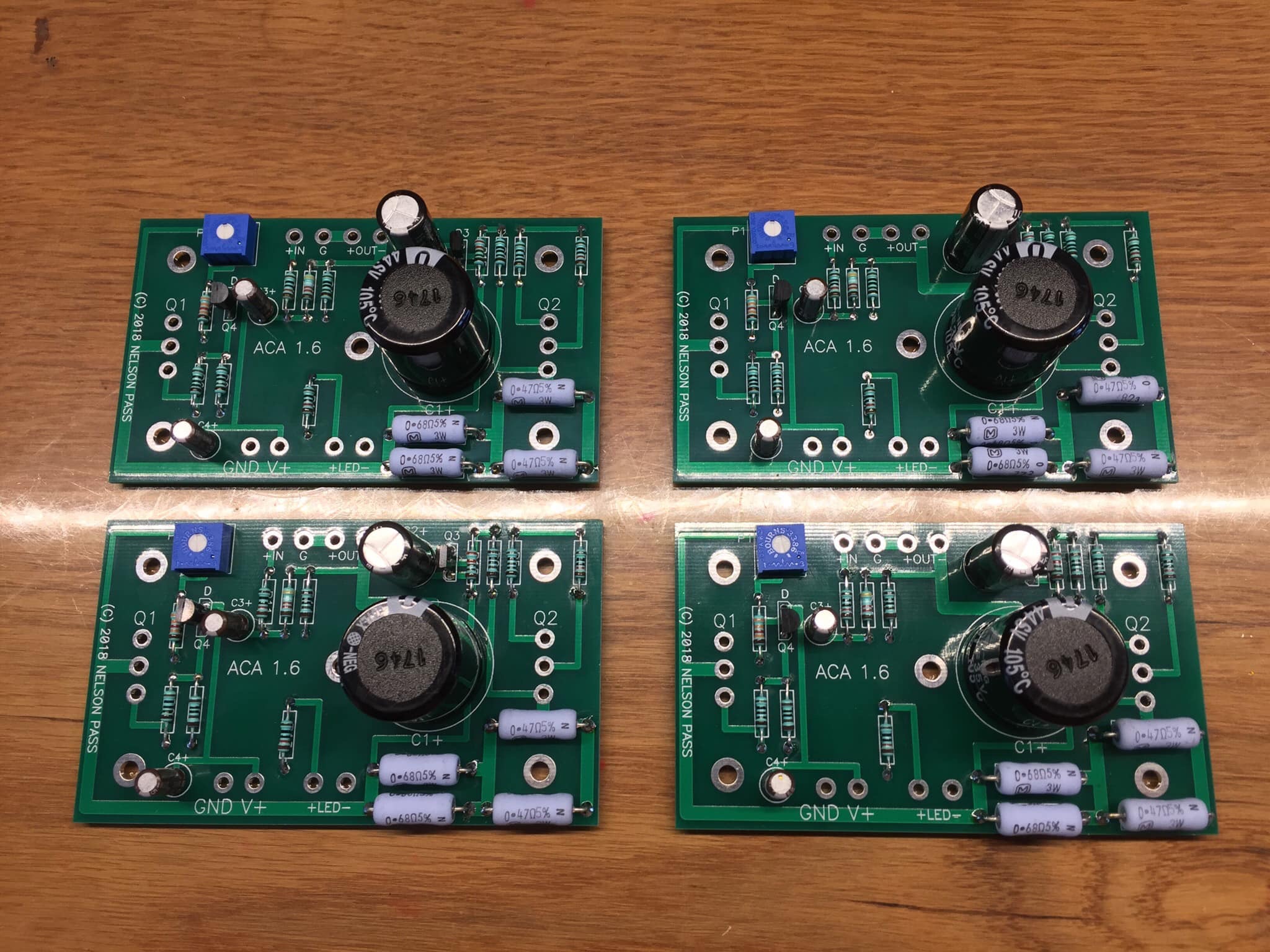

Started my build today! Two amps going to be used as mono’s. Am I doing something wrong by the looks of the attached pictures?
Next is wiring. I want to use N5 silver wires as in all my builds and interlink and speaker cables.
I also want to mount (after measuring and listening) a Capacitance Multiplier to get rid of a couple of mV of noise from the SMPS. Are there more DIY having good experiences with CM in the ACA? Or is it not wise?
Last but not least the black panel of course with some laser engraving to see some UI signs as stated in my previous post some pages back.

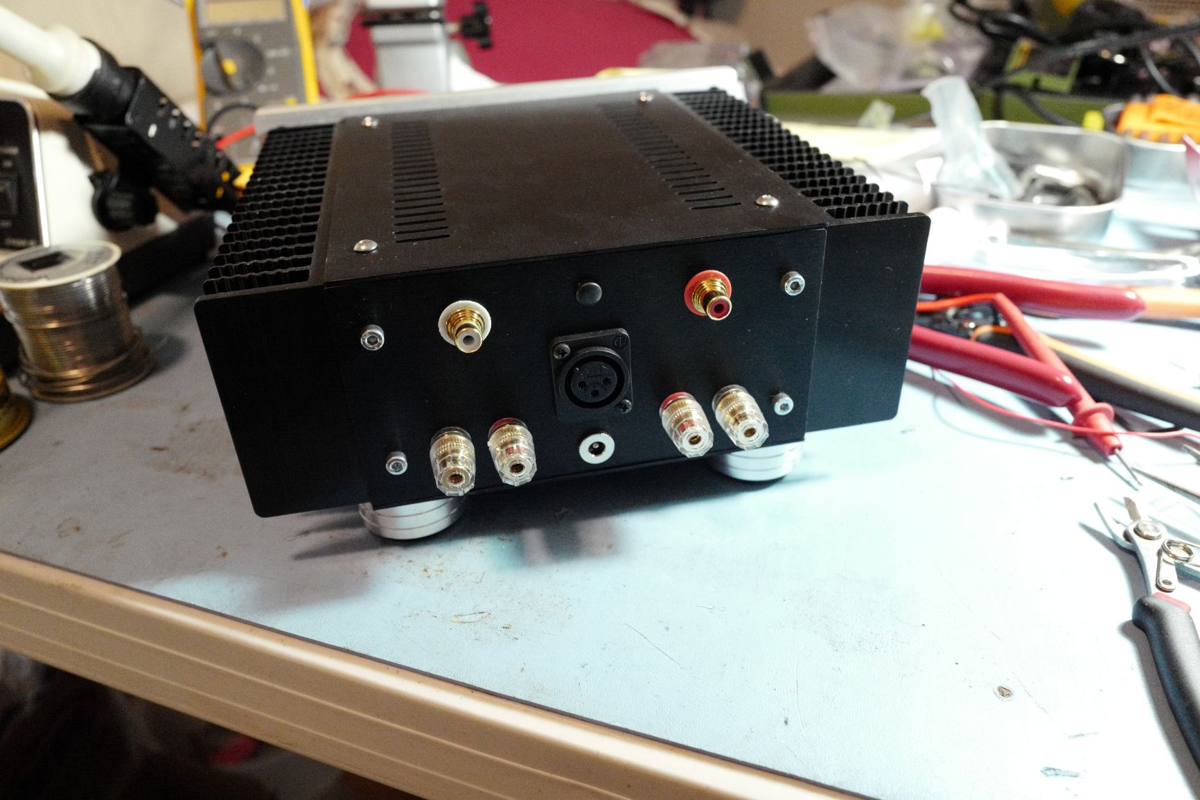

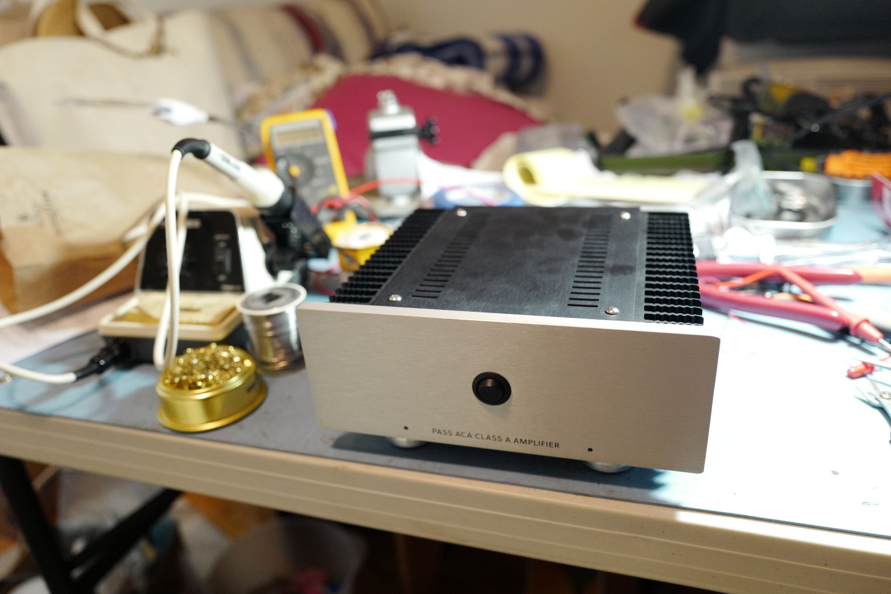

Hi fellow DIYs,
I just completed the build and been listening to the V1.6 aca amp kit and I have to say WOW! My initial thought was to get this amp for my office PC audio setup. Building from it kit wouldn’t be a problem for me since my profession was an electro-mechanical engineer.
I like the enclosure design, simple and good looking. The PCB layout was well thought out. I like the idea of a separate power supply unit to eliminate the need to build a power supply.

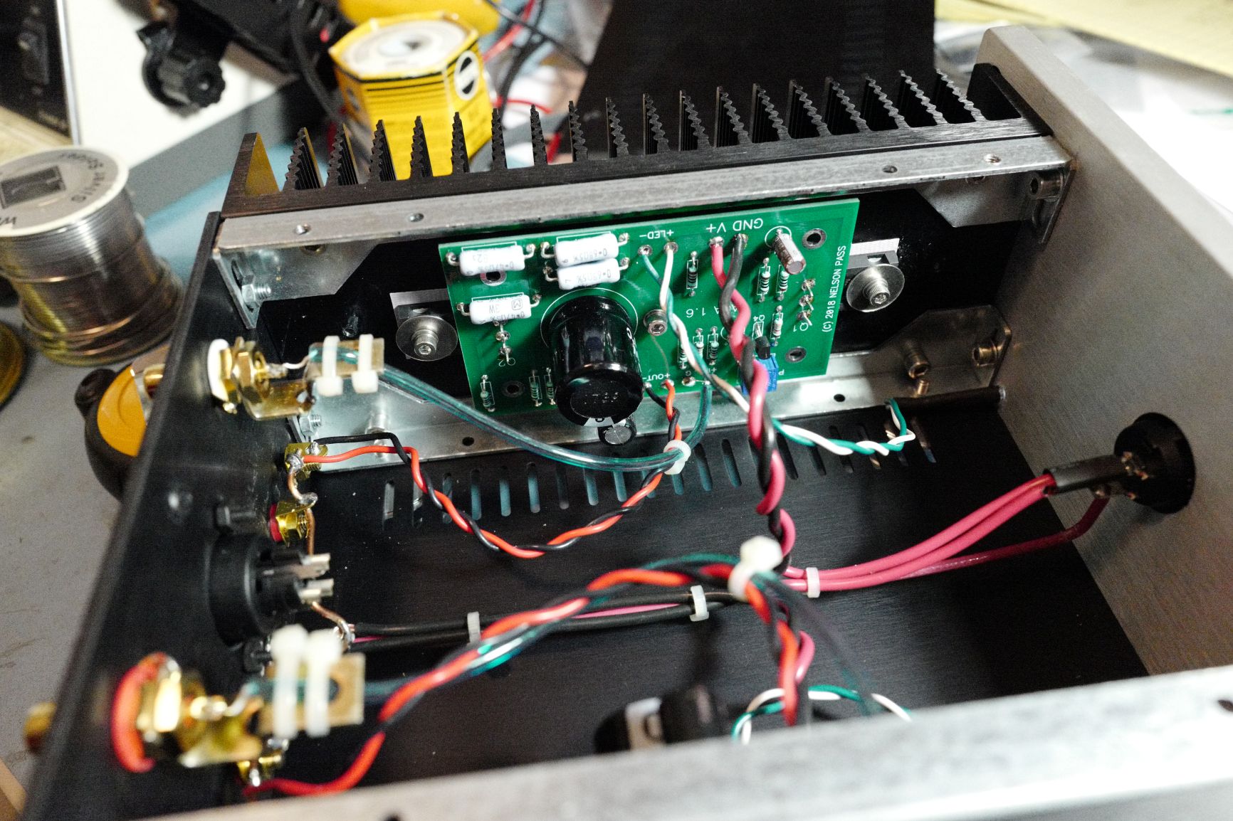

I added a few pics of my aca amp build.

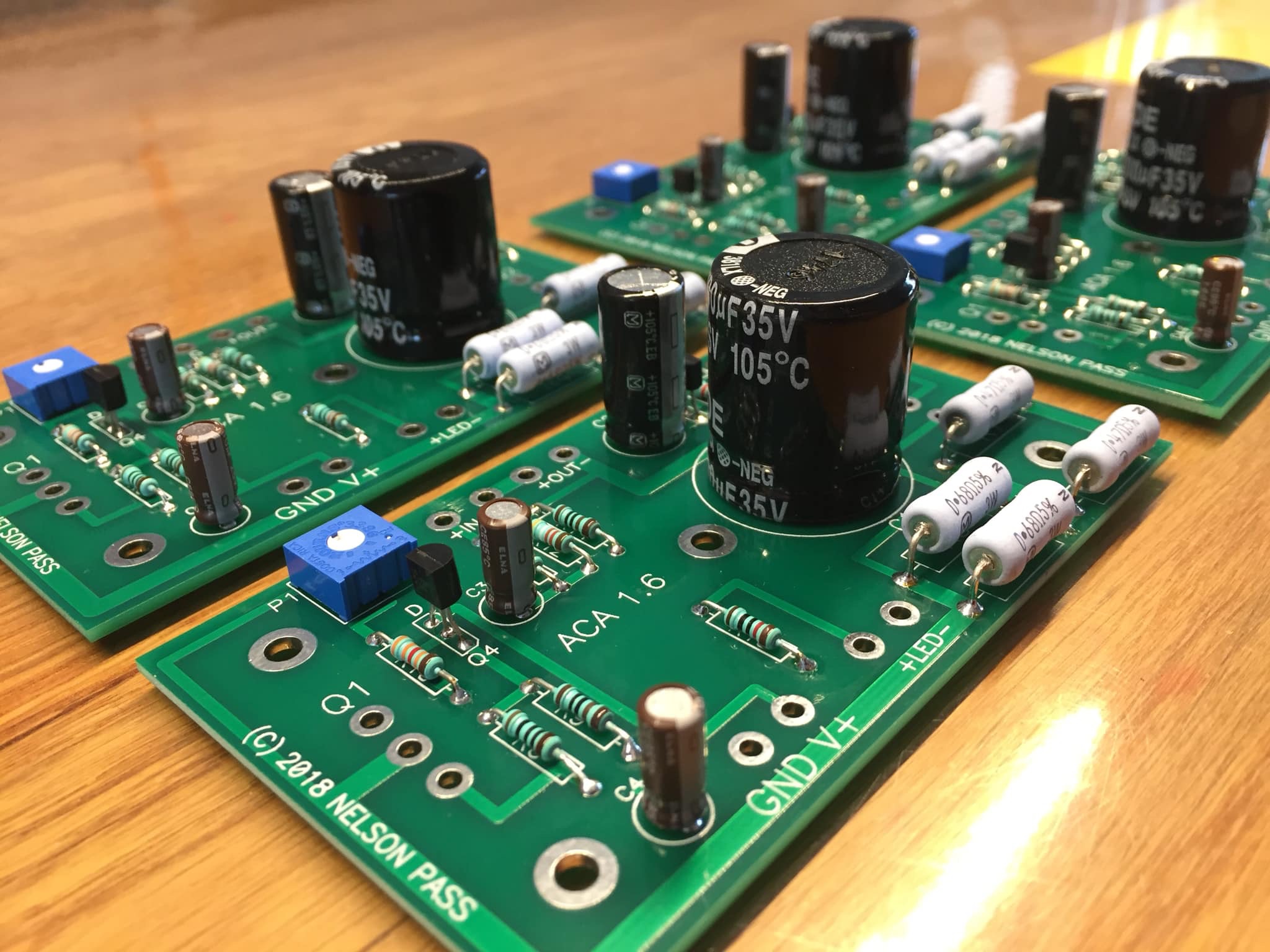

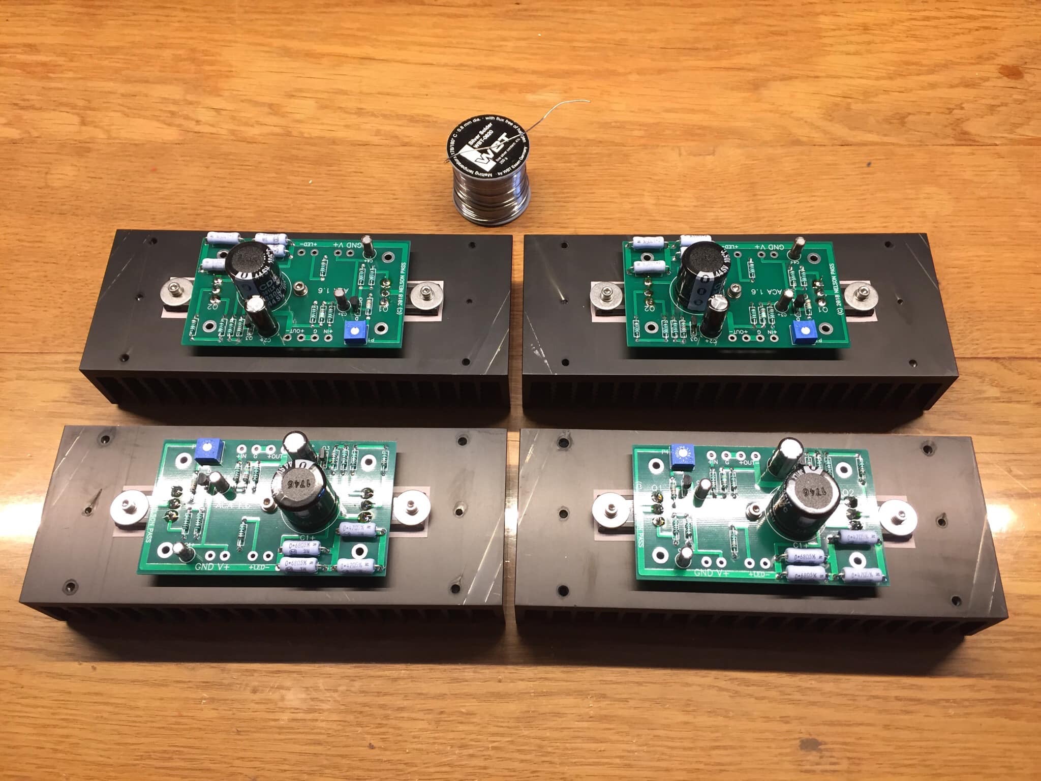

The SPMS has a very good, broad spectrum/frequency capacitor decoupling combination at its output. I would expect that such rail decoupling would not need any further attention... By the way, its negative DC output is connected to the mains IEC ground pin.
With silver (which I use extensively as well), just a word of caution - silver will emphasize high-frequency spectrum, unless you use a lot of parallel runs for each conductor (3 runs for each conductor would be ok). You could try a parallel run of silver and copper, for each conductor... or, silver, copper, and gold-plated-copper.
Silver ribbons are fantastic - they will give an open, very fast sound with a lot of high-frequency extension.
Copper - perfect for mids
Gold plated copper - good for bass frequencies.
Having in mind that a 2 gain pure class A amplifier is fast & revealing by definition, you would definitely want to include some copper there, or gold-plated copper.
Just my 2 cents.

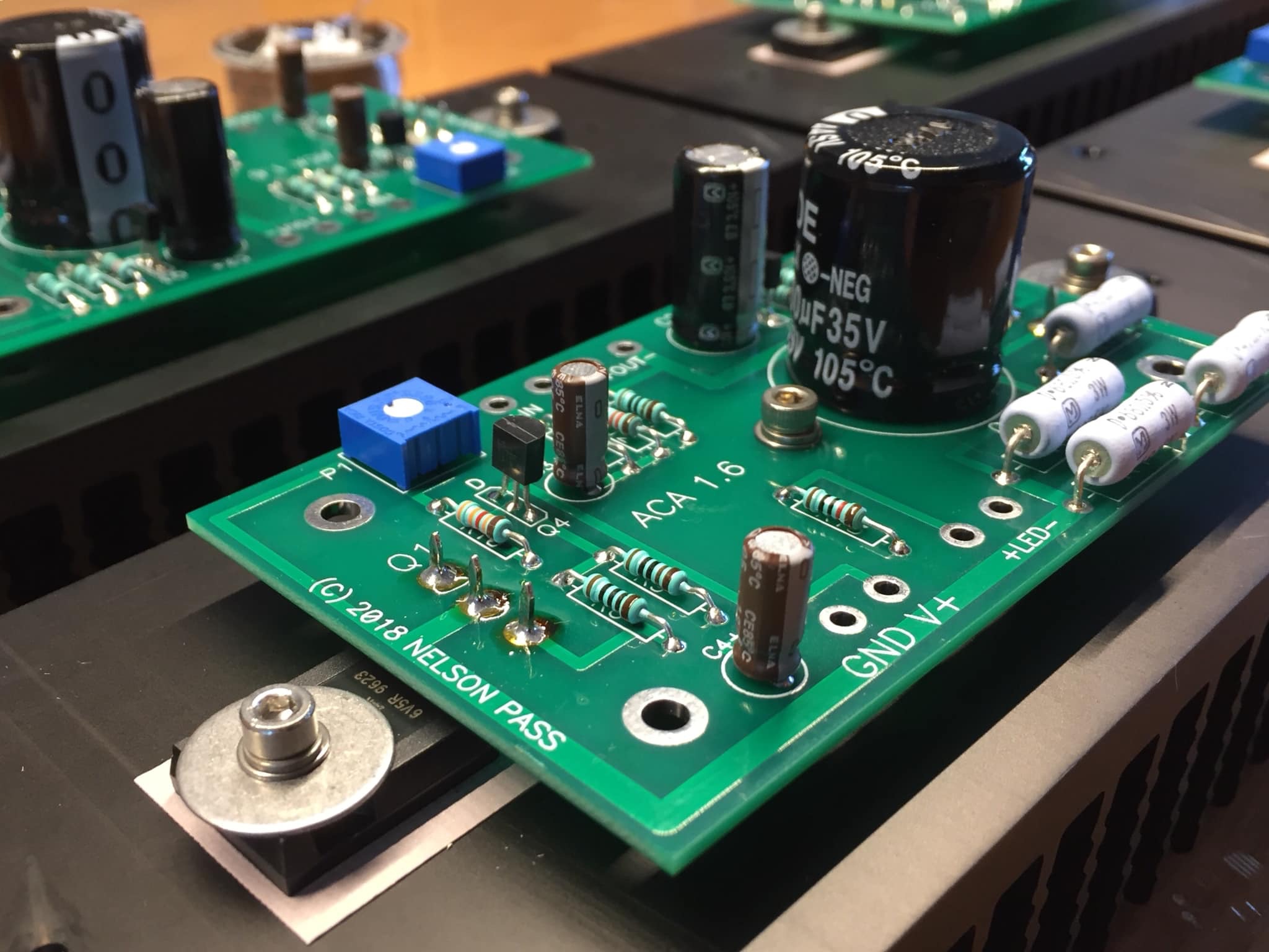

Hi guys. Just a quick question. I’ve got nylon standoff’s to connect the pcb to the heat sink. I’m I in trouble? Does the stand-off need to be brass for earth connection?
I am pretty sure that the chassis will be floating, with a nylon standoff...
To elaborate a bit: the SMPS has a direct DC connection between the mains earth pin, and the DC supply negative conductor (I confirmed it). The PCB has two large eyelets that allow DC negative connection to the heatsink; one of which is the large middle eyelet. So, if you use a nylon standoff, there will be no connection between mains earth pin (DC negative wire), and chassis.
