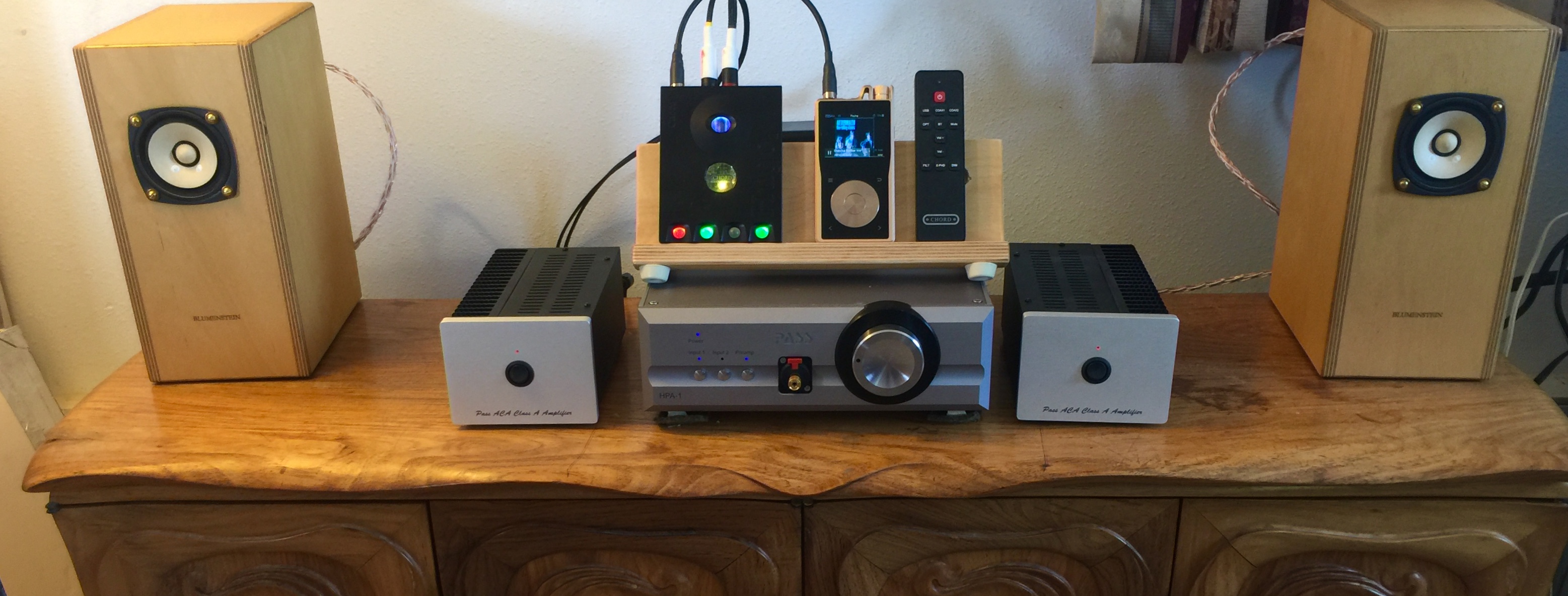

Old ACA in service... Happy
Clark Blumenstien Orca Speakers
Old ACA's
Pass Labs HP1 preamp/ Headphone Amp
Hugo2 DAC
Questyle QP2r player
Good sound?
Yes Sir.

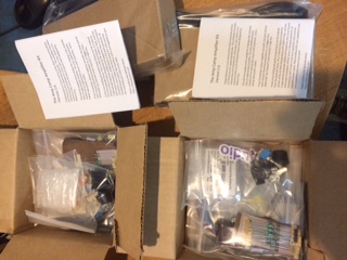

ACA Parts kit is here!
USPS just dropped off my ACA Parts Kit :) Unfortunately, I have to work the next three days, but have Tuesday and Wednesday off.
Can't wait to build this and settle in for some listening...:wave2:
Everybody, please post pics once your's is built. I'm sure we'd all like to see the builds!
I talked to Jim (6L6) and he is frantically working on a new build guide. THANKS Jim for all your hard work!!!

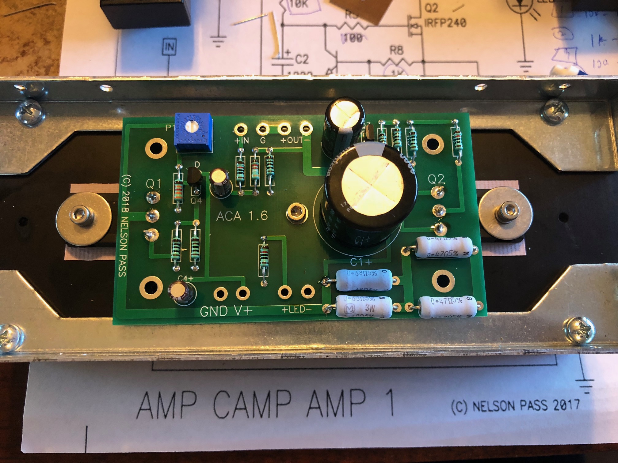

I got the kit and am having fun so far.
In case there are any other noobs out there like me, it was confusing trying to figure out all the resistor values because they aren't marked, which is probably completely normal.
I used this to figure out the values and match them up to the schematic -
Digi-Key 5 Band Resistor Value Calculator
One channel down and three more to go.
